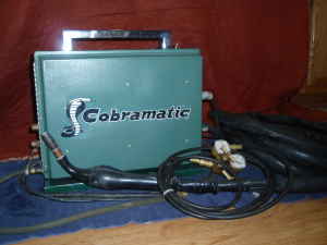

Yup, I'm kind of old school, I have a Cobramatic.
   / Voltage sense feeder? And SCORE!
#15
Well of course you do! Doesn't everyone? :) I wasn't explaining it for you, as I figured you knew all that, but for the others reading that wouldn't know what a push-pull gun was. If the posting you saw was for a P-P, then that would explain some of the high asking price.
