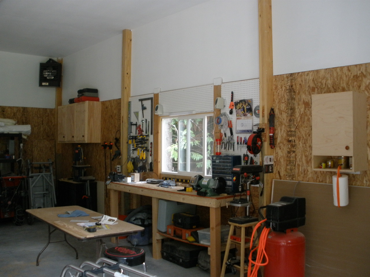

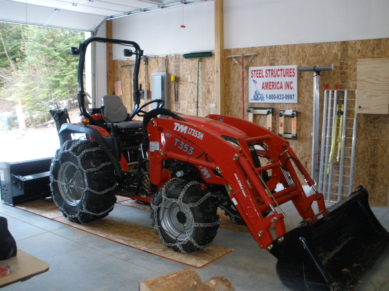

From my experience the OSB should work fine. I put it on the lower 8 feet of my walls and use deck screws at a slight angle to hang my tools. I also know where the girts are behind the OSB for heavy items. In the picture with the tractor just to the left of the electric panel I have a pick hanging near the top edge of the OSB. The OSB I cut to protect the floors from the tractor chains is 6 years old now and I can get another year out of them. The get pretty wet when the snow melts off the tractor in the winter.

NICE lookin shop Joey!!!
BUT.. tell us about that paper towel holder.. I've never seen anything like it.. Thanks.
View attachment 551104 View attachment 551106
Sweet..:D
That's the ticket!
Exactly what I had in mind....you seem to live on the edge though huh.....that paper holder maybe close to overloading the wall so careful it don't fall on your foot... :laughing:
