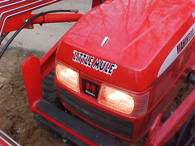

I decided to name it because It works like a mule but not nearly as stubborn. The lettering came from Speedysigns.com. Now I have also plowed snow with it and it works fantastic. /forums/images/graemlins/smile.gif hockeymaine is going to have a blast. I look foward to next spring as I have many projects to do..
