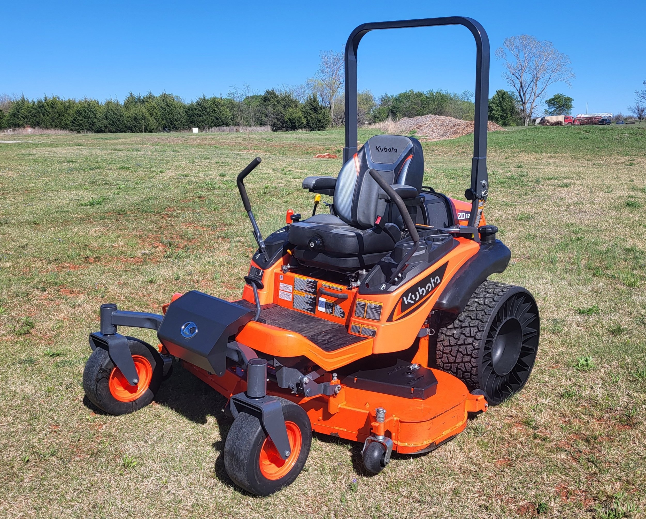

Starting a new thread for my new mower, a 2021 Kubota ZD1211 60" side discharge mower.
It had 95 hours when I bought it.
I'll share my experience here amd contrast to other machines I have or have used.
My only modification I have planned so far is to add seat isolators. The ones I bought are found on Exmark mowers (and maybe others I'm not familiar with).
I mowed/scalped the front yard tonight. I'm so glad I went with the diesel, it purrs and is not too obnoxious at all. The foot operated hydraulic deck lift is very nice. I'll have to get my auto-steer calibrated properly, I was leaving skips, the machine is as wide as the deck so your sight picture is totally different, will take some getting used to.
The first pic is when I got it home... the ones with the sunset in the background are from earlier tonight.

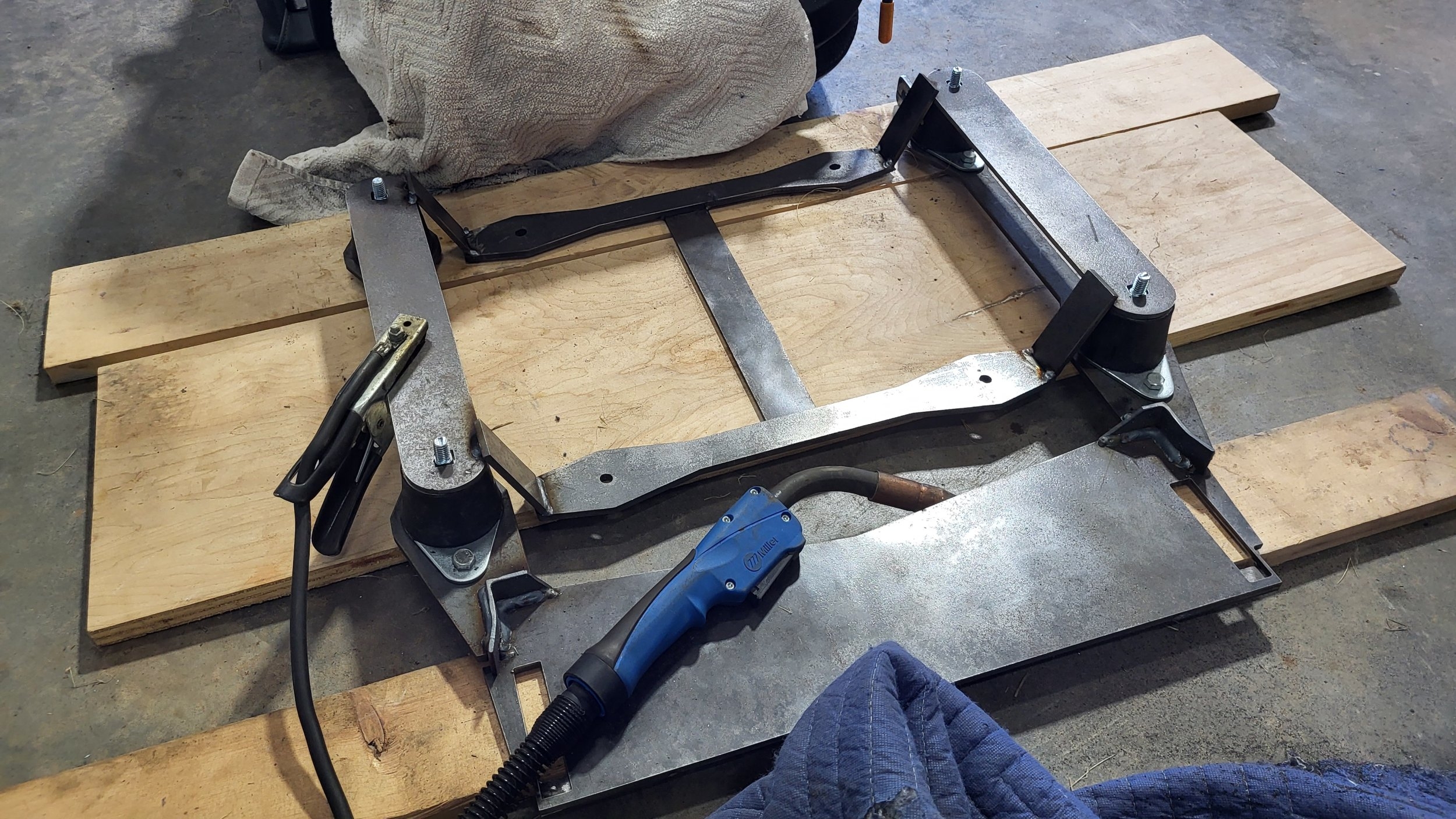

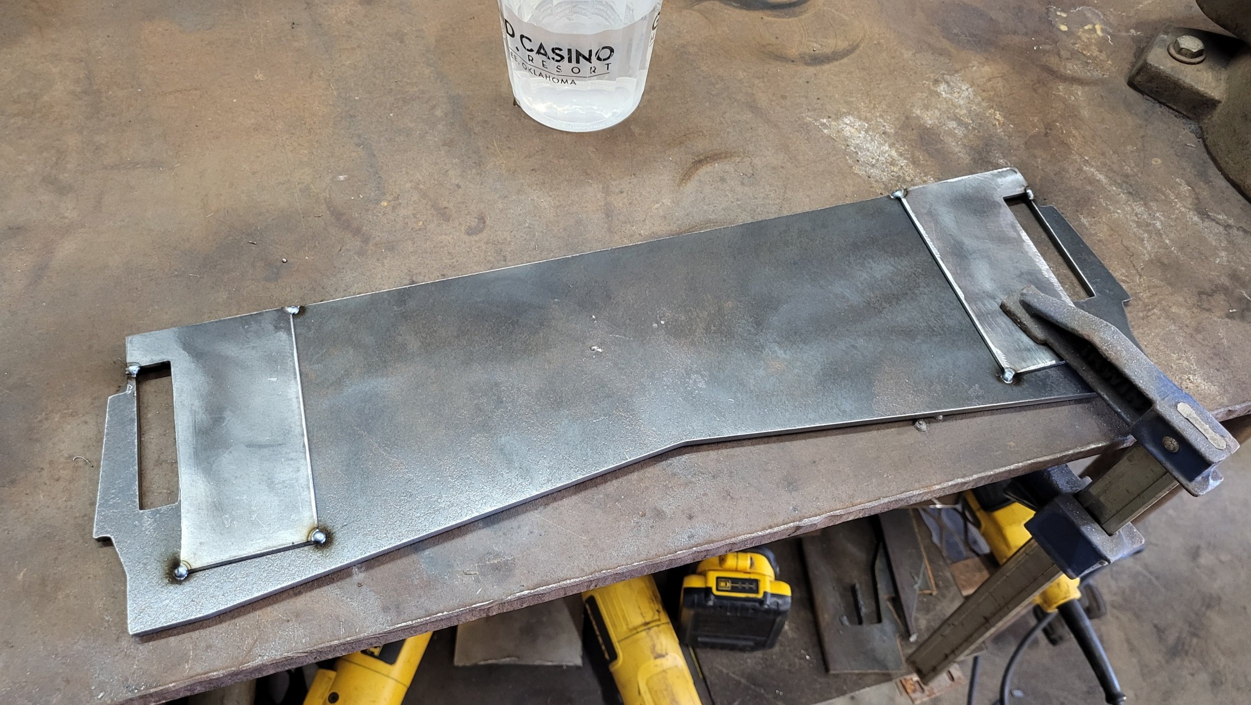

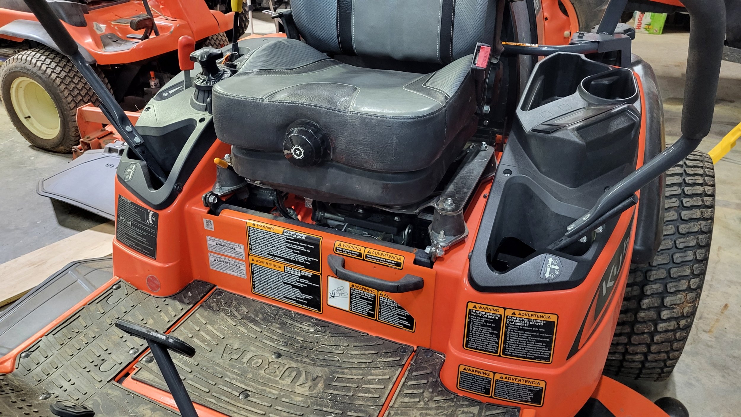

I finished the 3d model and cut out the parts on my CNC plasma this morning... this is for the seat base. May be a day or two before I get back in the shop to weld it up, paint, and install.

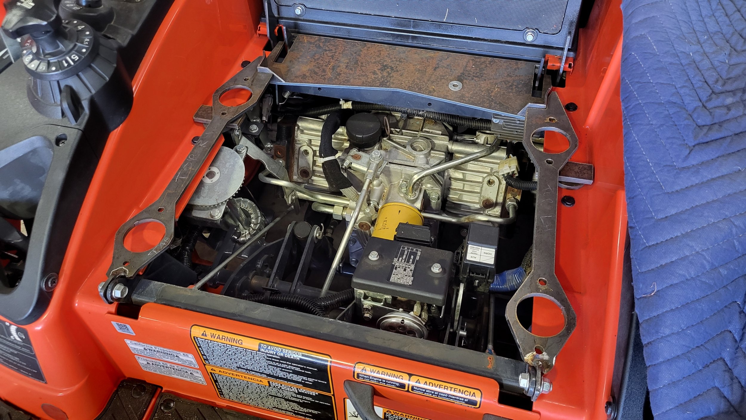

It's on. Huge pain in the rear. Still have to weld mounts for the bracket that keeps sit from falling forward when lifted.
I'll make a video of it in action, hopefully today.
I'm going to get wcwrything mowed that needs it then pull it apart and paint.

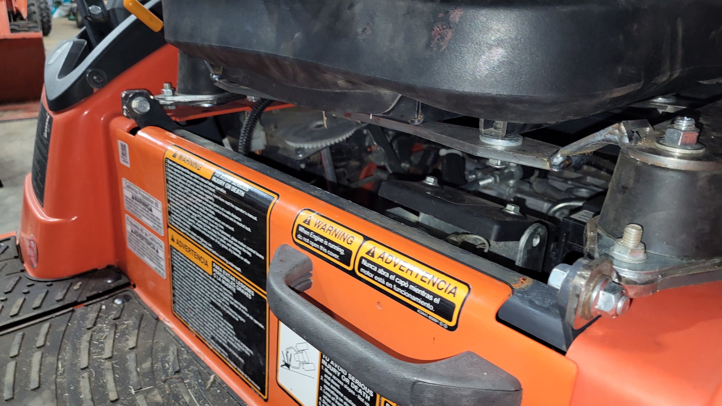

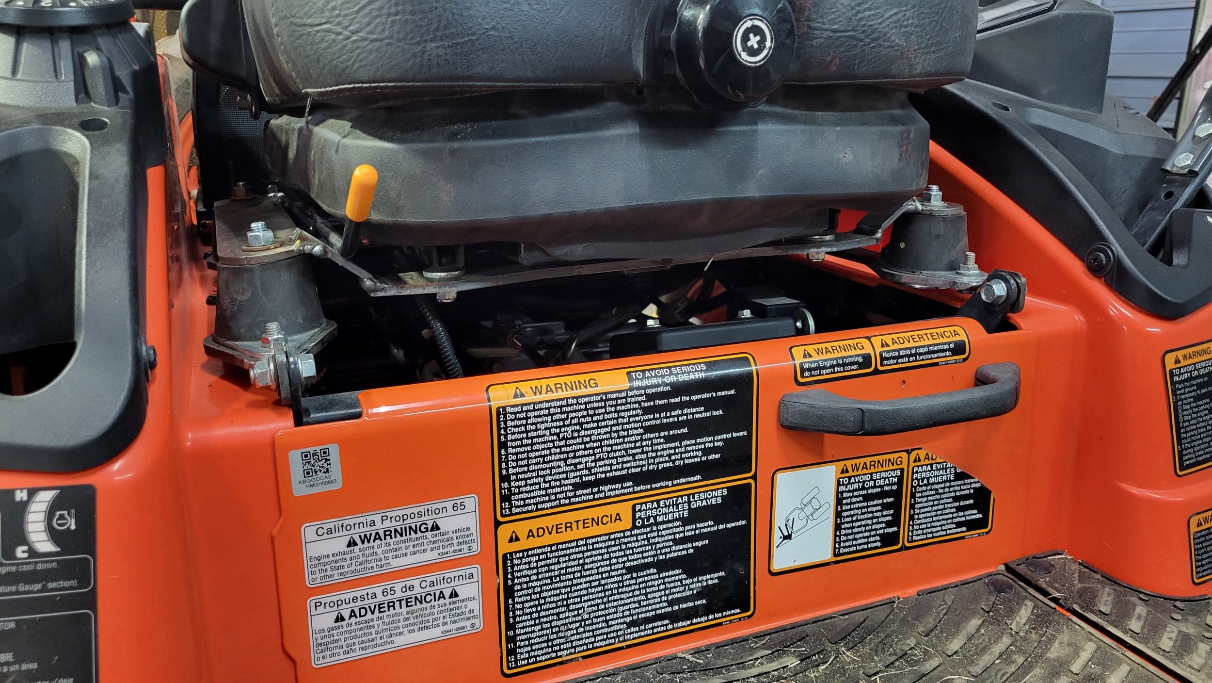

I welded up the seat suspension and it works great. I'm going to mow with it a few times just to make sure everything is good, then pull it apart, add in a plate so it hides things under the seat (like the factory mount), and paint it.

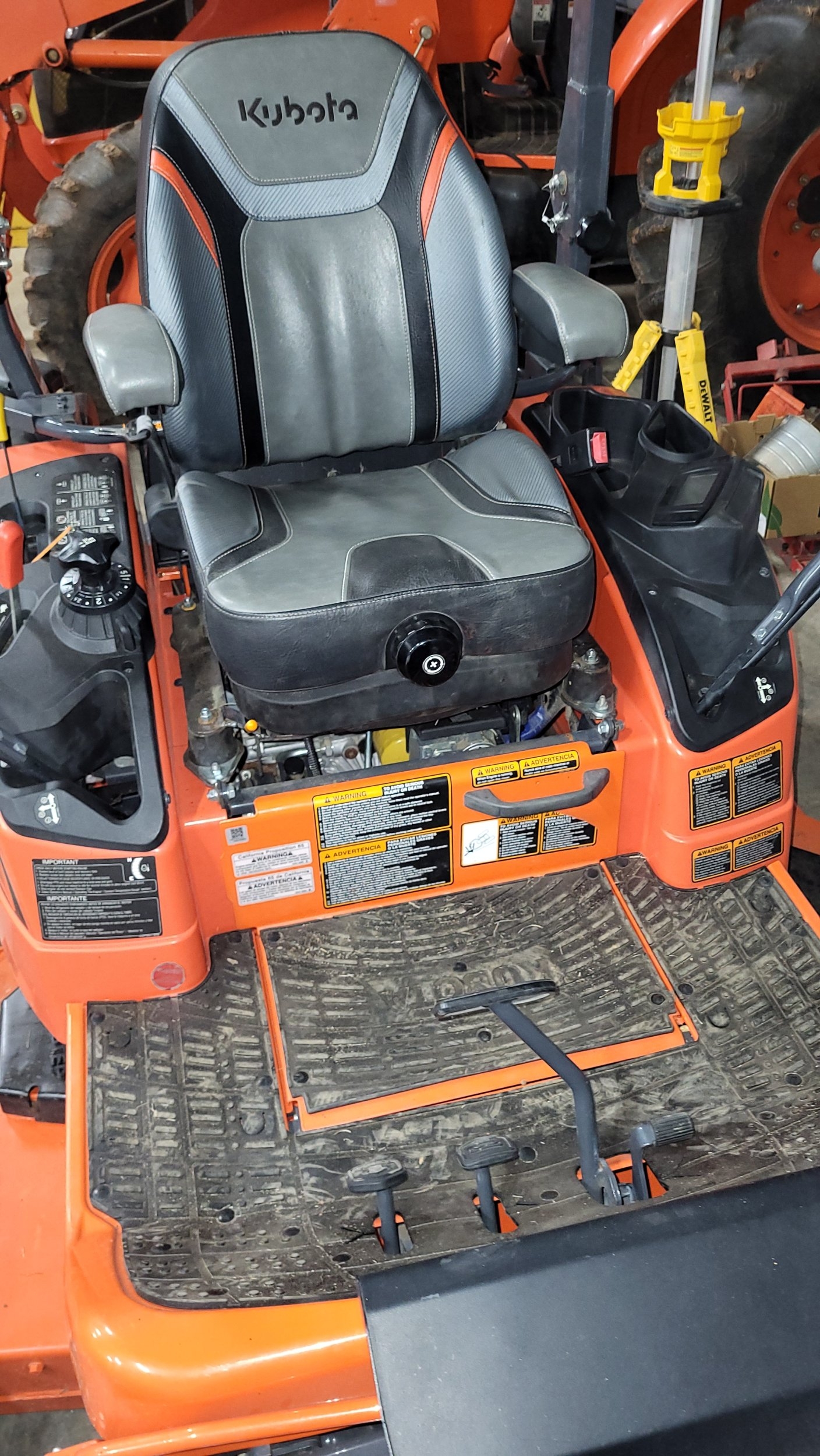

Assembled and functioning.

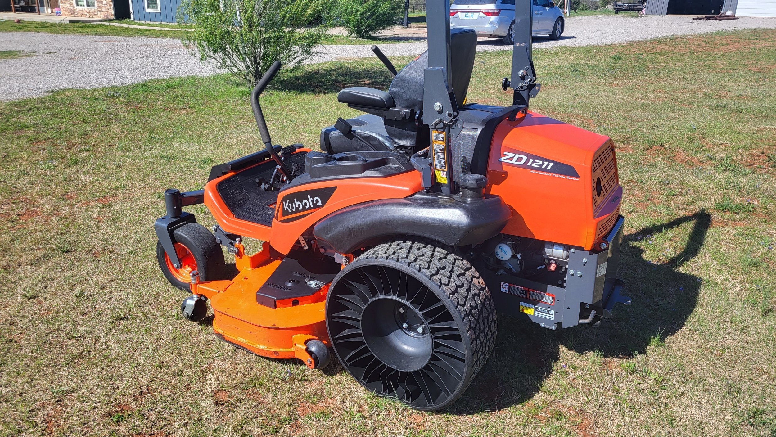

I'll be using this on trails surrounded by Bois D'Arc trees with huge thorns, so Tweels were in order. The BX done okay with the thorns once the front tires were tubed, but every now and then a thorn would still take out a BX front tire. I believe the ZD rear tires are thinner.
These tweels have less than 2 full seasons of use. I cleaned them up and also washed the mower before a photo shoot. Who knows when it will get washed again...
