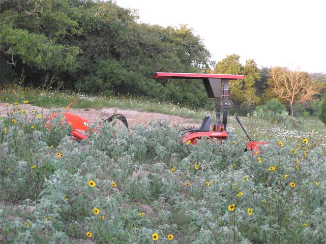

Am I in over my head?
I have started to dig a 48X32 basement on the side of my hill.
Has anyone dug their own basement.
Red Clay is under the first four feet of sugar sand.

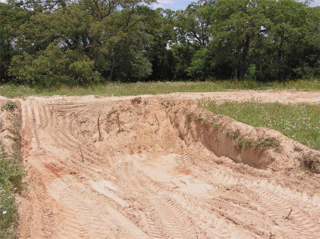

This 12' wide 4' deep strip took about 3.5 hours and was about 60-70 FEL scoops of sand. The clay I figure will take twice as long. I figure the total project will take about 75 hours. If I run into trouble (rock hard clay)I can always call a dozer out but now it is kind of relaxing and fun. I have about 6 months to play around.
I moved the sand to level the garage and workshop site about 40 yards away.

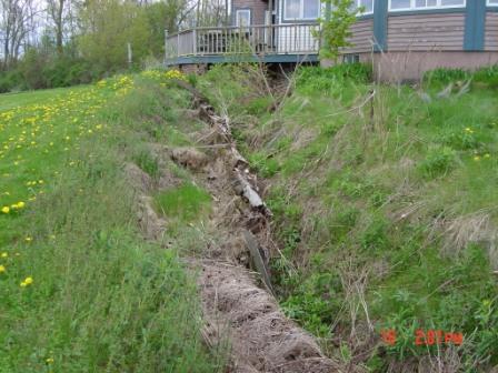

Looks like a fun project - here's a walkout basement that's in the not so fun stage. The owner used landcape timbers to as a retaining wall, less than 10 years later it collapsed.
3 pics...
-Norm

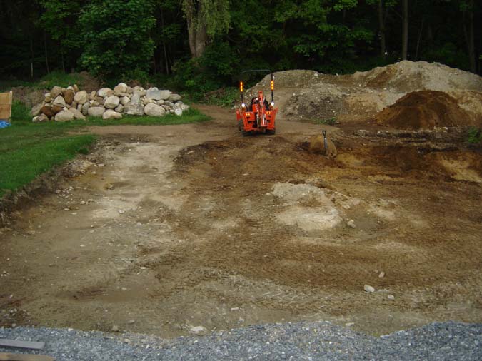

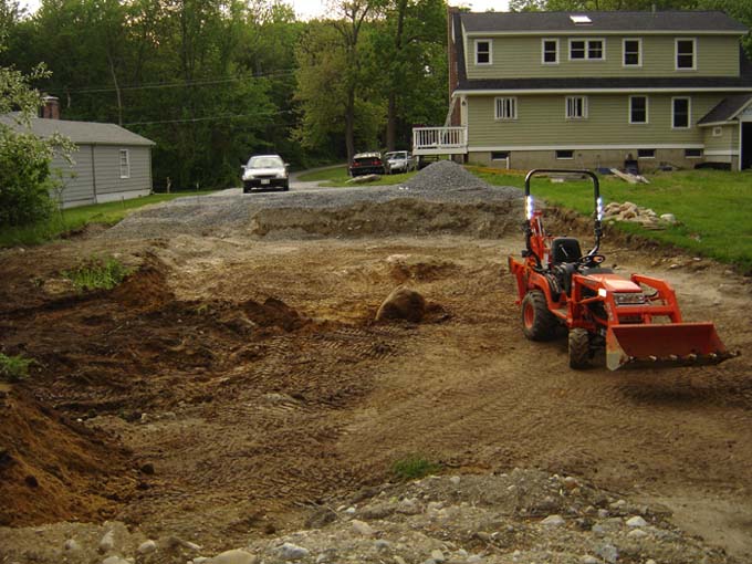

Or lucky that you don't live up here in rock country. I've been my BX to excavate the hole for my new garage and I have been lucky so far - I have only hit one rock that I could not get out and it can be left in place. The rest were movable - but some just barely - by the BX. The rest is hard digging. Most of the time I have to break up the soil with the backhoe then scoop it out with the FEL - with a toothbar on the bucket.

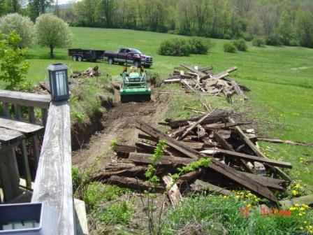

partially excavated...I spent 3 days just digging, a HUGE pita was that as the timbers rotted all the 10 inch long spikes fell out and became mixed in with the dirt. I had to sift thru every inch of this with a hand rake to avoid getting spikes in the tires.

Notice how the pile of rocks is pretty big compared to how big the pile of excavated dirt is.....

Almost done - I then had to load all the timbers into my dump trailer and haul them off to the transfer station. 2 loaded trips in a 7x14 dump stacked 4 feet high.
-Norm
