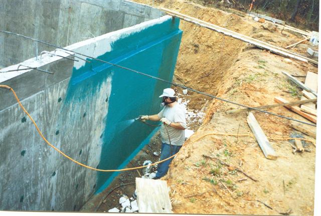

I recently finished building my daylight basement house and some of the things I did to keep the basement dry was after the footings and walls are poured I took hydrolic cement and sealed the outside joint between the footing and wall as this is the most common water intrusion. I also filled all rock pockets. Then I had the footing and wall sprayed with high pressure hot boiling rubber compound called greywall. It's like a continuous giant rubberband glued to the basement that does not dryup or crack like the tar method. Then I took 9' tall Delta drain and wrapped the foundation which adds another defence against water and also adds protection to the rubber wall against sharp rocks when backfilling. Installed footing drains as well as mid level foundation drain for surface water control. Wish I would have purchased my little Kubota when I started this vs. at the end /forums/images/graemlins/blush.gif

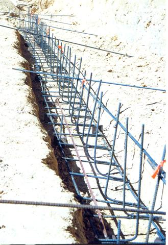

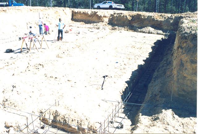

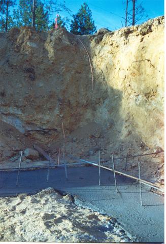

OK Don, here are the photos. This is a wide shot of the footing

/ Walkout Basement #24
pouring the footing

close up of footing and ground wire

/ Walkout Basement #30

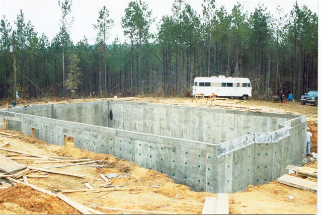

Sealing the walls with a product called Rubber-Wall.
/ Walkout Basement #31
Walls sealed

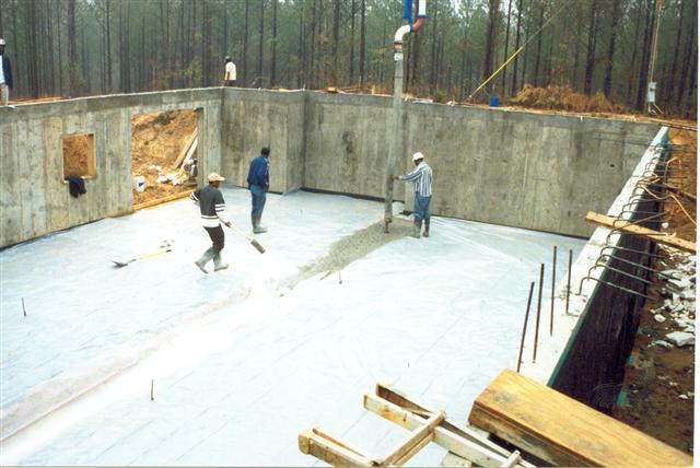

/ Walkout Basement #33
More floor prep.
Note: Before the footers and floor were poured the exterminator treated the soil for termites.

/ Walkout Basement #34
Pouring the floor

/ Walkout Basement #35
Still pouring the floor

/ Walkout Basement #36
Last floor pouring shot
