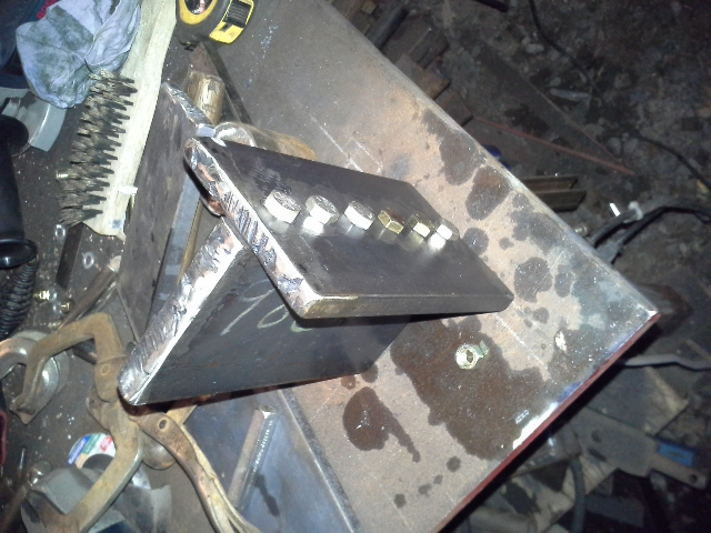

Had some dinner and came back to the garage to scratch my head a bit more. Changed the orientation of the 3/4 x 4 piece which will now allow me to get 7 3/8" bolts in and make building it both easier and stronger. A belly full of pork chops can be a good thing apparently.
From some info in mikefromnh's splitter build thread, these 7 bolts should give me about 93,000 lbs of strength. That should be plenty. Could likely go with 6 bolts for about 80,000 and still not have to worry and save myself one hole to have to drill & tap
Although the simple math is correct, It does not completely describe the situation presented.
What "forces" will load all the bolts equally? In practice, the push block is going to want to tilt the blade fore to back (and side to side). That will put the loading at one end of the row or the other, depending.
Just a point of consideration, Could one count on a welded joint being much better? depends on how you were doing that day ;-)
I think you will be fine with your bolt up plan, and if not, The piece can be made over.

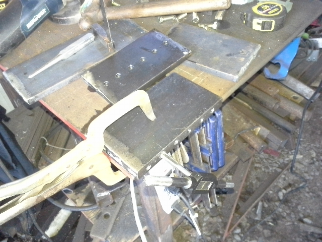

Made some progress today. Got the holes drilled and tapped to hold the bottom of the pusher to the center piece. Even though I had the piece clamped in the vice on the drill press they didn't end up in a perfectly straight line but still close enough to work. Used the first as template for the second to ensure that the holes lined up.
Tapping the blined holes was surprisingly easier than I'd expected. Perhaps another advantage of using fine thread.
