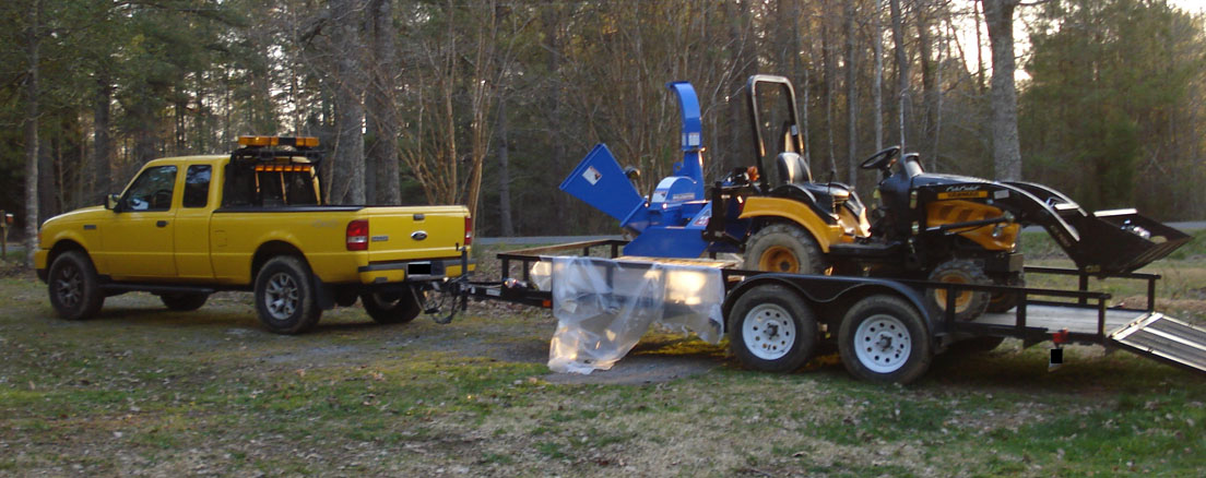

I just have one problem with it......it's bbbbbbbllllluuuuueeeee........:D
I might have to do some painting.

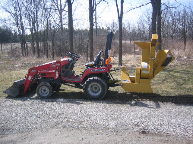

I feel your pain.:) Mine is yellow. Red would have taken an extra month for delivery.
