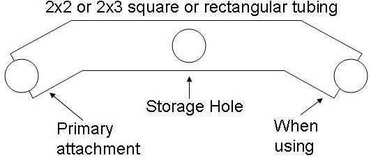

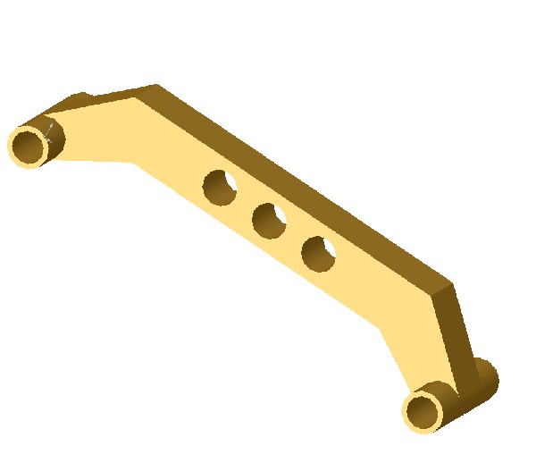

I was just out looking over the Wallenstein Thumb on my BH75 - it's certainly a very elegant design and compact. However, compactness is its major downfall as the designer didn't give much thought to the forces being applied to his design... In order to make it fold up so small, they needed to curve the black top-link (making it far weaker than it might otherwise be when compared to the Bro-Tek unit).
Therefore, if one wishes to maintain the compact design, then the sketch I provided should work reasonably well (it doesn't solve the design flaw, but it does add more steel where it's needed - see updated design). If, however, one wants all-out strength, then a straight top-link will provide much more strength (as stated by wkasak) - thus creating the hybrid to which Tom_H alludes. In this stronger hybrid, the weak part of the design will now be the serrated jaws themselves. Unfortunately, after closely examining the unit, the top link on this hybrid design would have to be physically removed if one wishes to fold the unit when not in use.
Honestly, I'm not sure what to expect when I put mine to the test, but building the new unit could be fun... :rolleyes:

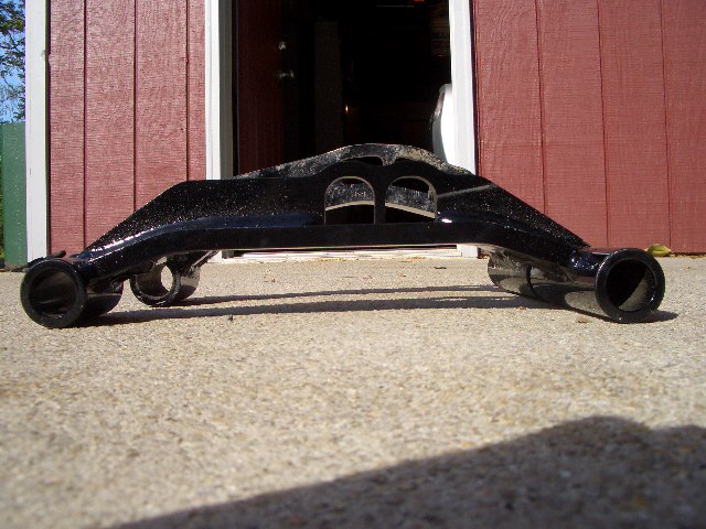

HomeBrew2 said:
Ditto, 3 seasons now.
This rock, I couldn't lift w/ the FEL !
Mine also doesn't care if I jam it into the ground while digging :)
Amazing what some scrap form stakes and 4 bolts can withstand when the grometry's right :D
Impressive, any idea on the weight?
KC
   / Wallenstein Thumb Review on BX #28
kcook said:
Impressive, any idea on the weight? KC
Well, not really. That was the second one I lifted that pulled the front wheels clean off the ground ... this one was bigger and took a heaping FEL full of dirt to balance. I guess the specs list the FEL capacity as 460# so I guess it was something north of that.

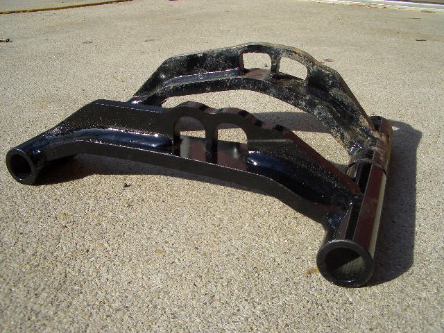

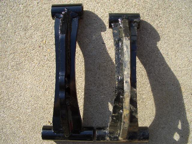

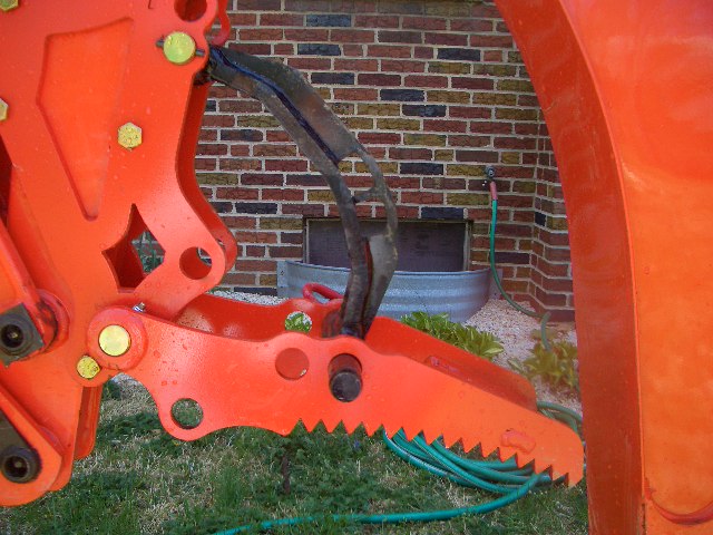

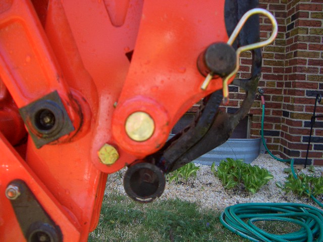

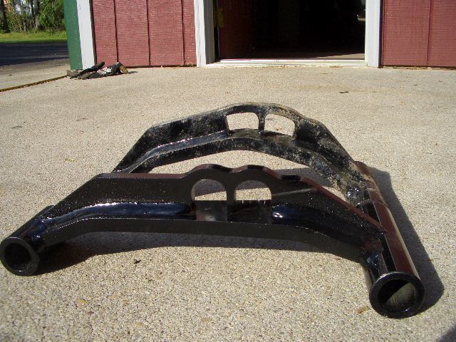

   / Wallenstein Thumb Review on BX #38

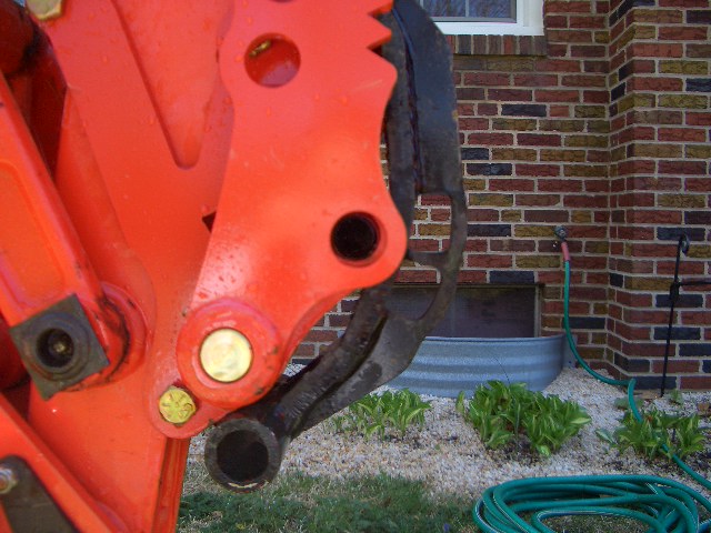

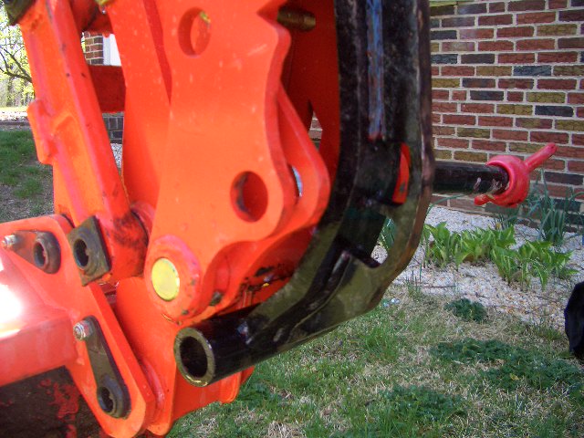

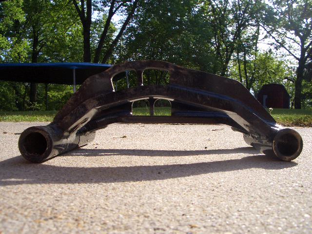

Just wanted to give everyone an update on my bent support brace. The ebay seller contacted the manufacturer and had a replacement sent to me. They requested the bent support back for analysis. Here are some pictures of the bent and new supports just so you can see where it failed and what to look for if it happens to you. I hope the new piece holds up better. Overall I am satisfied with the situation and resolution.

   / Wallenstein Thumb Review on BX #39
Pretty rugged looking piece to have bent like that. Clearly, though, it's definately bent.
