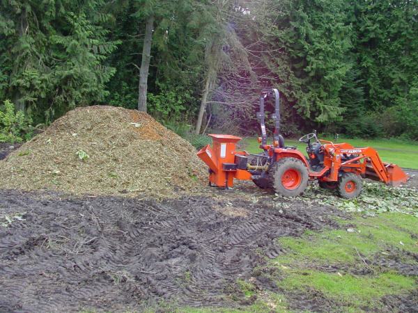

Here's a picture of one of the piles I did last year. I did 3 piles about that size before I had to sharpen my blades. A lot of the stuff I was chipping and shredding was covered with mud. I was amazed at how long the blades stayed sharp with that kind of abuse. I guess that's why they're so expensive. I also like the fact that the chips are very small, so they compost quickly. Most of the commercial chippers I have seen create large shredded chips. This chipper makes very small chips. I'll attach a photo of the chips as well.

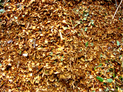

Here is a picture of the chips. To get a perspective, the largest chip is about 3/8" to 1/2" wide. This stuff composts quickly and makes great mulch.

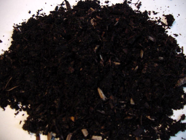

This is really sick, but I guess TBN does this to ya..... I just walked out in the dark, at great risk of stepping in a Golden Retriever land mine, in 31 degree weather with a 20 MPH wind to scoop a bit of composted mulch, to take a picture and post it, so that you can see what it looks like after about a year of composting..... I think I may need serious therapy. I just hope my wife didn't see me. Anyway.... here is a picture of some composted mulch from a Bearcat 70554.
