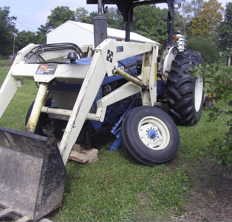

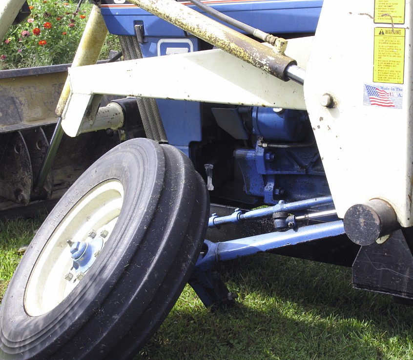

Ross
Hopefully you won't end up like this.
I was lucky as was just mowing a relatively flat area when it let go with no advanced warning. On a hill it could cause a rollover.
Is your land flat in New South Wales?

Ross
That brings back memories. When I built my first house I borrowed a friends John Deere 4640 or some such model, about a 65 or so horsepower tractor two wheel drive to finish up moving some dirt for landscaping and learned that tractors with front loaders are not bull dozers nevertheless I move a lot of dirt and picked up a few large slabs of rock to move out of the way and after a few days of this I returned his tractor which was used on a dairy. Drove down the highway for about 12 miles to and from and up a rough country lane road.
Put the tractor in the barn and felt like all was well. About two weeks later when my friend returned home from business trip (shades of Green Acres) he was eager to get in some seat time cleaning out some barn yards and driveways. He climbed on his tractor and just as he hit the starter the axle broke and looked just like that picture.
The tractor had a lot of hours on it but I did not do it any favors with what I used it for. My friend called the John Deere dealer and had them come out with a new 4wd model and never batted an eye my way. When I saw the break it was obviously a fatigue crack and all I had done is help it along a bit but basically it was just going to let go any day.
If it had broken while I was using it, it would have been my dime for sure, but he was wealthy and just helping me out so did not make too much of the fact that a I was the last to use it.
He later commented that that axle breaking was a god send because he did not know that it was not necessary to struggle with backing out a load. 4wd changed his world.
