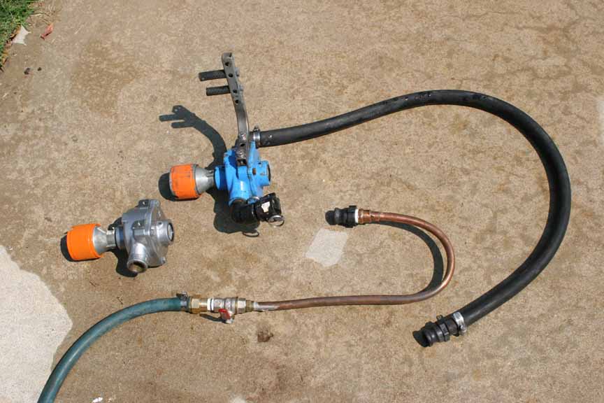

Here is a photo of the pump hookup with cleaning. A garden hose dropped in the sprayer tank fill opening would pop out and spray me with water - every time. Sometimes several times in a filling. The copper J hook fill nozzle hangs on the fill opening and works well. I measure my chemicals while it fills.
To flush the pump after use the male Banjo camlock fitting on the copper J fits into the female fitting on the pump, which is the inlet fitting. The garden hose is already connected to the faucet so it is very fast to power flush the pump. Fo my setup I have to remove the pump from the tractor.
Swapping the hoses around so the pump suction has the hose instead of the 90 would allow me to flush the pump while it is attached to the tractor and tractor PTO is running. Should have done that, and it will be changed.
Better:
Suction hose w/ Female fitting , Male fitting on the pump discharge.

   / Want a 3PH sprayer... #47
I didn't even know about camlock fittings until this thread. I bought a set last night and will put them on my pump this weekend. The removal of the hoses from the pump for oiling and storage should be a breeze from now on. It's amazing the knowledge that can be gained from this site.
   / Want a 3PH sprayer... #48
Hey JRP,
I can't remember if it was you, originally, who suggested the idea -- but, I fashioned a "J-hook" (as you call it) from PVC w/ a couple of elbows and a female GH fitting. I agree -- super idea!
Yup - I'm with ya on the power-flush. I did the Female on the suction side - that way, I can power-flush with the garden hose on the PTO (if I want). Actually, I get a pretty darned good flush just rotating rollers by hand...
