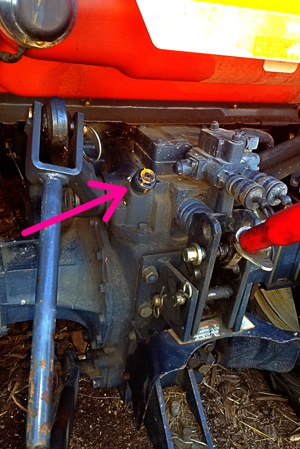

Hi Arley, The cap is a screw in vented plastic part on the top of the back of the transmission under the fuel tank.
I think leejohn thinks that there may be an additional vent. I have not looked for one.
I mentioned that the tractor was in a pond but only up to covering the rubber.

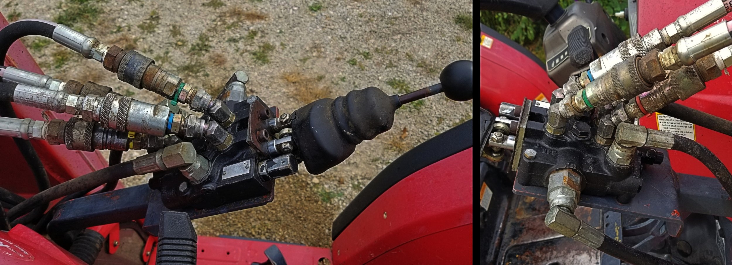

Initially I thought that I might be getting moisture on the controller as the rubber cover was flopping in the breeze The pistons would not move with the control arm when frozen. I have since made a printed cover to repair it. I didn't think that it had much moisture in it.

I agree and the cap is the only place I can image it could get in. terraformer, can you post pics of the cap?

The vent that I found in the transaxle was in the filler cap. It is fairly well buried but could imagine that water could get in if the vehicle was positioned in the wrong direction outside in the rain. The ventilated filler is to the left side and somewhat exposed.

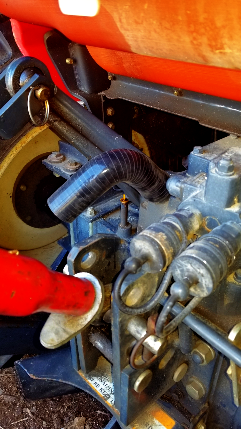

I found an elbow that fits pretty well Might keep the the vented cap out of the rain.

Last month I changed the transmission oil again. The pump is quieter and the bucket doesn't slip.
It must still have had too much water in it. Next spring will change it again.
