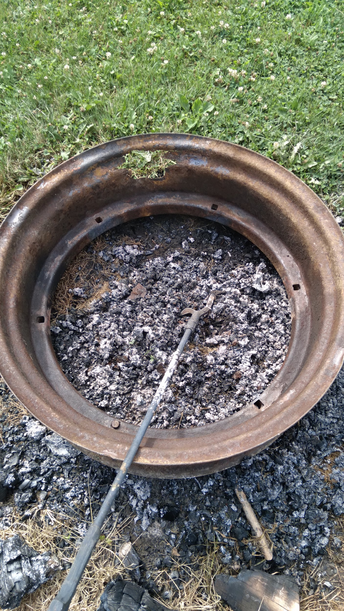

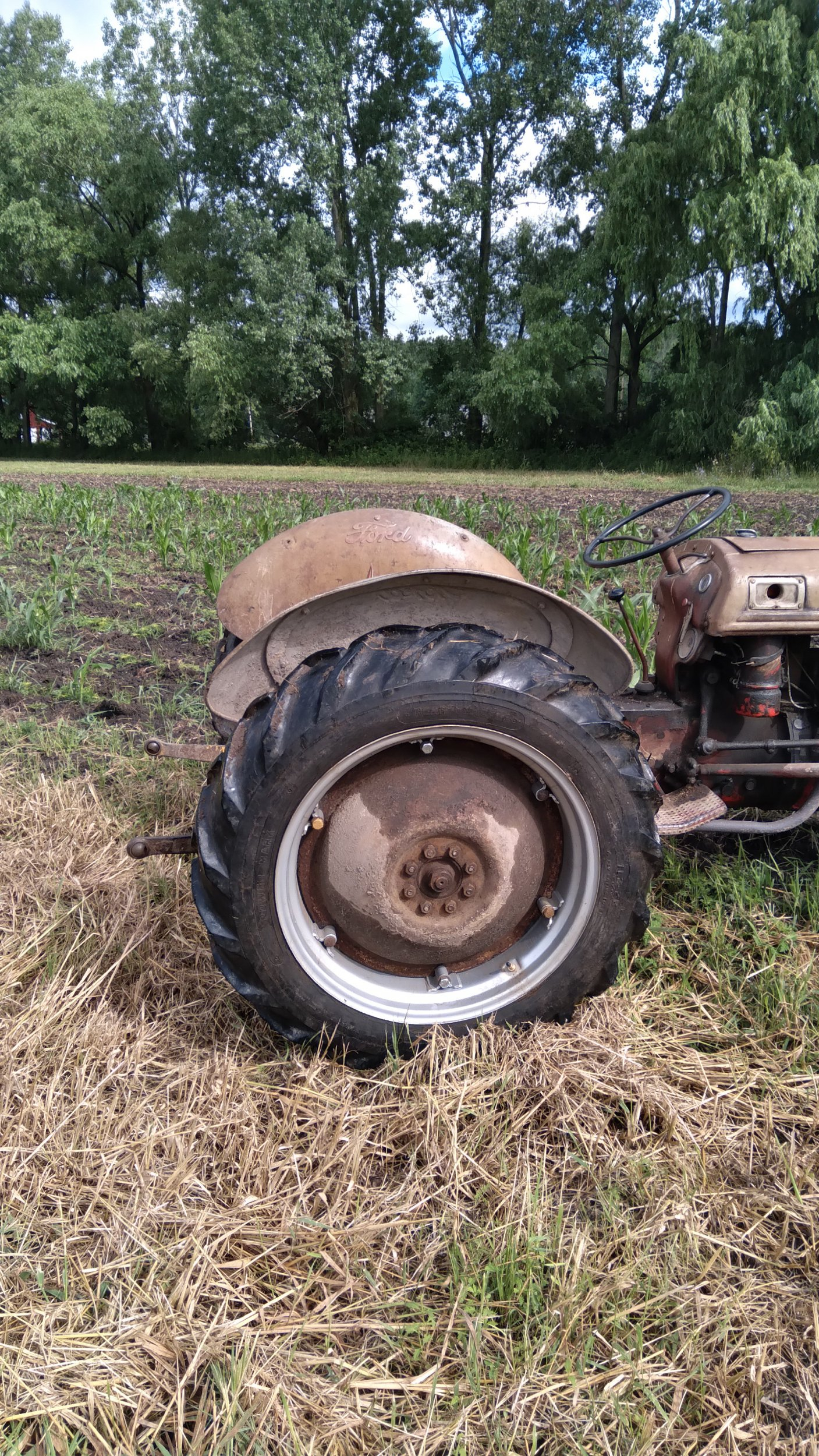

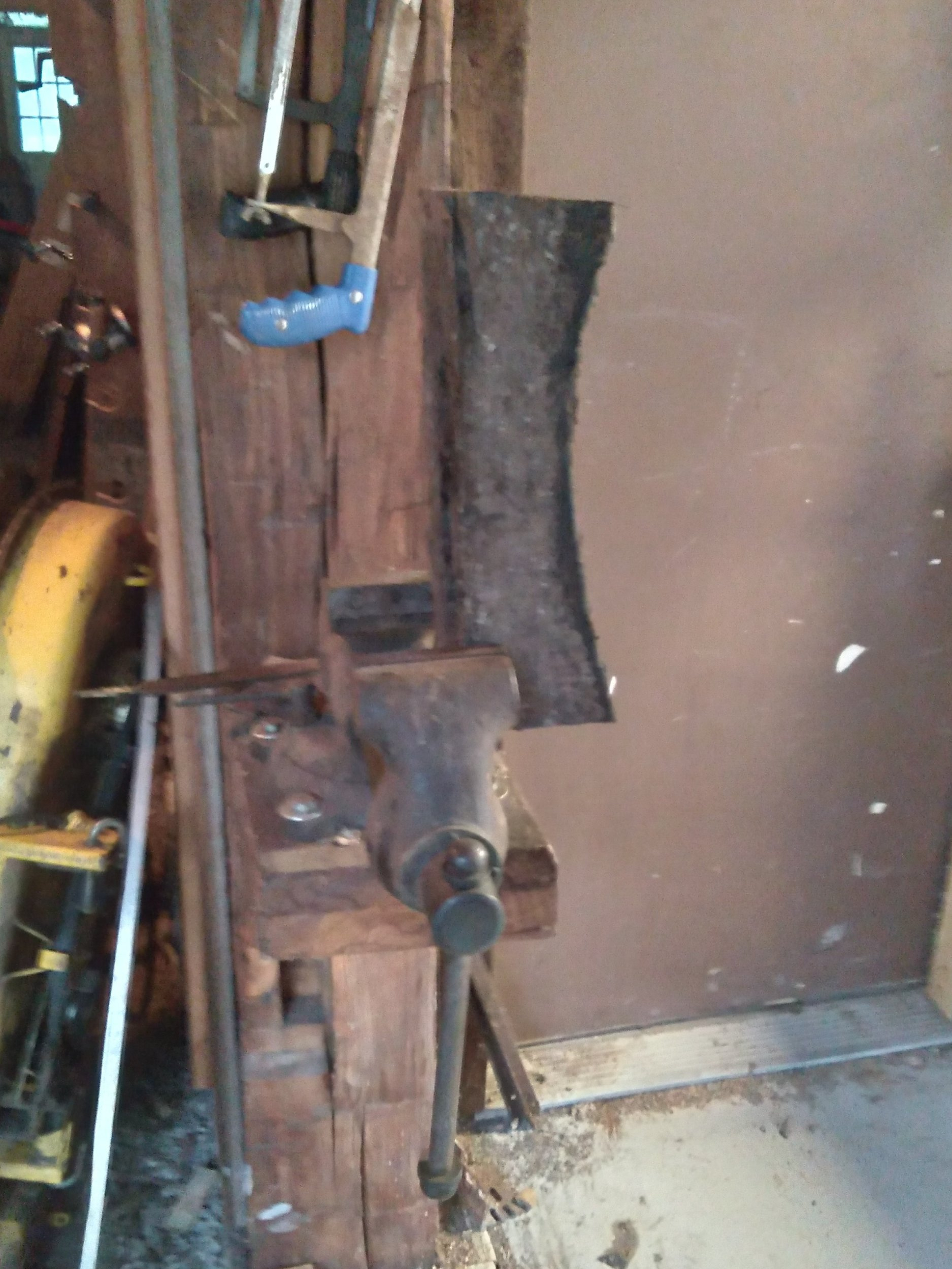

I just replaced a 70 year old calcium-rusted rim on my 8n. I was able to save the original 11.2 x 28 tire (only 2000 hours on tractor and always stored inside so the 1951 rubber was still in decent shape. I used a small floor jack, 10 ft 3/8" chain, a 2x10, and a couple wood blocks to gently break the bead.
I trimmed the radius on the larger block to match the rim with my chainsaw. The little Jack didnt have quite enough push to break the bead when I tried it with that block square.
I drained the calcium out onto a stone driveway, figuring that will keep the weeds down for a while. The other side dont look too bad, but I will probably drain and change that rim out next year. I have another new rim and tube ready to go.
   / want get rid of calcium in tires #58
I cant believe I was able to get thru my spring plowing with that tractor the last two years. I first noticed the approximately 6" diameter section of rusted out rim and exposed tube around the stem last year. I lowered the pressure to 10 psi and plowed about 5 acres with it this spring. The following morning, it had settled down flat.
It sat on blocks until I had a chance to change the rim last weekend. It really was not that hard of a job. I am looking forward to doing the other side but too much other stuff to do now so that will have to wait until next summer.
   / want get rid of calcium in tires #59
When we had our rims replaced recently on the 3600 Ford we did not refill the tires and everything is a working well traction wise for Bush Hogging even on the hills.
   / want get rid of calcium in tires #60
I didnt want to put the calcium back in because I want to use this tractor for dragging logs out of my woods and I will get less rutting without it. I am sure it wont work as well for plowing but I have another tractor I can use for that.
Also, the old 8n will be worth about $ 1000 more with two new, unloaded rims than it would be with two rusty loaded ones.
