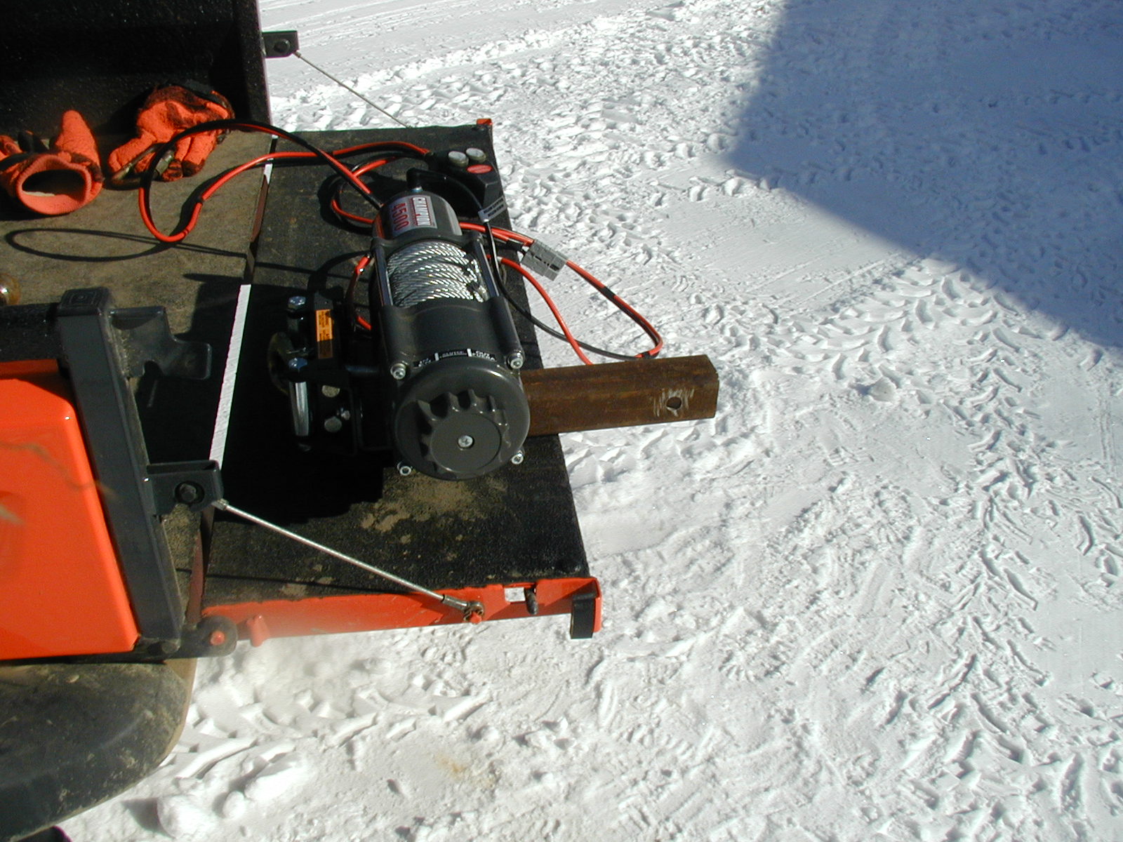

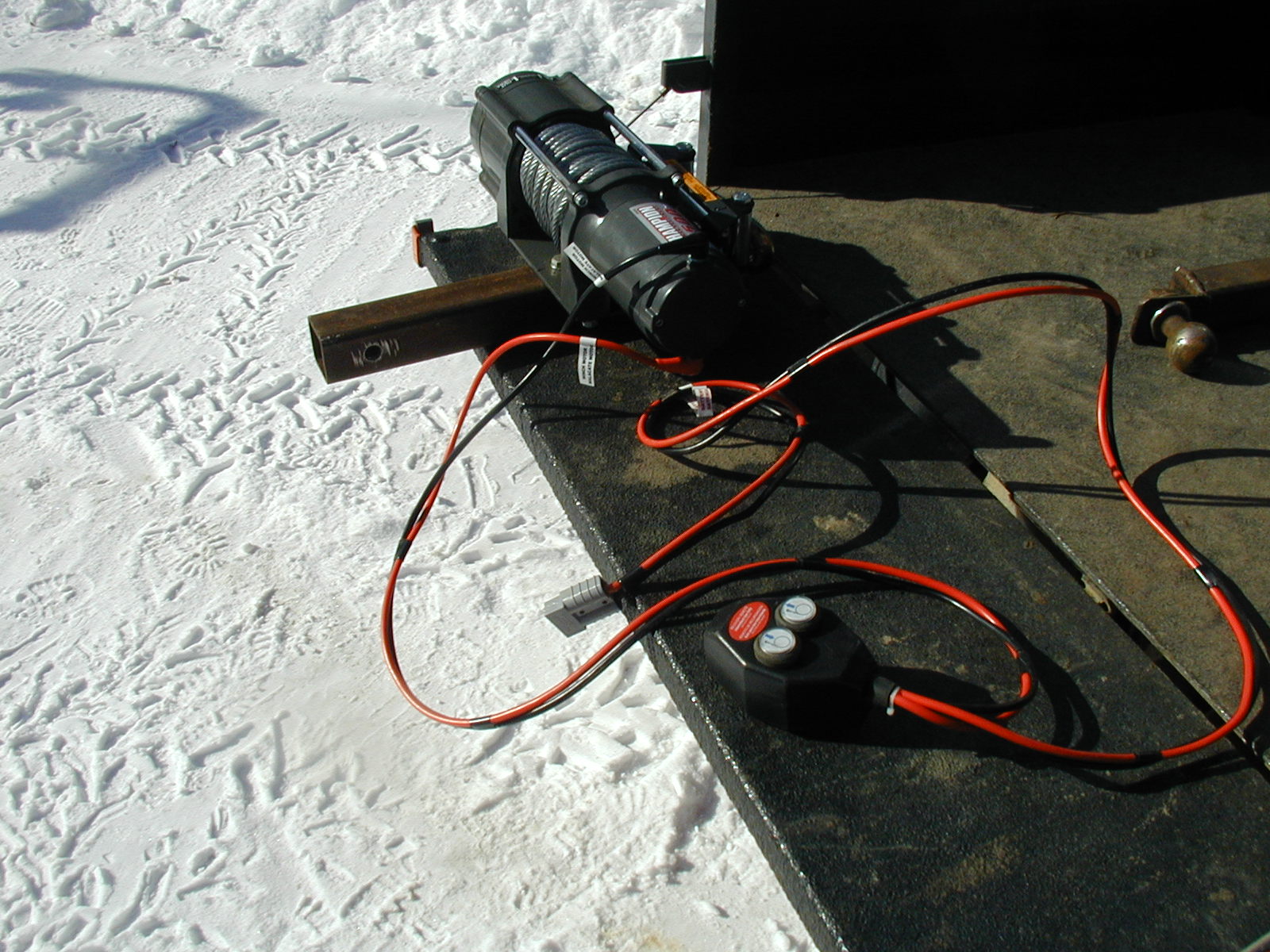

Try these!
Powerwerx: Online Shopping for Anderson Power Products including Powerpoles, Wire & Cable, Adapter Cables, Powerpole Power Splitters, West Mountain Radio RIGrunner & more
I have them on my RTV, Tractor and Plow Truck to connect my winch. I have my winch mounted on a receiver bar that I insert into the towing hitch on all three. The connector plugs into all three.
jw5875
wiring-electric-winch-plug-log-p1230004.jpg wiring-electric-winch-plug-log-p1230005.jpg wiring-electric-winch-plug-log-p1230003.jpg

   / Want/need winch for a Kubota RTV1140 at least 3000lb #9
I have a 4,000 Warn for my RTV1100.
Haven't had to use it, yet, but like the idea of front and rear mount.
Mine is just on the front.
Make it fit any way you can, but leave it out front as much as possible so you can get the cable back on the drum properly or it will jam up. Good access when re-winding on the cable helps keep things lined up.
I cut my 50' cable in half so 25' will not get jammed as easily. Plus 25' feet of pull is enough to warm up any winch and the break to re-rope gives it time to cool.
My rule of thumb is winch should pull twice the weight of vehicle. 2000lb vehicle requires 4000lb winch minimum.
