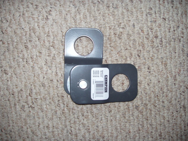

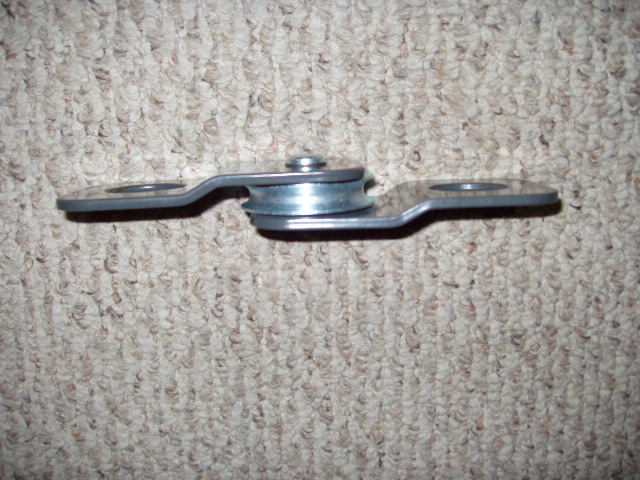

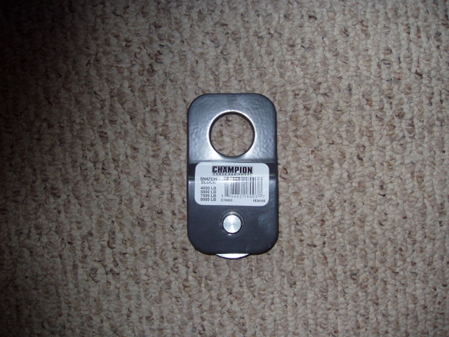

I've already had to use my Warn RT40 (4000lb) winch several times this year due to the late rains and muddy conditions. I don't have your brand of UTV so I won't comment on your request but I do want to advize you to buy a snatch block, this one was from either HF or TSC and several lengths of good rope and keep them stowed on board for use when you do get stuck. In most of my stuck situations there hasn't been a tree or similar object anywhere near directly in front of my Mule in which to lash up to so setting the rope and snatch block signifigantly straightens out the winch wire and allows for a far more even re-wind (90 degrees to the bumper is the most ideal) without constantly binding the wire on one side of the winch. Snatch blocks are a bit pricey but when your in a stuck situation, money just doesn't seem to matter-except in getting that pricey UTV out in one piece.;)
