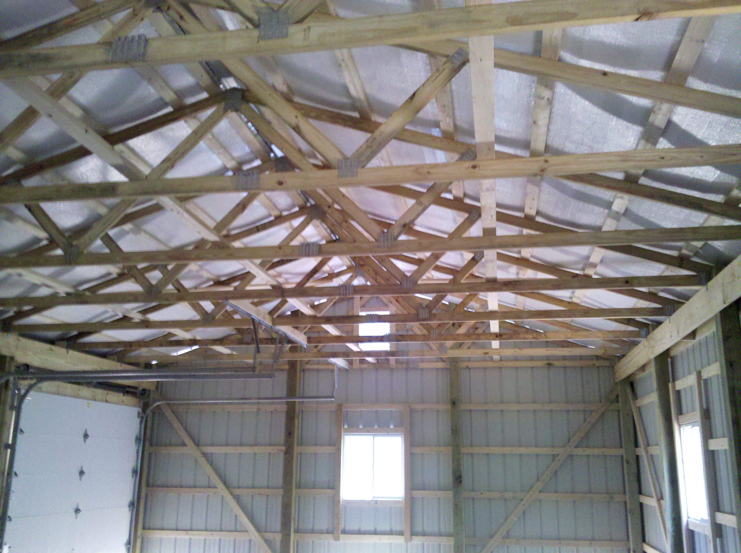

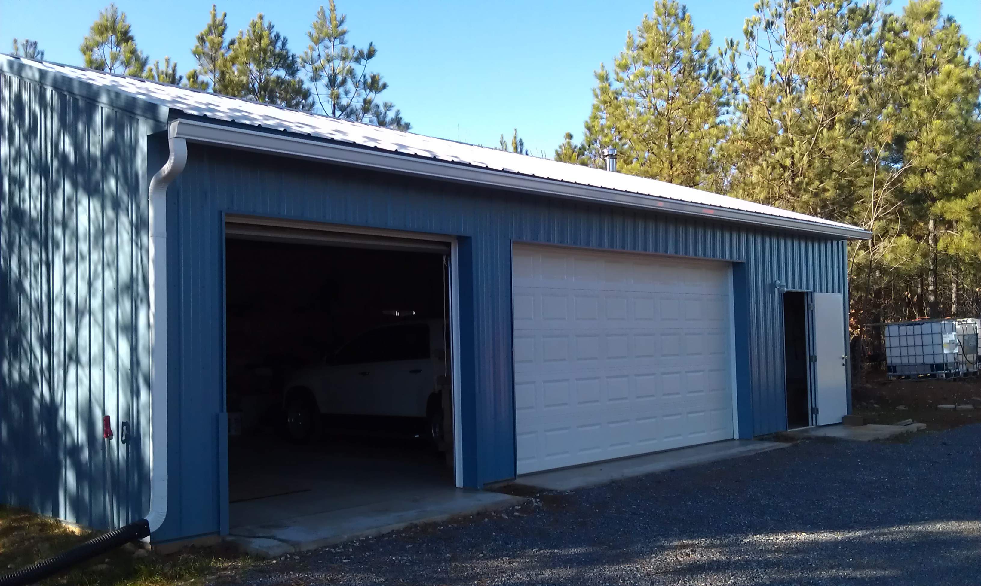

Me too....!!!! I have a 24X40 steel building, built 3 years ago. Now after concreting the floors and moving my Blazer and tractor in I want more room. Any suggestions in this direction? I have some leftover blue panels and a few white roof panels. If I opened the existing left side and left the existing 6X6 posts could I extend the roof beam, front and rear beams, add trusses and make it look like the orig building? Would it be smarter (less expensive) to LEAVE the building as is and attach an addition to it, TRYING to match/tie in.....maybe cut a connecting passageway from old to new. IDEAS, suggestions....:confused:.

Welcome Depending on budget and resources you might find used power poles a lot were replaced in my area with the storms this year, or use locust post.
   / Want to add on to my pole barn! #10
I would add poles front and rear with added front and rear beams and add trusses. Take the siding off and move to the new end and leave the existing wood from the end wall standing until it is complete. It will add support until the roof is all tied in and complete. Later if the wood is in your way just remove the lower ones so you can walk thru without hitting your head. Use the upper ones to hang light stuff on to get up off the floor.
