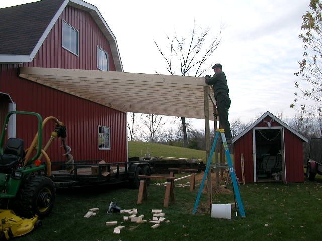

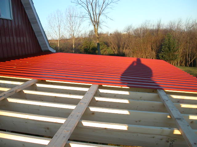

I'm not sure how you want to tie on to your existing building but I also have thought about it. I found these pics on another thread awhile back, I hope they give you some ideas. You might try searching the threads for "pole barn lean to" or something similar.
337371-lean-to%20rafters.JPG 337373-Lean-to%20framed.JPG 340260-Dscn1021.jpg
   / Want to add on to my pole barn!
#14
Im going to start soon! I really like the lean to that they are building in the pictures you posted! I think i may enclose the whole thing! We will decide as we go!

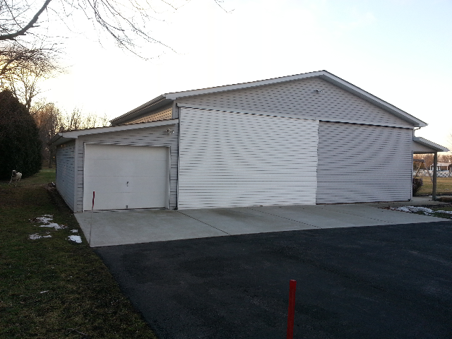

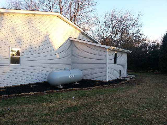

I have done this twice. My barn started its life as a 40x30' with 12' ceilings. Should have went 14' to start with but thats another story.
The first extension was done the year after I finished. I added on a 12' extension down the whole 30' side. Its 12' tall on the barn side and 8' tall on the outside. I had gravel but hated it and poured concrete 5 years later. $2000 total cost.
Last year I blew out the back of the barn. I did 20' of the original 30x40' barn. I went 12' again so now its 42' deep in that part. I did gravel again but within 3 months hated the dust and poured concrete. Total again was about $2000.
Chris

Here is the first extension.
Chris
