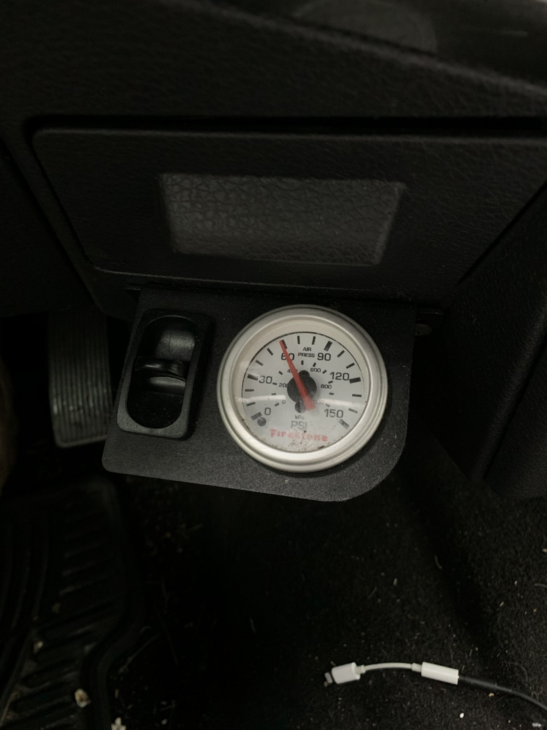

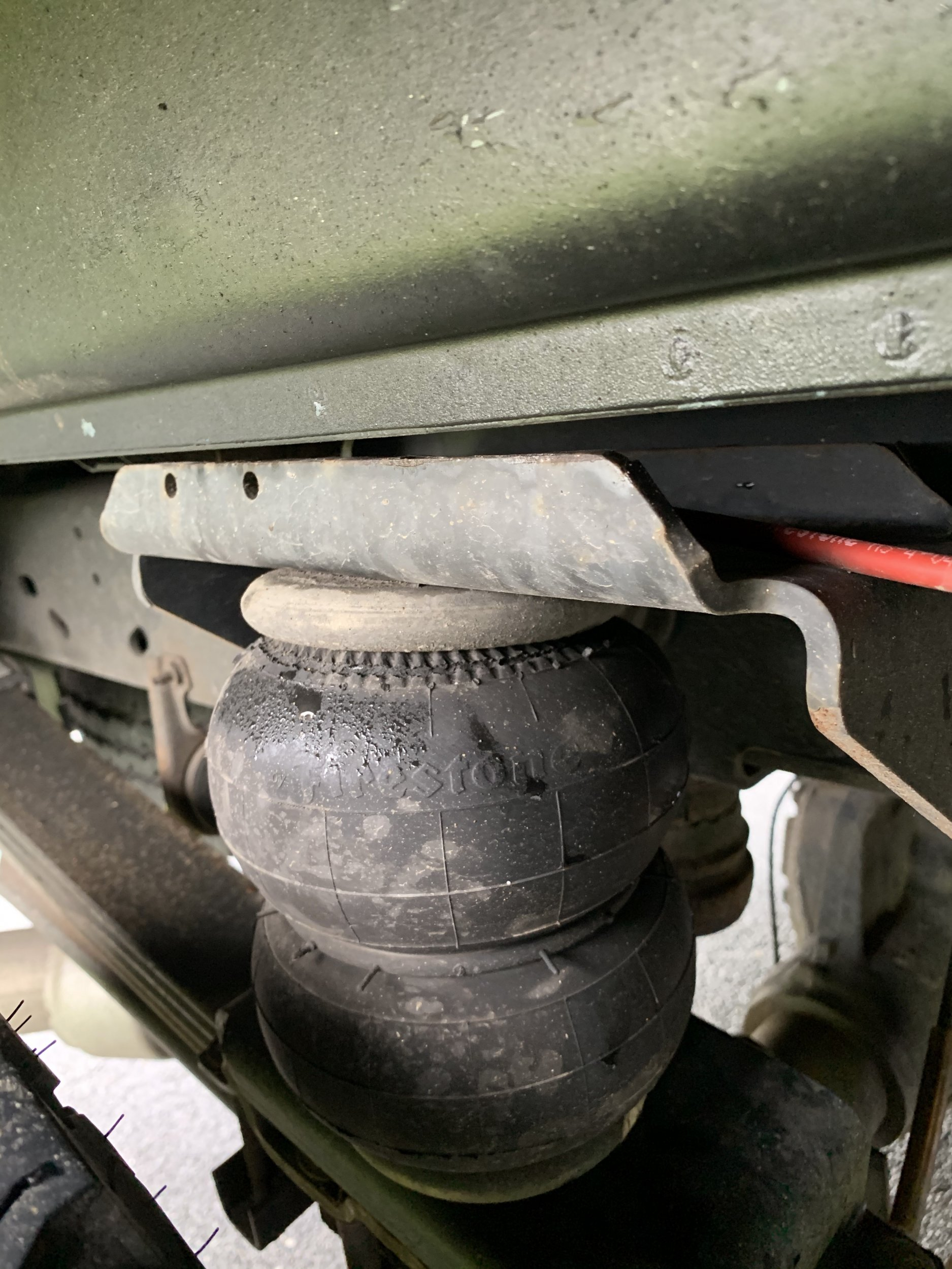

I think a 3/4 ton is barely enough truck for a dump trailer like you are considering. If I were in your spot, I’d be looking at a pair of Firestone ride rite air bags.
I had a set of them on my 2008 F-250 and they made the towing the trailer a much, much better ride. They are a cheap investment for what you get back if you are going to load that trailer up heavy.

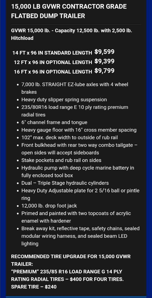

The 16 foot ones seem awfully big and I can see how people can easily overload them. I think I’m leaning towards the gooseneck in 14 foot. The trailer weighs just under 4K so that would give a hair over 10k of payload. More than enough for my needs and a smaller skid steer.

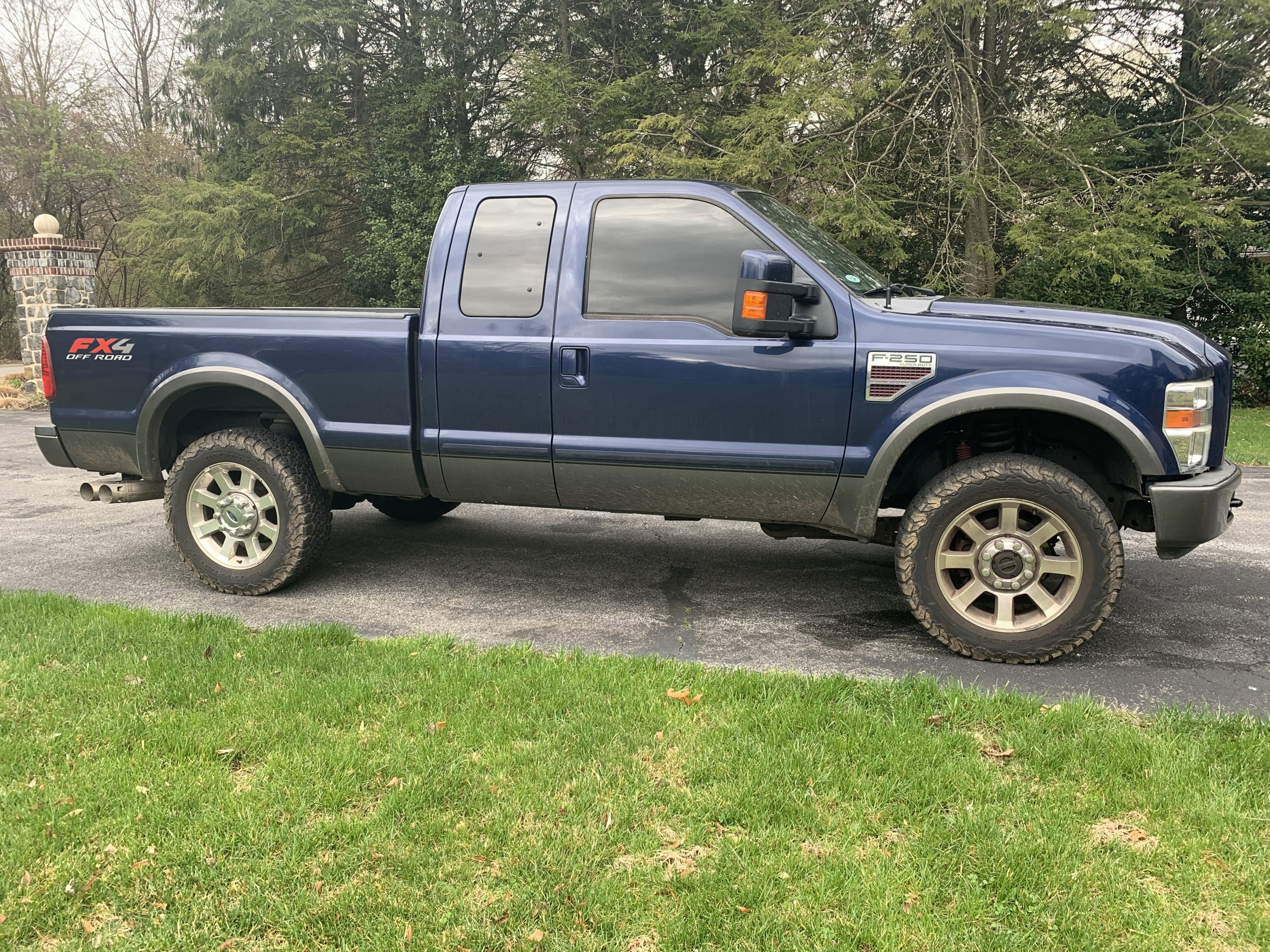

I’ll see how it does, I’ve been looking for a 1 ton but it’s not a great time for truck shopping right now. What I’ve pulled with it now it’s done better than I anticipated. I’d like a diesel but I don’t want the diesel bill if stuff goes south.

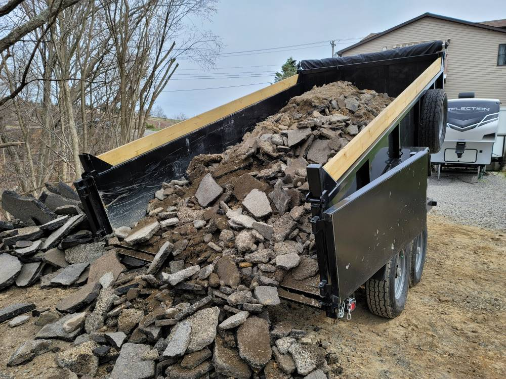

It's super easy to not realize that your overloaded to the point that your lift will not work. This was about 2/3 full and we had to unload a lot by hand to get it to lift. This was the second load with fully charged dual battery on a 14K gross. Typically you can overload by a ton or two and still lift.... I'm guessing I must have had 18,000+ with trailer and load. It happens easier than you think. I cut loading this short to make sure it would dump. I was wrong. About half full arms to be more safe when your dealing with heavy material. If it's mulch you can fill it full.... dirt, concrete and asphalt will humble you real quick.
   / Want to buy a dump trailer, kinda torn here. #19
The load.

Im wondering now if I should go for the 16k, not sure the extra 1300$ is worth another 2000 pounds of payload.
