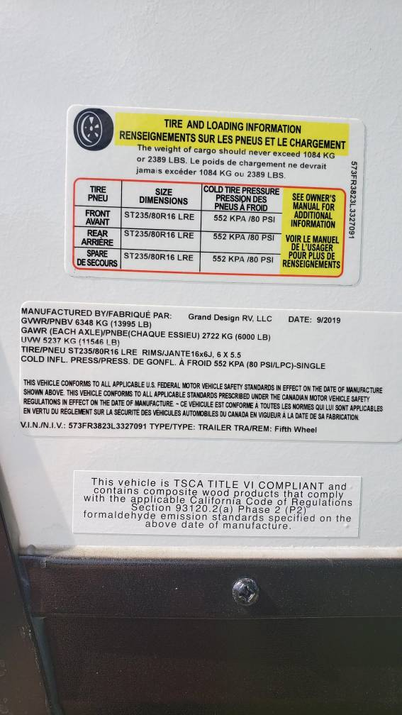

GVWR is a described, but when attached to the tow vehicle some of that weight is applied to the tow vehicle and not to the trailer.
Ponder this typical RV sticker.
My 2K lb bare Quality Trailers 7K gross utility trailer is also rated at 6K lbs payload with 1,000 lb tongue weight applied to tow vehicle.
It's what weight is applied to the scales while attached to tow vehicle that's legal. When you get weighed, it's all about axles. You do not separate the trailer to get weighed.
Yep. Your still wrong. I'm done. View attachment 695497
After admitting I was right about the way a GVWR is defined, you change the discussion and end with I am wrong. You're really funny.
It seems we agree that the definition I used and explained in one of my posts (that you quoted) is the actual definition of the GVWR. Since that didn't go how you wanted, you would now like to discuss the different subject of how DOT inspections are handled. Okay.
