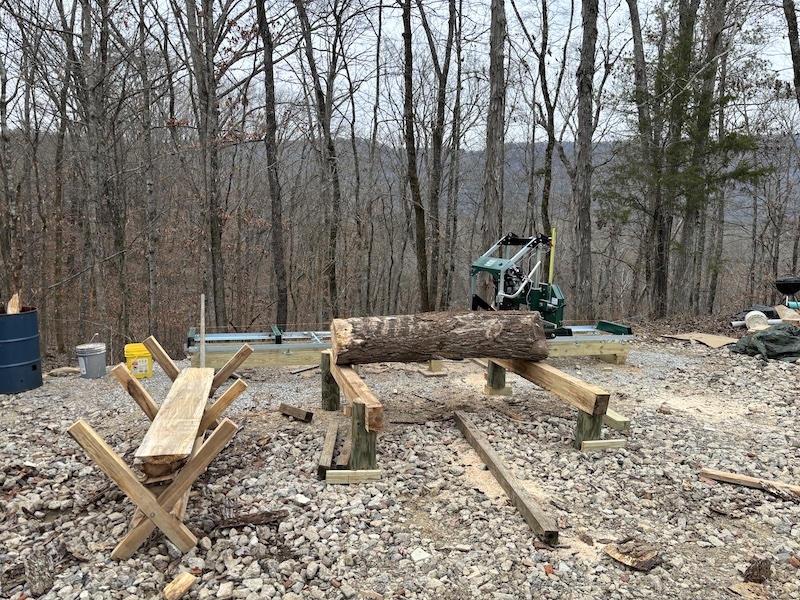

Starting to get things dialed in. I wanted to build a log deck wide enough that would allow me access to the mill with the tractor, but I am not sure its going to work well. The way it is it doesn't allow me to put shorter logs on it. I might have to go with a log deck that does not allow tractor access as I feel like it is more important to have a log deck than it is to have tractor access. I will make the deck so I can lift it out of the way with the tractor if I need to get in there. I want a deck because I think it will be easier to have the deck loaded and show up and mill, rather than getting the tractor every time. Also, I do not love loading the logs on the mill with the tractor every time. I think you increase the chances of hitting the mill that way.

Could you use a log deck that sloped to your mill, so your tractor only has to get to the end of it? I've seen a number mills that were set up for a "gravity feed" of logs to a set of stops, and then a log was rolled over the final stop or the stop was removed for one log to move the log onto the mill.

It is not the rolling part, that is easy the deck is lightly higher than the mill. The main part is positioning it on the mill in the ideal position. Not easy to move these logs forward or backwards once they are set down. Also accommodating all lengths of logs from 6-16 feet.
   / Want to buy a sawmill - Talk me out of it! #199
Have you considered a small "gantry" type rolling crane to lift and move your logs from your stock stack to the mill table.
