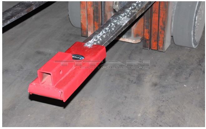

I bought one of these for my TC40DA so it would be closer to the pin. Be careful getting the weight that for out in front as leverage comes into play. Without ballast weight on the back end of the tractor my 3 horse GN will lift the rear tires if I try to turn it while moving it. You can also torque the FEL with the load off center.
Skidsteer Trailer Receiver Hitch Bobcat Case Skid Steer (REC-MP)

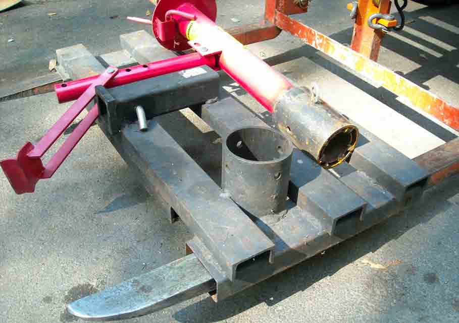

A bolt on clamp over both forks is far superior to drilling a hole, and they are readily avaliable in the marketplace, or just build one. JMHO
   / Want to drill hole in pallet fork for trailer ball. #30
You bet you can.
It is different with a "real" forklift where you can move the tines all the way to the
center, and you have gobs of lift force available.
Here is the trailer-tender I made. I also use it to mount my tire changer. The first
version I made, I bent lifting a heavy trailer full of gravel, so I strengthened it. It goes
on and off faster than a ball screwed to one tine.
