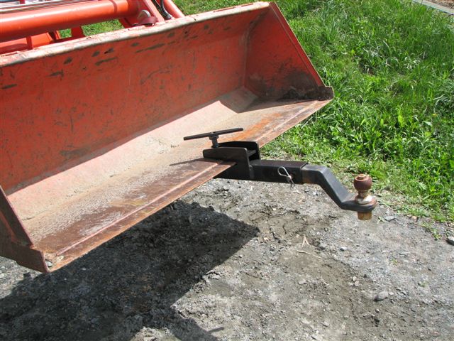

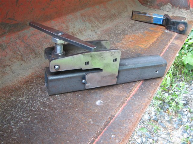

Homemade FEL receiver hitch that won't fall off. This one has a very rugged clamp.....an it is suggested that a ratchet strap also be used (as shown in the photo) as a safety.
Jim

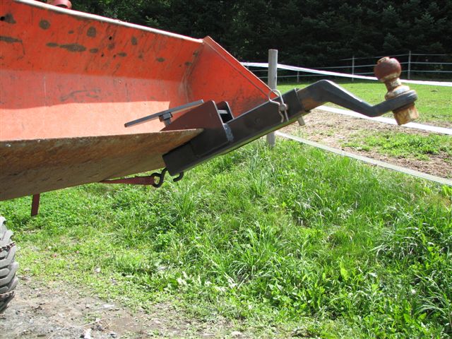

Here are a few examples of my bucket trailer ball at work. no tools required and it can be moved to the bucket edge for tight trailer parking. I use it on my lawn roll too. It will pick-up as much as the bucker will lift as well. Easy to make.
enjoy
enjoy
Dakotas BX25 Photos - BXTractors.info: The Kubota BX Wiki
