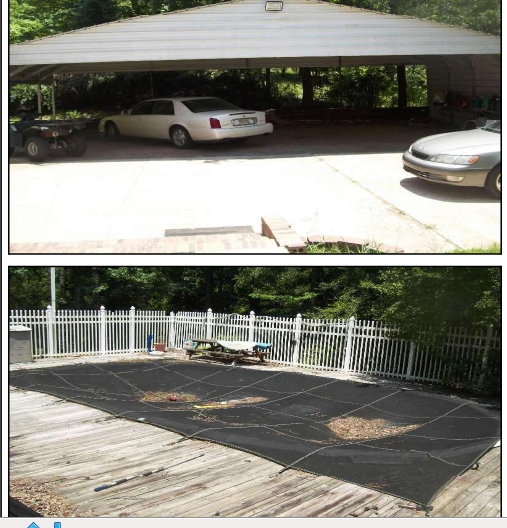

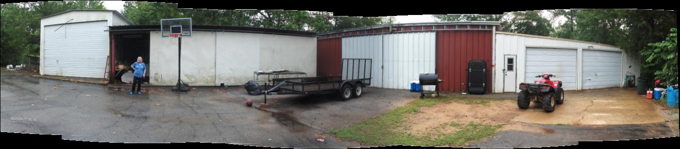

I've 4 shops that cover 5,500 sq feet, all on thick concrete pad, no a/c but the two on the right had gas heat (until someone stole my LPG tank last year)
419395d1428038989-want-put-up-shop-outside-shops-jpg
The red one is 40' wide, 60' deep, 12' high with a 1 bedroom apartment 15' deep across the back, w/ shower, toilet, kitchen and this does a/c sink etc.
They are all wired and well lit, w/ 400 amp service (including about 8 240V circuits).
The appraiser never even went to the shops and placed the value of the shops at about $8,000 (that works out to $1.45/sq foot).
I've also a typical metal carport near the house that has a brick "floor" and only 1 side closed in. It's 600 sq foot, has 2 fluorescent lights and he valued that a $15/sq foot, or $9,000. It's the top pic
attachment.php
That's about the cost of a new one.
If that LAME appraiser had valued the shops and apartment at $15/sq ft it would have added about $70K to the appraisal, and made the loan REAL easy to get.
So Arc weld, don't count on the appraiser adding value for ANYTHING you do. They can be blind.
