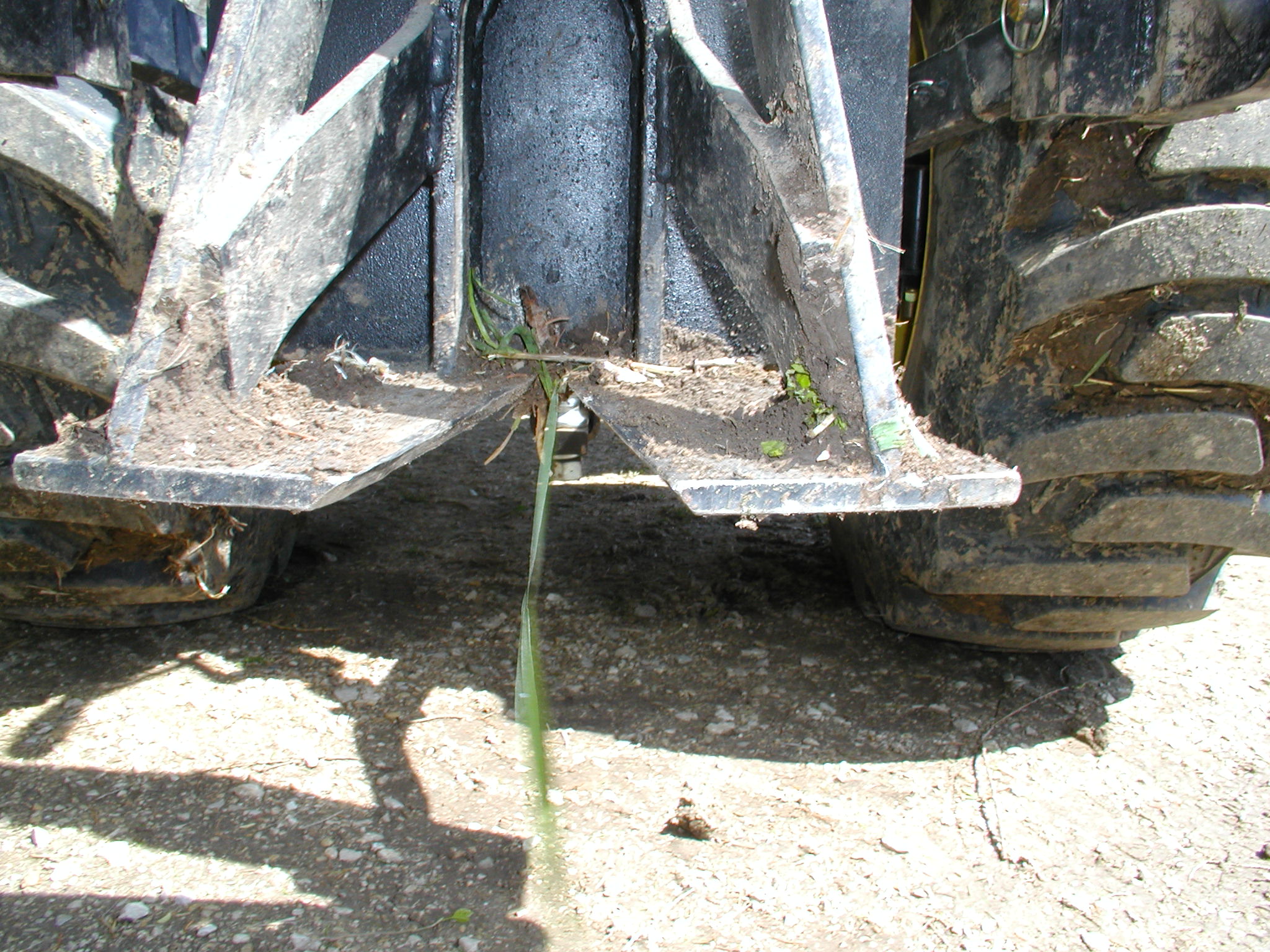

Here's my version of the tree gitter (see photos). To use you lower it, back up the tractor so the tree goes into the "V". Keep backing up and start to raise the 3pt and the tree will come out of the ground roots and all. Sometimes it sticks in the tree gitter, and sometimes it falls out on its own. Works great though, and was built for peanuts. In case the phot isnt good enough, the "V" shape is sharp inside, on the bottom edges. And, for clarity, both edges are fixed, nothing moves. The flat metal is !/4". The space between them is 3 or so inches, and tapers to virtually zero.

Jimgerken; thanks for the pics of your grubber. I'm planning on making one similar to yours. It's always a help to see what others have come up with. Only difference I will turn the drawbar the other way so the flat is vertical. It will be stronger that way.
