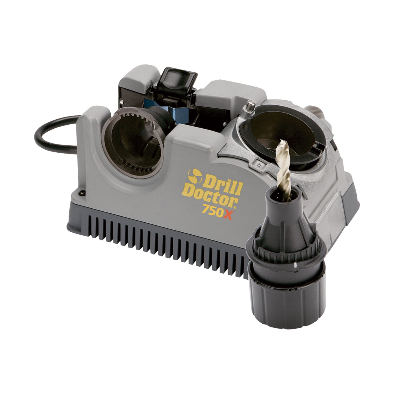

Have you guys ever looked at the Drill Doctor bit sharpeners?
Quick and easy bit sharpening.
I bought the low end model 350x several years ago then upgraded to the 750x last year.
   / Wanted: First and Last drill press I'll ever own #56
My Drill Doctor is at least ten years old. Works good for bits from around 1/8" up to around 3/4". Below 1/8" is sort of hit and miss - hard to control the sharpening process. There is an upper limit for Drill Dr and I think its around 3/4" maybe up to 1". There is a learning curve but once its mastered the bits are very close to brand new after sharpening.

As noted, I use my Drill Doctor 750X but, mostly just on larger bits. I don’t try to sharpen the smaller bits. These bit sets at Woodcraft fill that void.
1-Piece Combo Brad Point And Twist Drill Bit Box
It’s a combination of smaller twist drill and brad point bits. I use the brad points for woodworking and twist drill for steel. Really nice to always have a sharp bit. Woodcraft used to have boxes like this that were twist drill bits only and brad points only. You got many more of each size. As I recall they would go on sale for $19.99.
