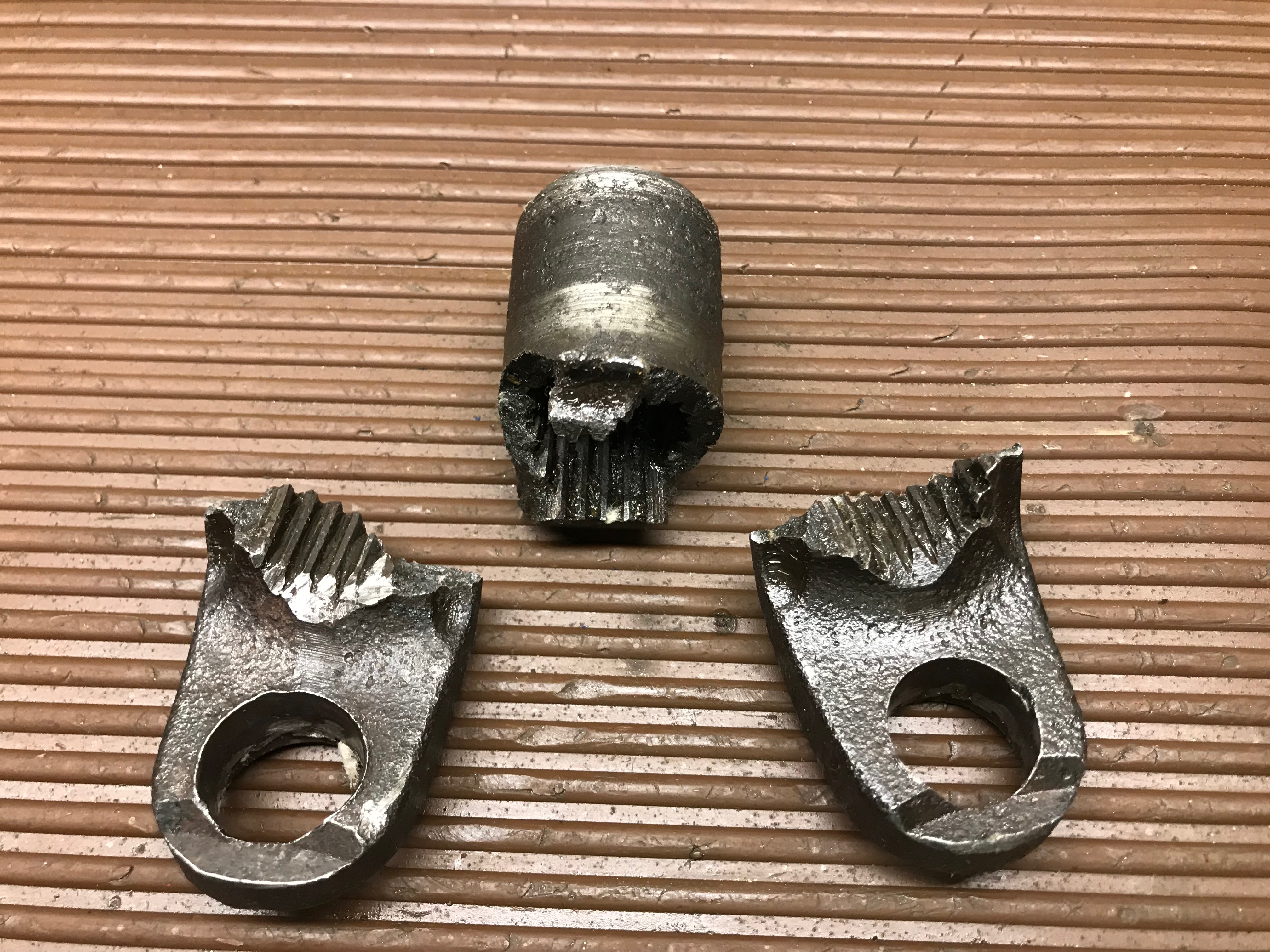

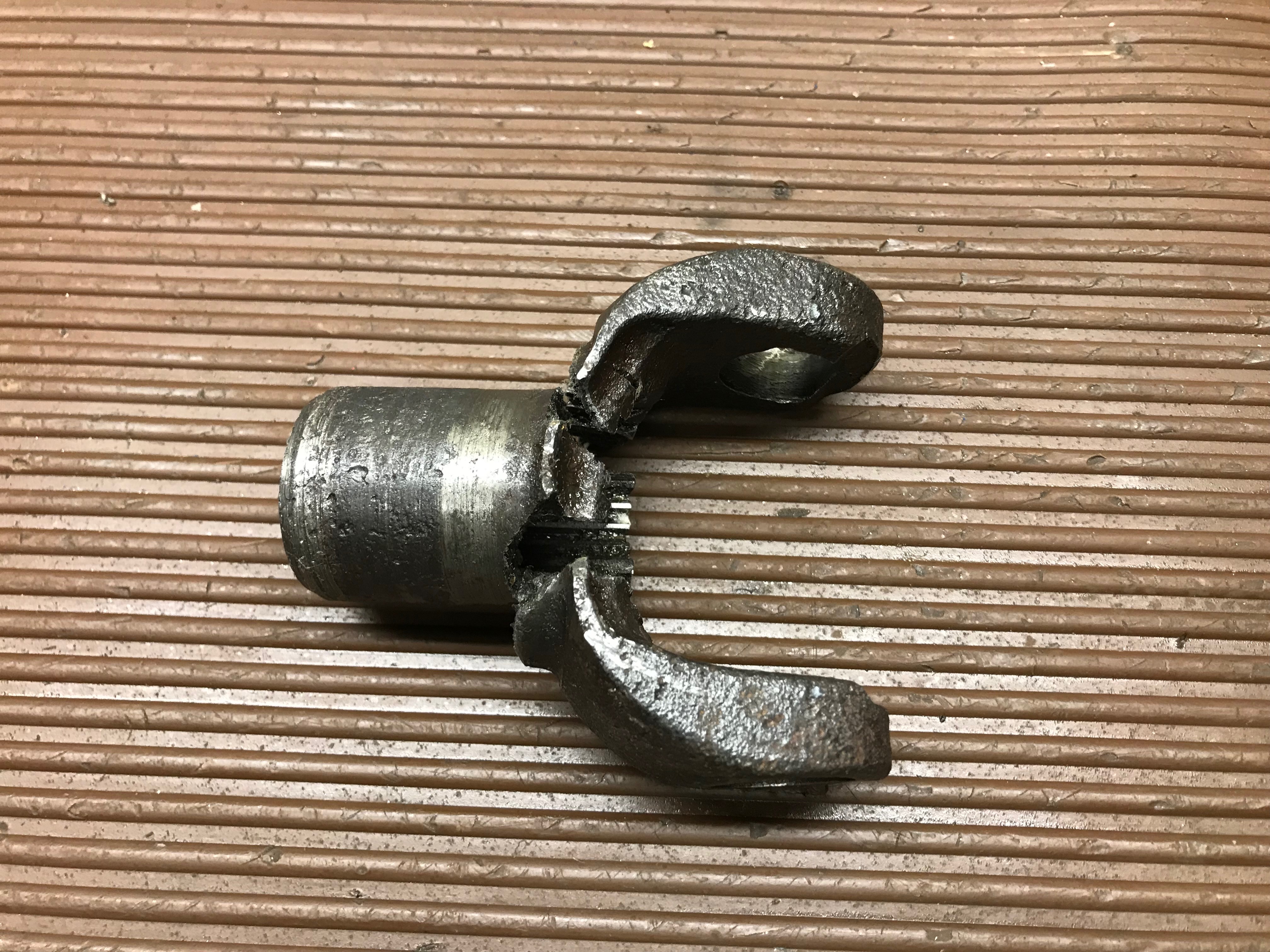

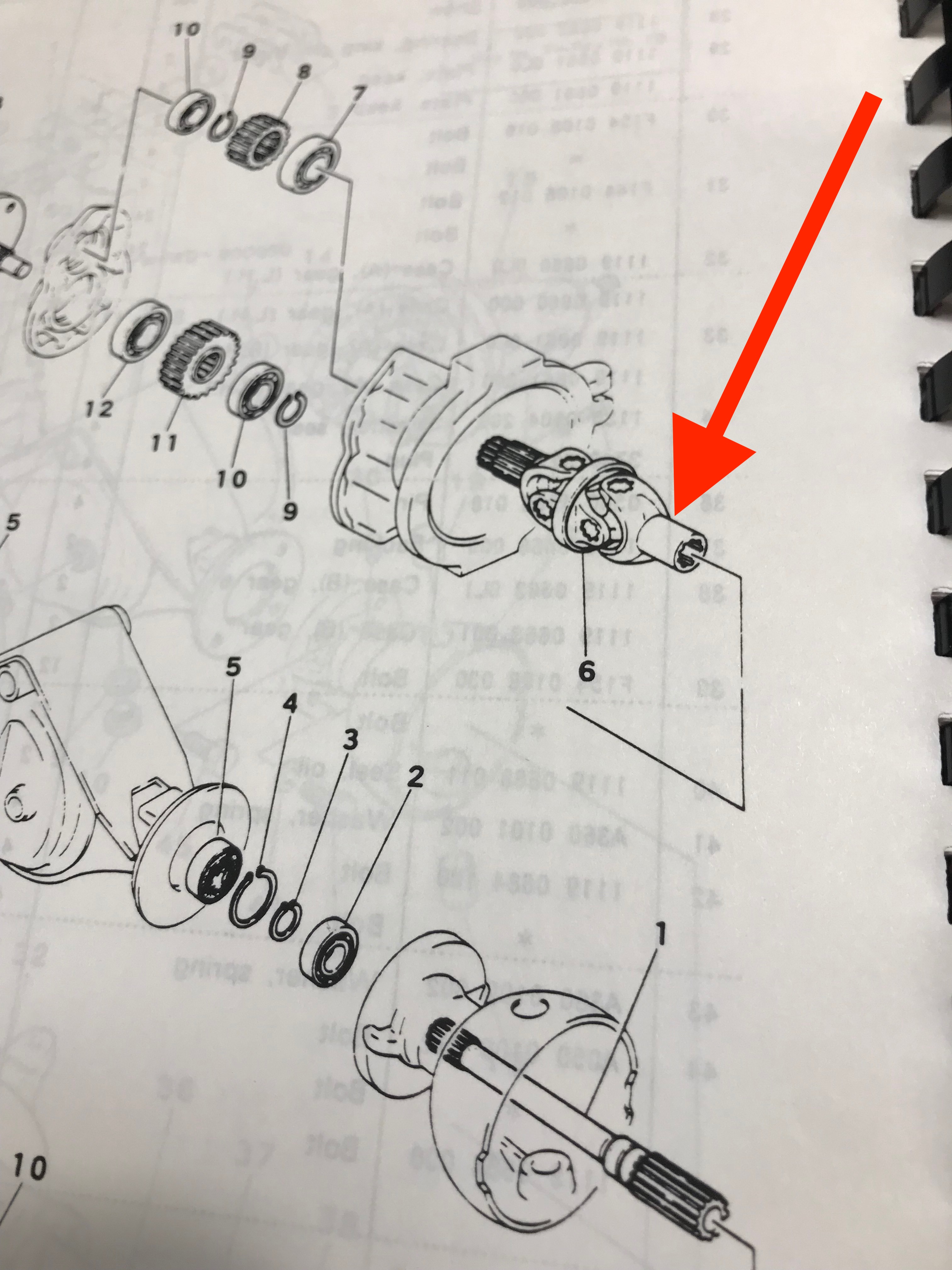

HELP. I'm looking for an inner front drive shaft yoke for a Satoh Beaver 4x4 S370D/Mitsubishi. Anyone have a spare laying around or parting one out? Or has anyone found any aftermarket/repair options? I only need the inner side (female splined hub -to- universal).
I've already checked with Valley Power Products and Southern-Global, no luck.
Thanks!!

Well... No Go. No one has any. Anyone have any other thoughts?
I may start looking into getting something custom made...

Although that is a cast part it can be weld repaired. If you're lucky it is cast steel which is likely (vs. cast iron) and it can be welded using typical welding techniques. If it's cast iron, it can still be weld repaired but it takes special techniques and filler material. In either case if you're paying a welding shop to do it then the cost will be pretty high. If you know someone who is a decent welder then maybe you can get away with letting them borrow your tractor or other bartering. It may also need to be bore-aligned after the repair but considering the circumstances might be something to try - you can't really make it any worse. Good luck!
