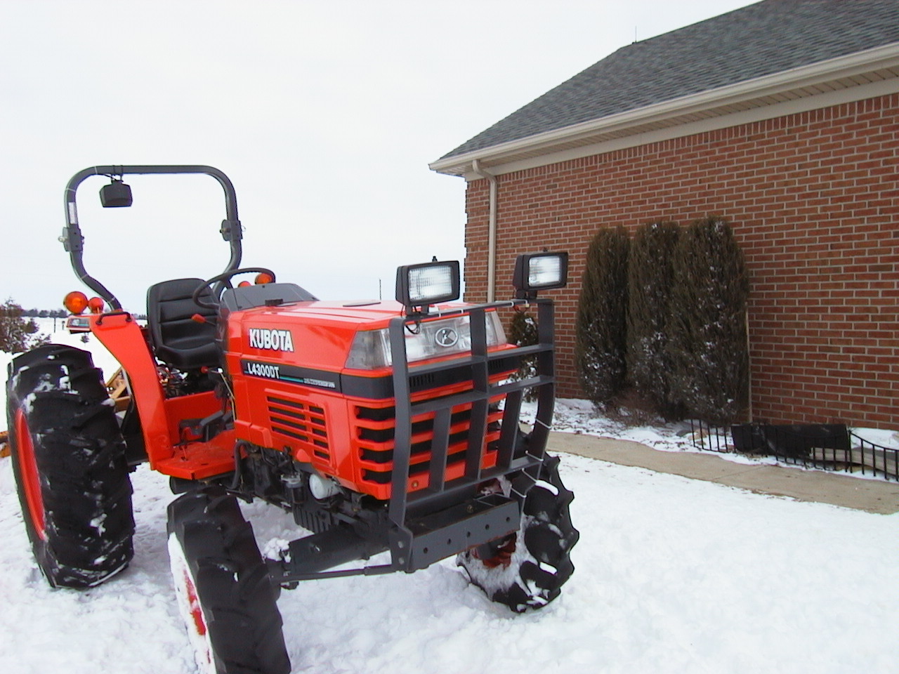

   / Wanting to mount some lights to loader? #8
I have not had luck with mounting the lights high up on the ROPS. The shadows created make it difficult to see what you are doing and I don;'t think they do much good up high. Better results for me came when I mounted them on the top of my grill guard. When the loader is down the tractor lights suffice and when the loader is up the grill guard lights are pretty good. None of this is 100% satisfactory because of the nature of mounting lights behind an obstacle.
Above is a photo of my L4300 setup.
   / Wanting to mount some lights to loader? #9
Nice setup sixdogs. My headlights are mounted fairly low on my tractor. Loader down, I use the work lights. Loader up, my headlights shine underneath. Seems to work well here.
You're 100% right and I like the quote. "...the nature of mounting lights behind an obstacle" LOL
