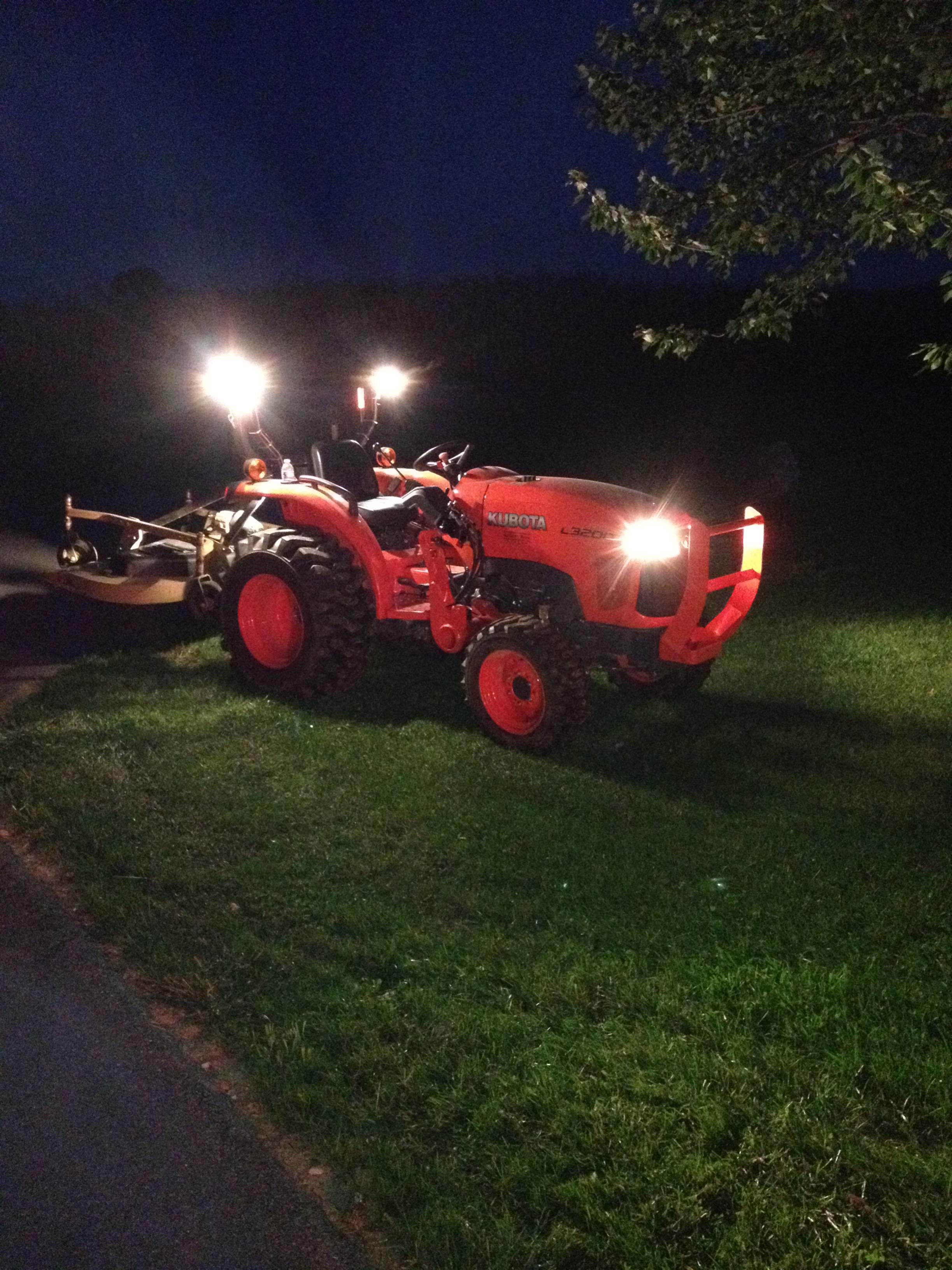

Always wondered if lights on the loader arms would work well, but never tried it. I've tried a few different mounting places for work lights and so far the one that worked best for me was ton the loader frame when I had the B7500:
It was surprising how well that setup worked. One flood on each side angled outward lit the work area nicely. It seemed like the loader and hood should have blocked the light, but the pattern was great. Below is a shot of the L3200 with lights mounted on the ROPS. The lighting was better than on the B7500 but there was another problem. I mow after dark sometimes. Dark + lights = bugs flying in the space I'd like to reserve for my face. How much after-sunset mowing depends on my schedule. One Spring it might have been May before I mowed in the daylight.
I'm about a week away from finishing a cab for the L3200 and have made provisions for mounting lights at the front/top of the cab. It will be interesting to see how that works. The lights came from our old plow truck at work. They are only a year old, but the truck was declared dead and we went with a new plow/lights/etc on one of the spare Tahoes. I'm hoping these lights throw a wide enough pattern to be useful.
