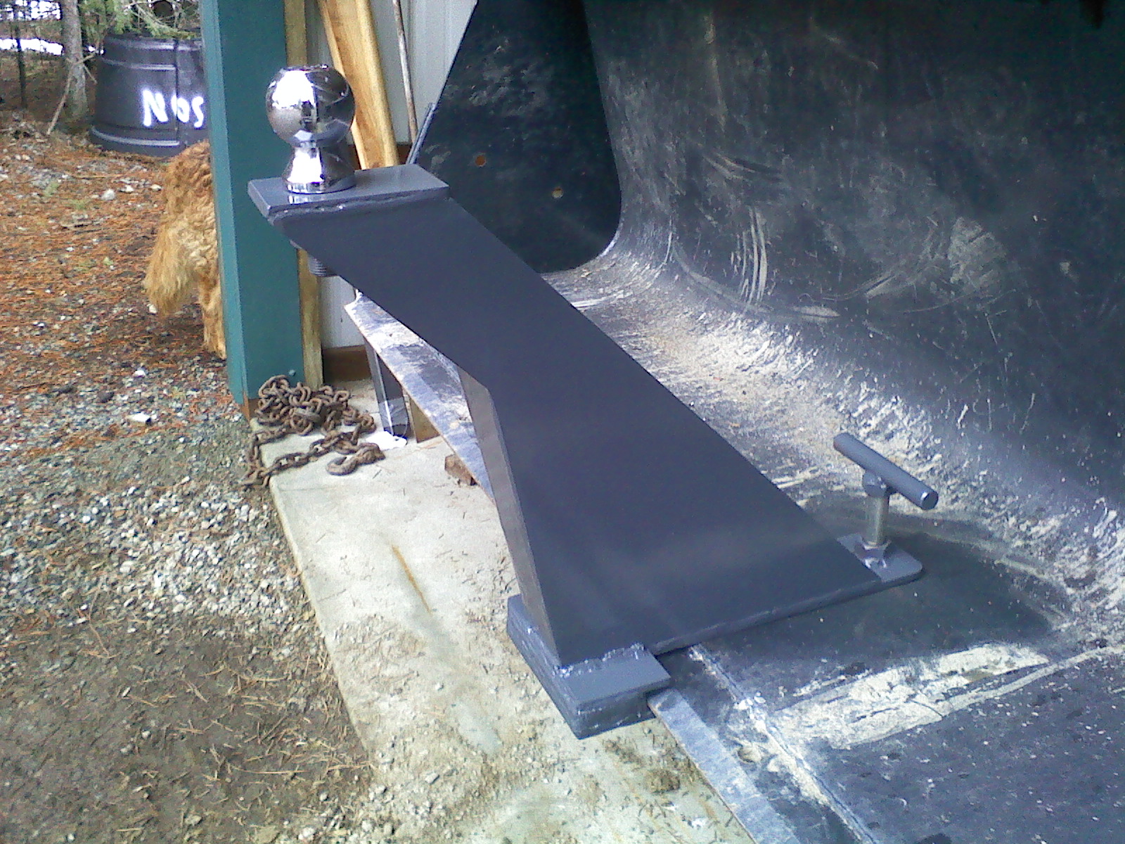

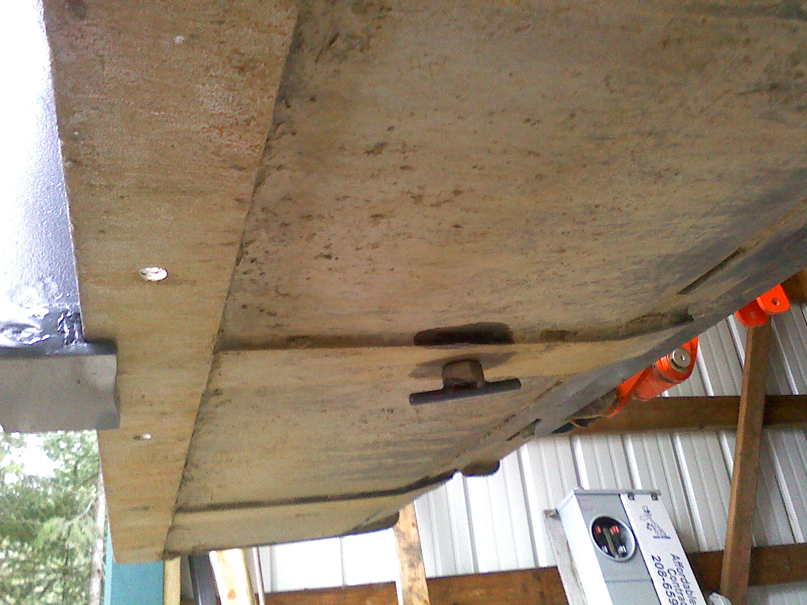

I hope you have some sort of backup restraint for that gizmo (other than friction from your setscrew). IIRC CurlyDave had a trailer mover that attached in the same fashion and it slid around on him. See his thread at: http://www.tractorbynet.com/forums/safety/117762-paynes-hitch-receiver.html

not a set screw...its a 3/4" stainless steel bolt that goes thru a hole in bucket and is bolted from underneath. just doesnt show in photographs. i had a similar one on my JD for 8-10 years.
here is a few photos..its a stainless 3/4" bolt and nut. the "T" handle is just to help carry it. that much 1/4" plate is kinda heavy

That should hold it.
