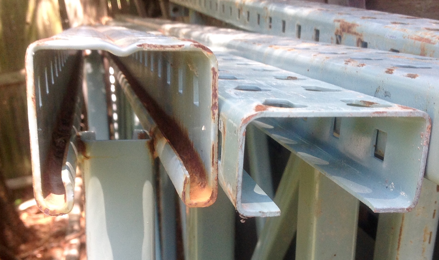

I'm "into" pallet racking, having bought a lot during the downturn from places closing.
I set 1 well used rack outside in Alexandria Virginia for over a year and the additional rust was minimal. I think occasionally spraying with Fluid Film may have prevented that.
There is a frequent CL ad where they sell used pallet racking in Baltimore. I like pallet racking because I can load a rack to the ceiling, unload it and move it by myself. No ripping wood apart.

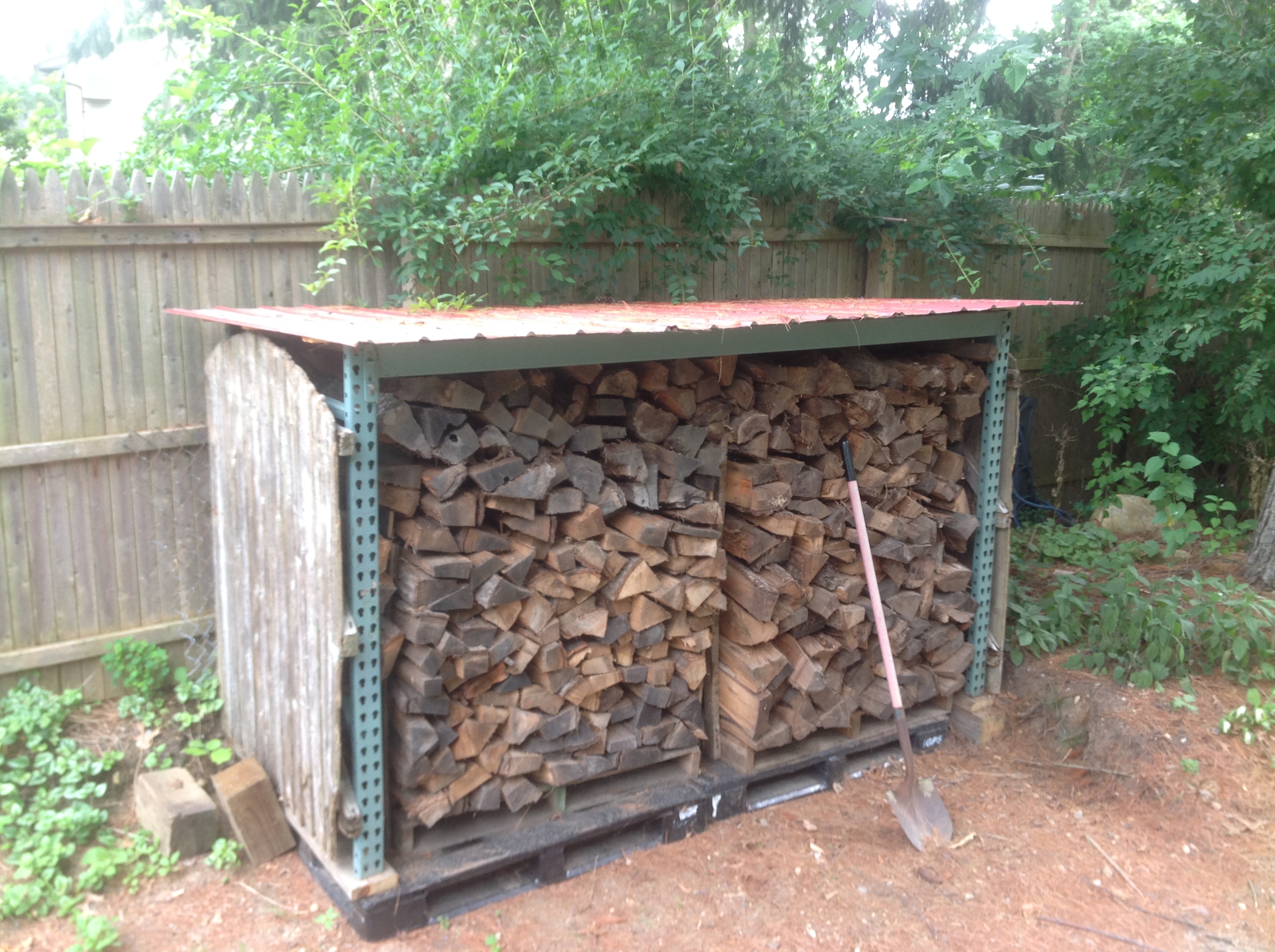

/ Warehouse racking for wood stacking? #6
if your using totes just stack them on top each other.. as soon as I can get enough that will be the only way I do wood.. 20170129_163753038_iOS.jpg

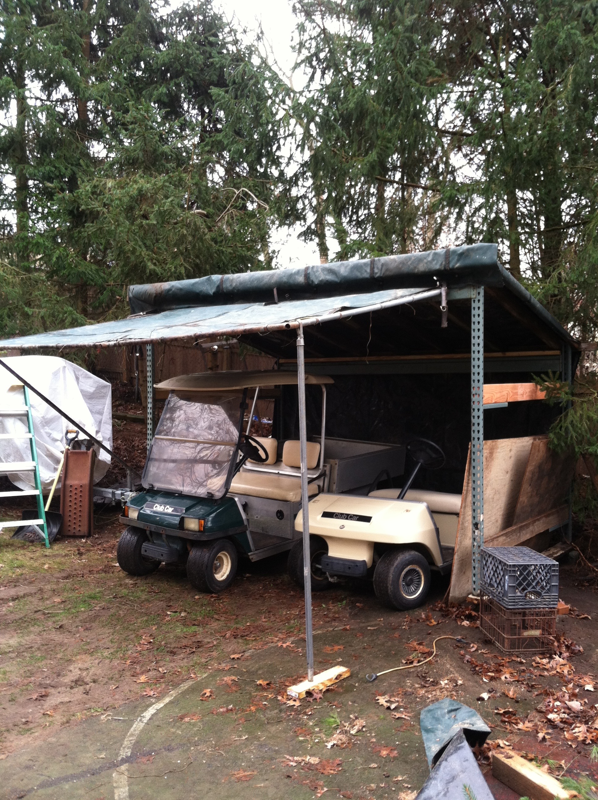

Whenever I go to my BJ's I always drive around back by the loading docks to see what they're throwing out.
Have found many 28" x 52" red plastic bottoms for push carts some damaged some not-great for laying on ground to stack wood or pallets on
My absolute best find however are the pallet racks they use in the warehouse and stockroom for merchandise. The uprights are 42" deep and 12' tall
Two years ago I saw a stack of 6 uprights out for trash. I knocked on the loading door went inside spoke to their security guy and asked if I could take them. Sure he said
I have a Tacoma pickup with 6' bed. I bought a 5 ' bed extender that goes in receiver hitch. Went home to get it and now had 6-12 ft uprights no beams yet.
I kept watching and by the end of the summer I had 20 of the uprights.
I also came across around 15 10ft cross beams
Most had a little damage to them. Usually a twist or small dent in the first 2-3 ft at ground level. I easily straightened this or reveled do the bottom footplate.
I guess they have OSHA inspections and have to switch out bad ones hit by forklifts!
The forklift drivers must not be too careful because I continue to get the uprights. If I don't pick them up they get a dumpster and fill it with the uprights and other junk.

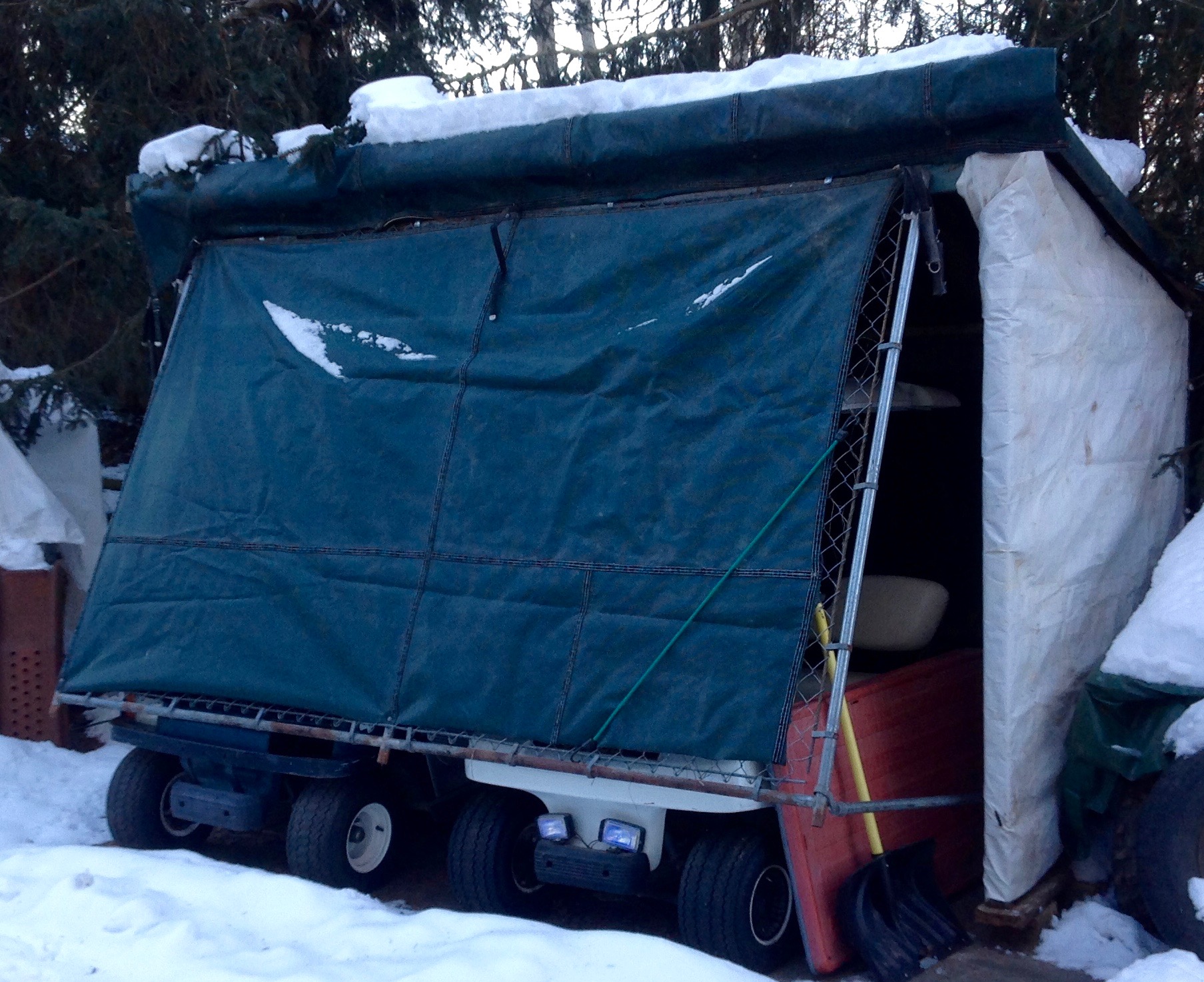

I built a 10 x 21ft shed that was going to be for firewood but ended up with a workbench, shelving, my 1920 tractor, golfcart stored in it. Added a 7 x 21 ft movable awning to the front that I lower down when a hurricane or nor'easter threatens. I used the 42"wide x 12' tall uprights for the sides, roof rafters and front awning. I ended up buying 2x4's or 4x4's for purlins and green metal roofing for roof and awning. Lowering awning before a nor'easter with 24 to 36 inches of snow was wonderful. Snow slid off, next day I raised awning and pulled out tractor to cleanup. Such a happy thing!
will post some pics for you

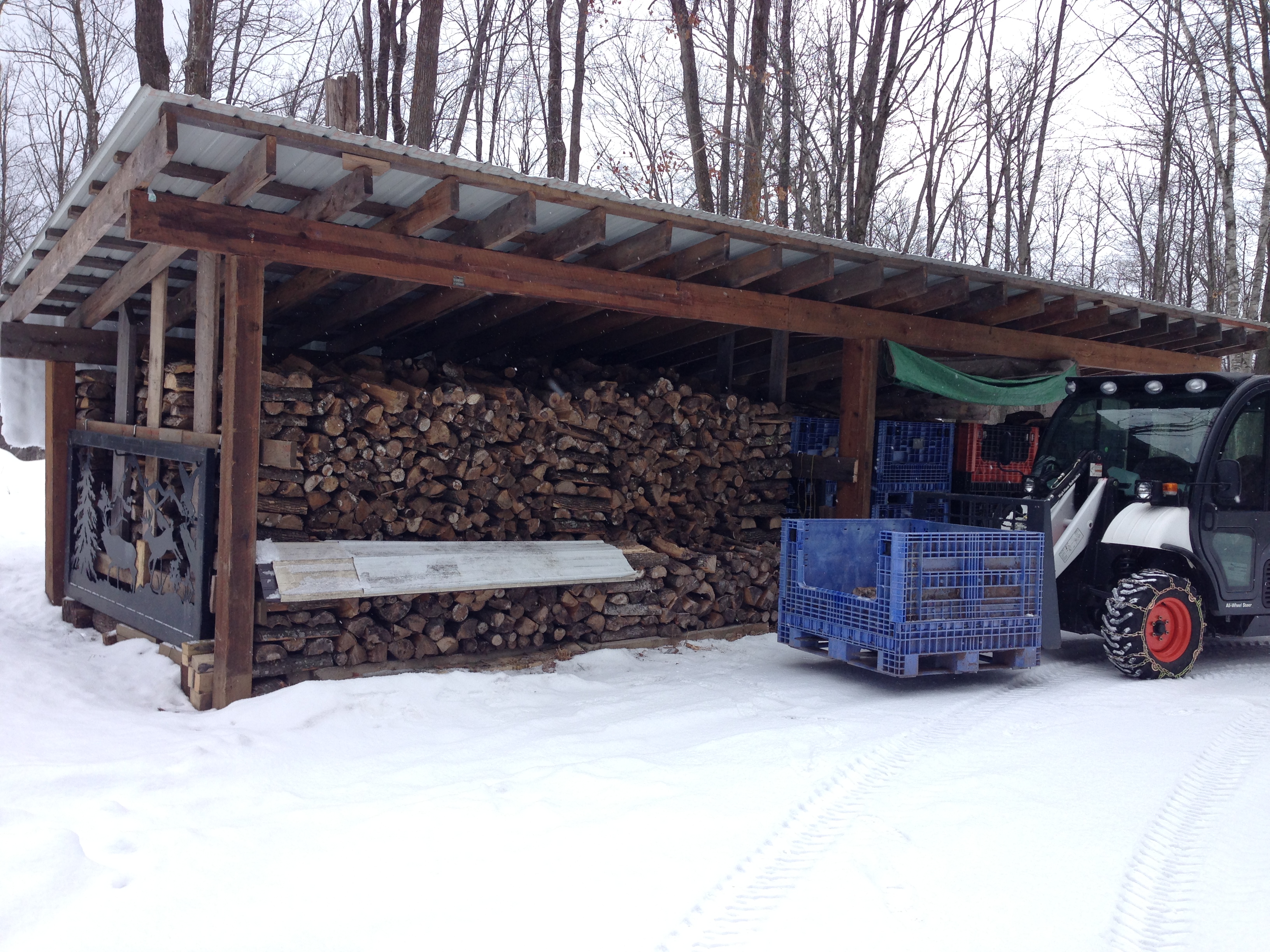

That IBC tote is "the cats meow" for storing/moving wood!!! 1st time I'v seen that..
I live near a campground that sells "bundles" of taped-up scrap for campers at 5.00 "a bundle".. about 5-6 "pieces" of wood..
I know when I had my camper there, I'd go thru an IBC tote of wood on a weekend..{size reff. only}
Just hypothetically, what would/should a person charge for a IBC tote full of wood like that?? Naturally you'd have to figure in a deposit on the "tote"..

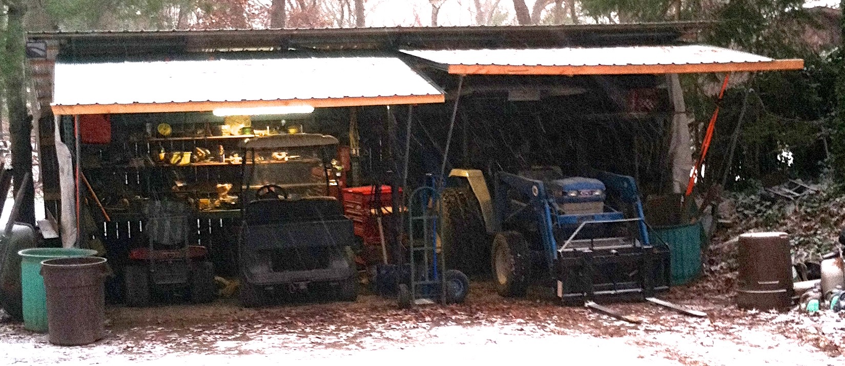

Last year kept going to the BJs near me and over a couple of months, the got rid of quite a load of pallet racks and beams. More than I needed but as my Dad trained me, I took em anyway- raw materials!
Turned out my brother could use them for a quick hay storage shed and also to build more small sheds for his tractor wood equipment etc. I kept collecting them and he ended up with quite a few. Loaded his pickup with one load. 4 hr drive to his place.
I kept getting them and he ended up bringing his big box trailer for the rest.
I always knocked on the back door of the warehouse and asked if I could take the racks. They were happy for me to take em!
Here's the pics

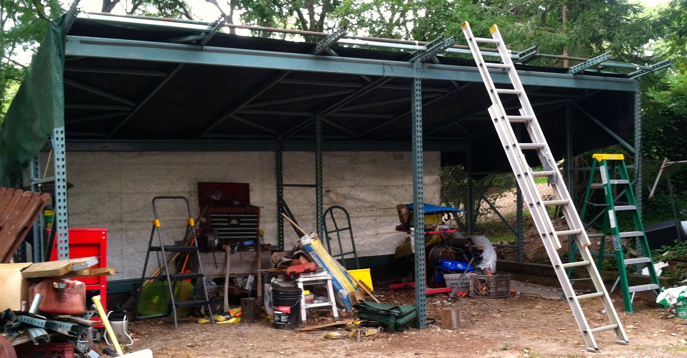

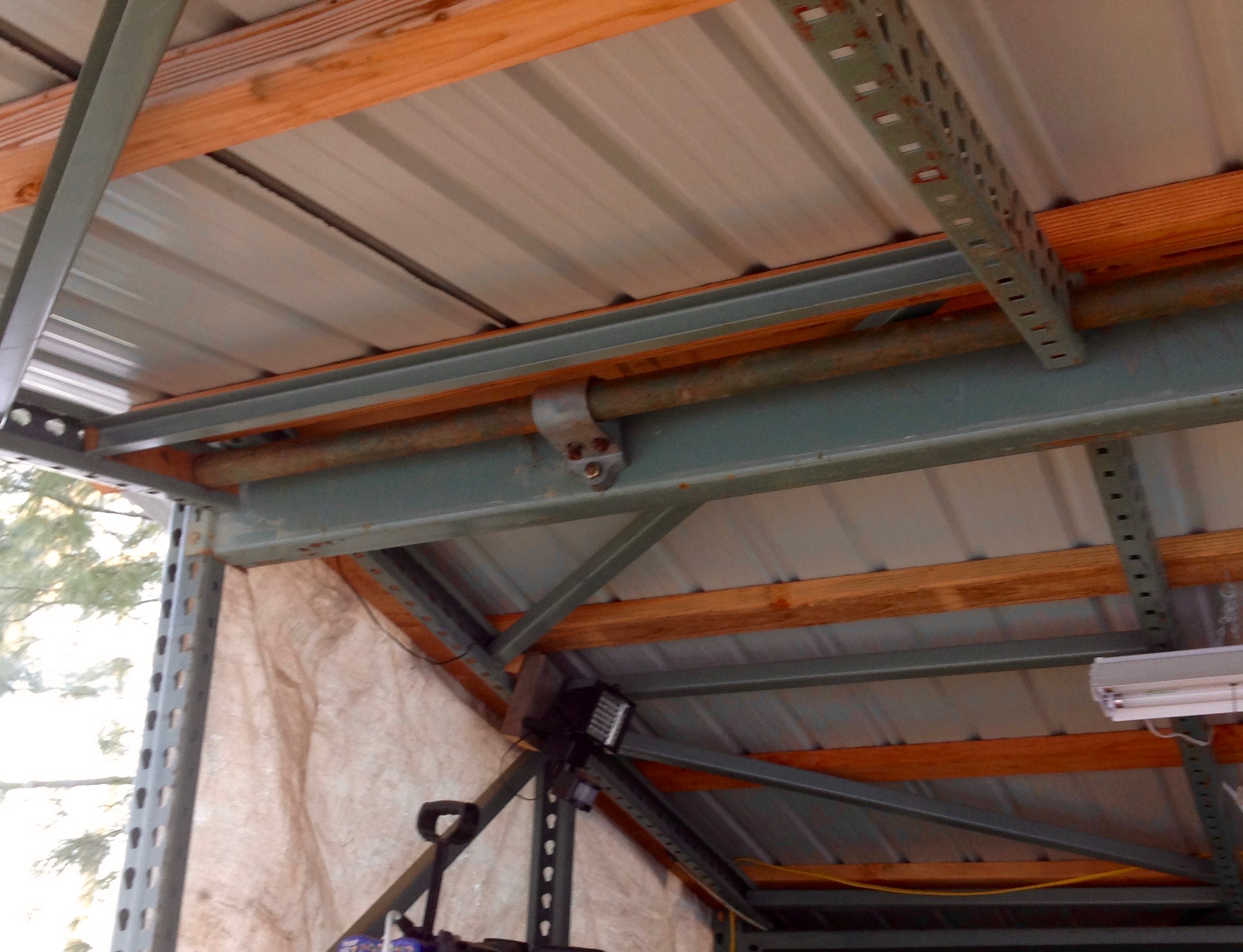

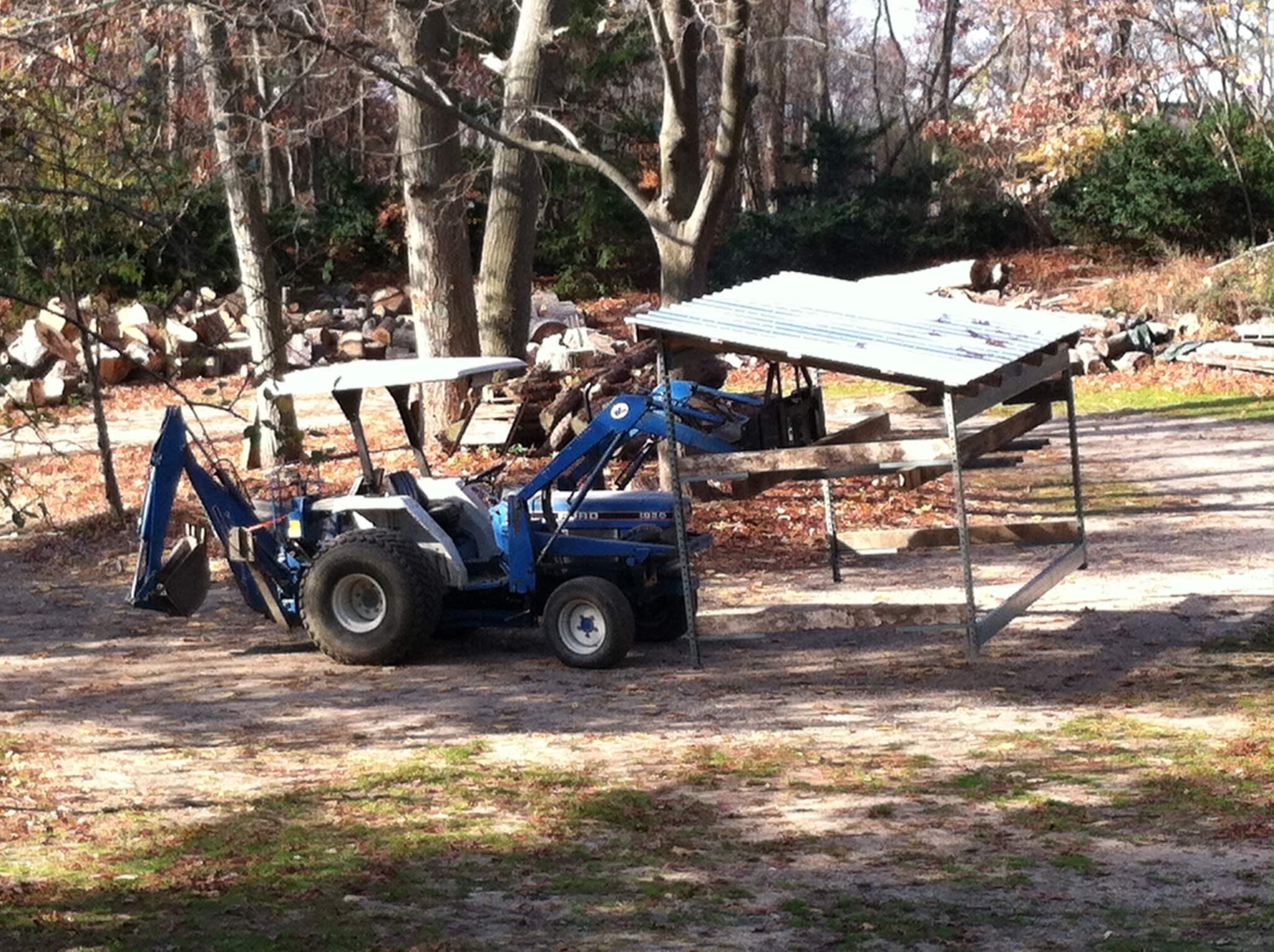

To make a small 8' x11' shed like the one I'm moving with my tractor forks
I took 2 damaged pallet uprights. They were 12' high.
I used a 4 1/2" grinder to cut the welds on the diagonals and hit em with a hammer to remove. I wanted the front of the shed 7' high and the rear 6'. So I cut the front upright 7' and the rear 6'
The horizontal cross brace was only 42" deep so I cut them with a sawzall in the center. I had some chainlink fence toprail tubing that I cut to 7' long. Which was the depth I wanted for this little shed.
The toprail tubing fit perfectly inside the horizontal cross brace I cut earlier. I used a self starting metal roofing screw to attach and soon I had my right and left sides of the shed. Welding would have been better.
Get the front and rear beams attached and you have a basic sturdy shed.
Apply roof and sides and there you go
Simple light shed
