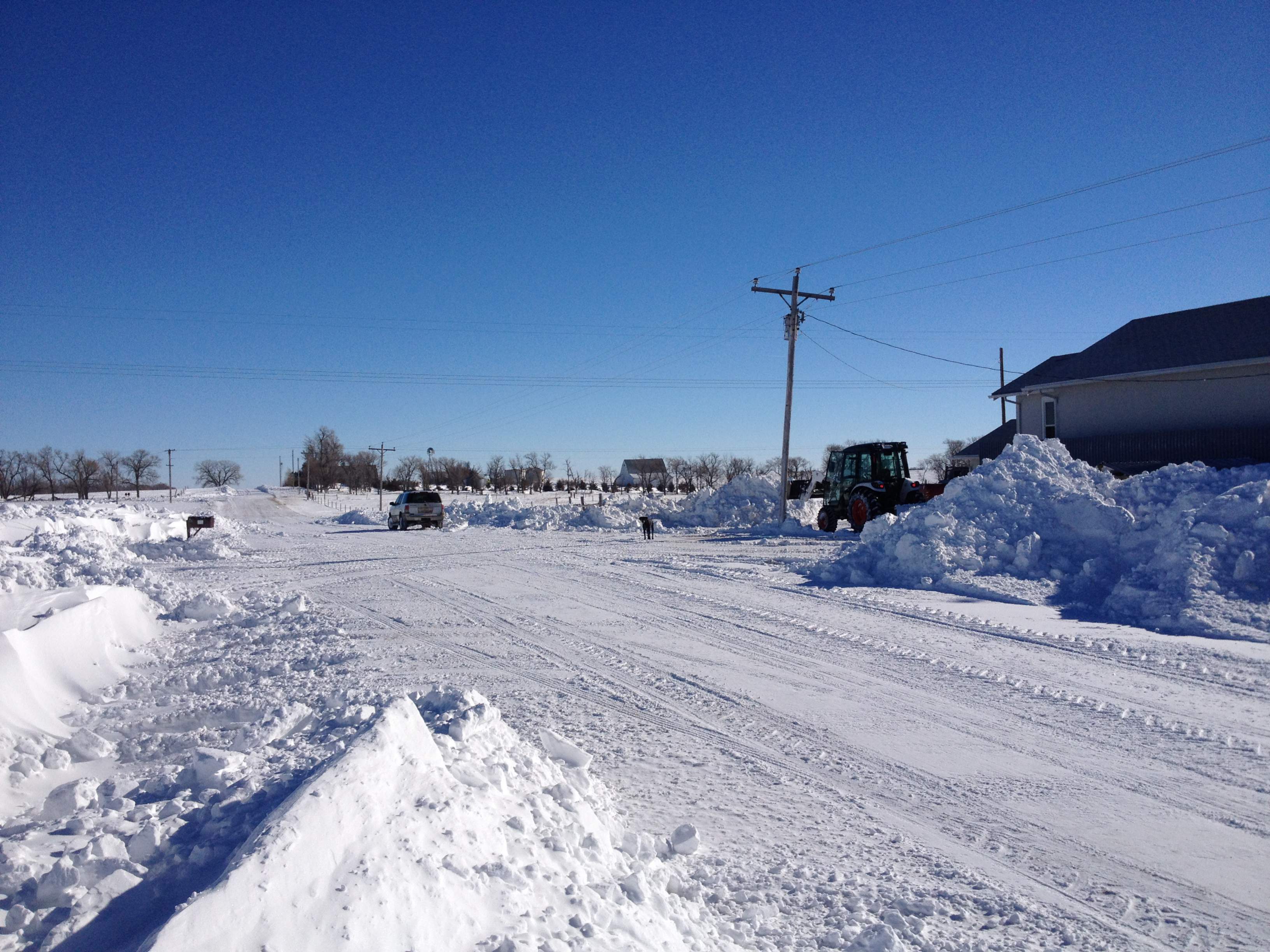

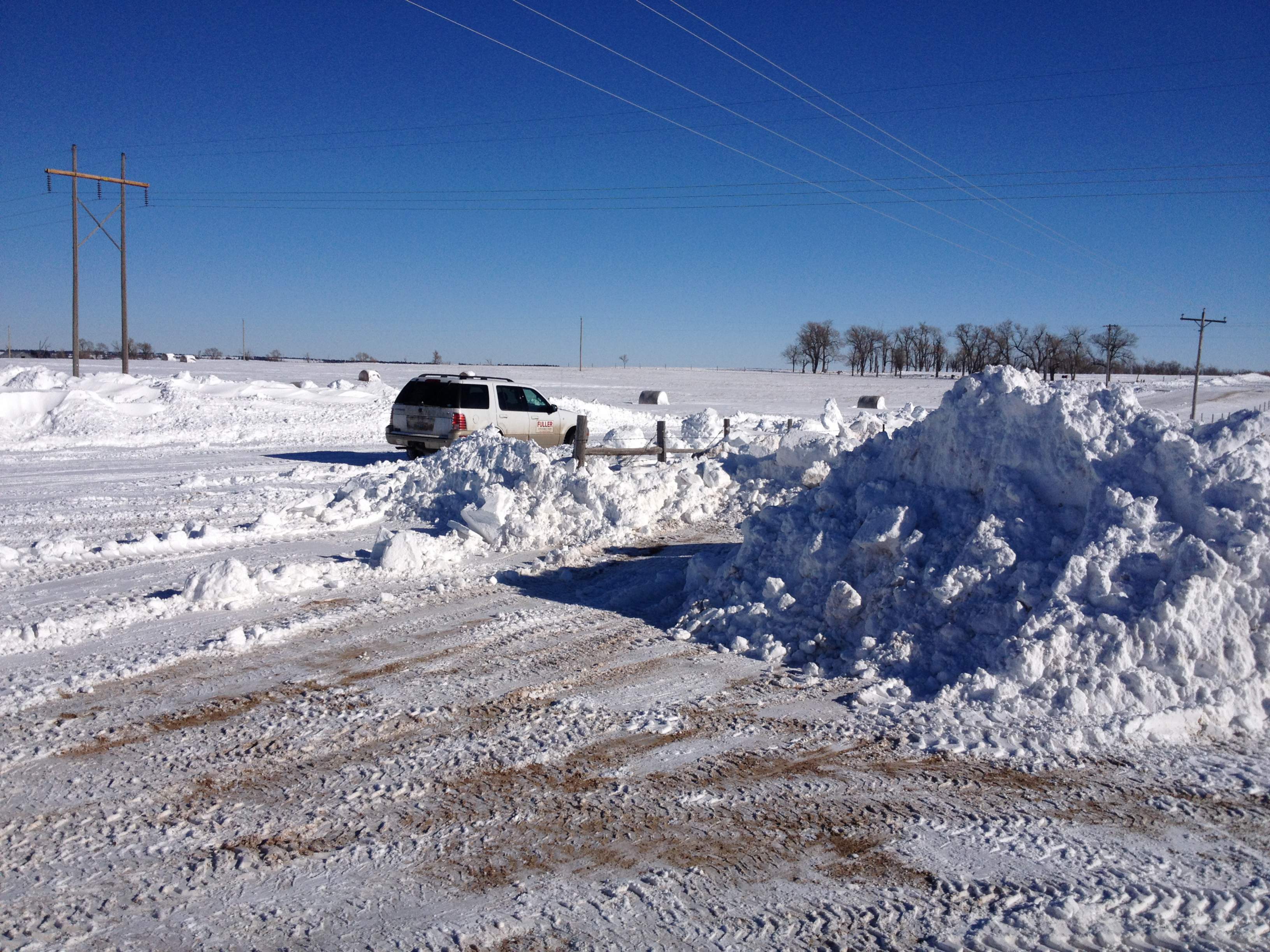

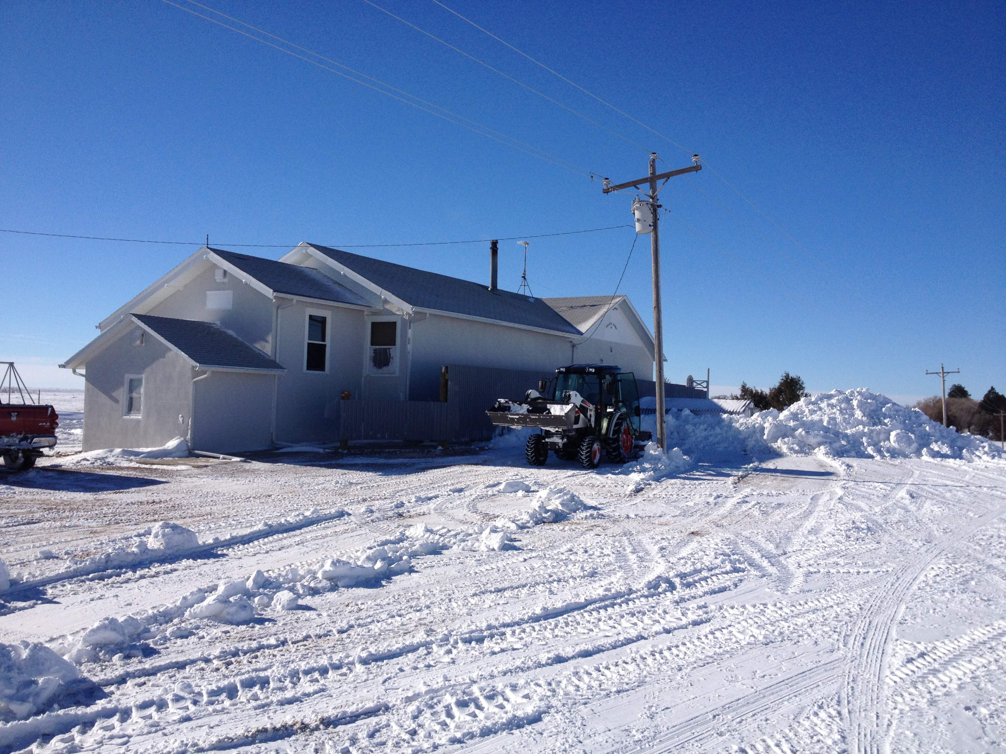

I like the PTO idea. Will give that a try tomorrow. I am still cleaning up form last nights blizzard. Picture 007.jpg
