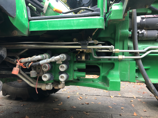

The flow will have to be controlled between the tractor and the winch to prevent damage. Here are the specs:
Winch max:
2400psi
15gpm
Tractor:
2828psi
24.7gpm

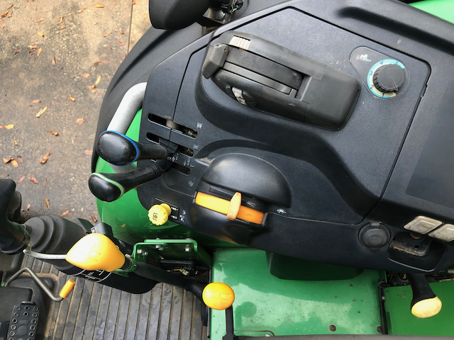

Here's the SCV layout:

The fact that your tractor hydraulic system has a higher operating pressure than the winch is rated for is harder/more expensive to correct than the flow rates. Does anyone know if there is a way to adjust down the internal pressure relief for either the mid or rear SCVs? The winch itself is setup for operation from a simple 3-position SCV which is what is already on your tractor - if your pressure and flow rates were within the allowable input range you could simply connect one port of any SCV to side A of the winch and the other port to side B of the winch. Moving the SCV control one direction would spool the winch in and moving it the other way would spool the winch out.

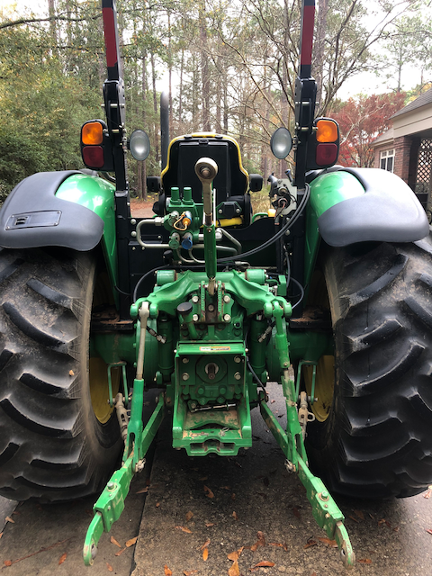

While your pump output is 24.7gpm, the max flow through a single rear SCV is 18.4gpm. Presumably the mid SCVs are similar but I did not see that information published. I would recommend picking whichever SCV is most convenient for your overall plans, adjust the internal pressure relief below 2400psi, and hook it directly to your winch with one of these (or similar) on each line. 1/2 NPT 15 GPM Prince WFC-8 In-Line Flow Control | Flow Control Valves | Hydraulic Valves | Hydraulics | www.surpluscenter.com

According to TractorData, you have 24.7 GPM of Total flow. Which include the steering pump flow. The actual flow for the loader/remotes is 18.4 GPM.
In my opinion you will be just fine without any flow restrictor, although a pressure relief valve might be needed.
