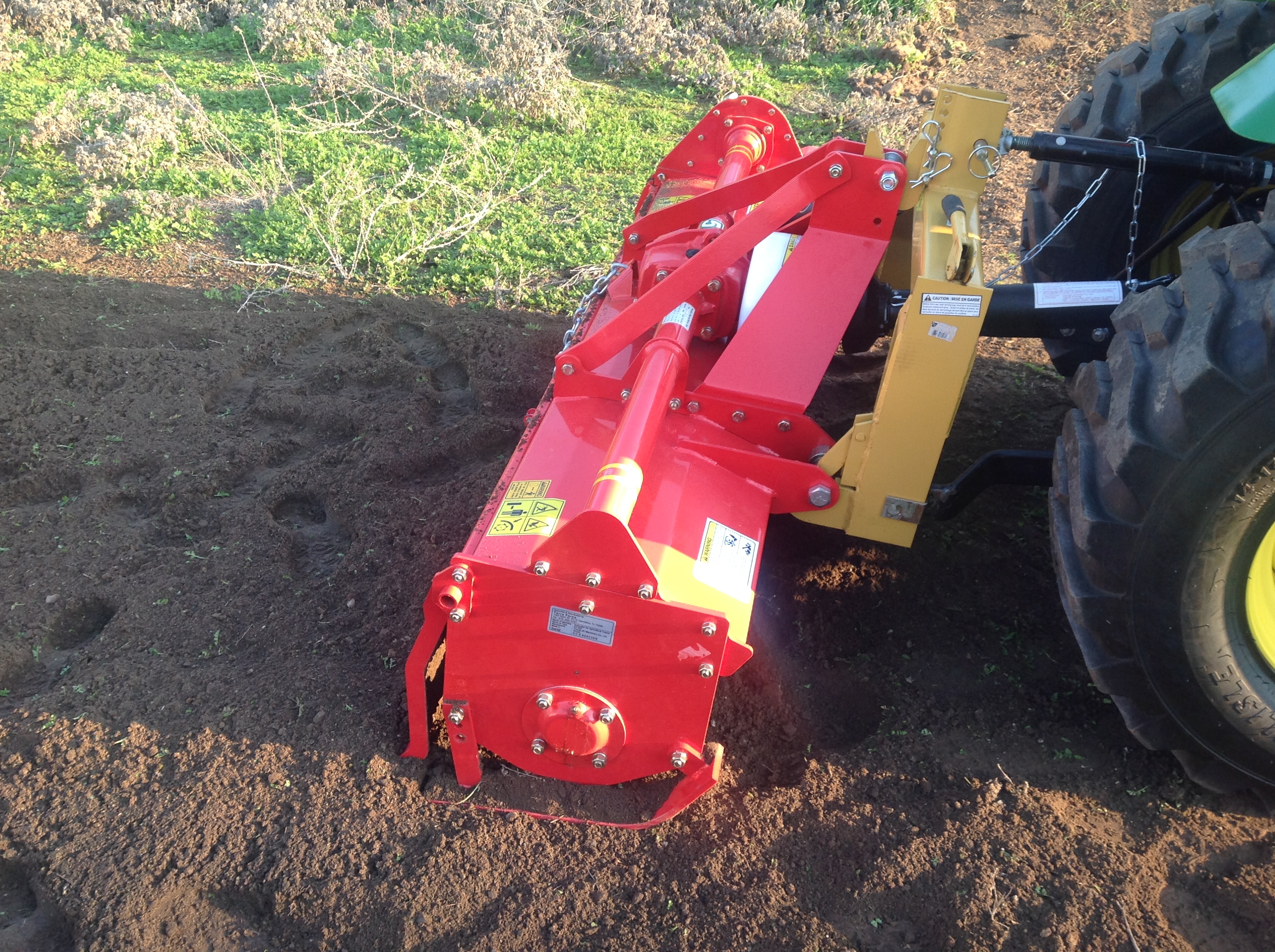

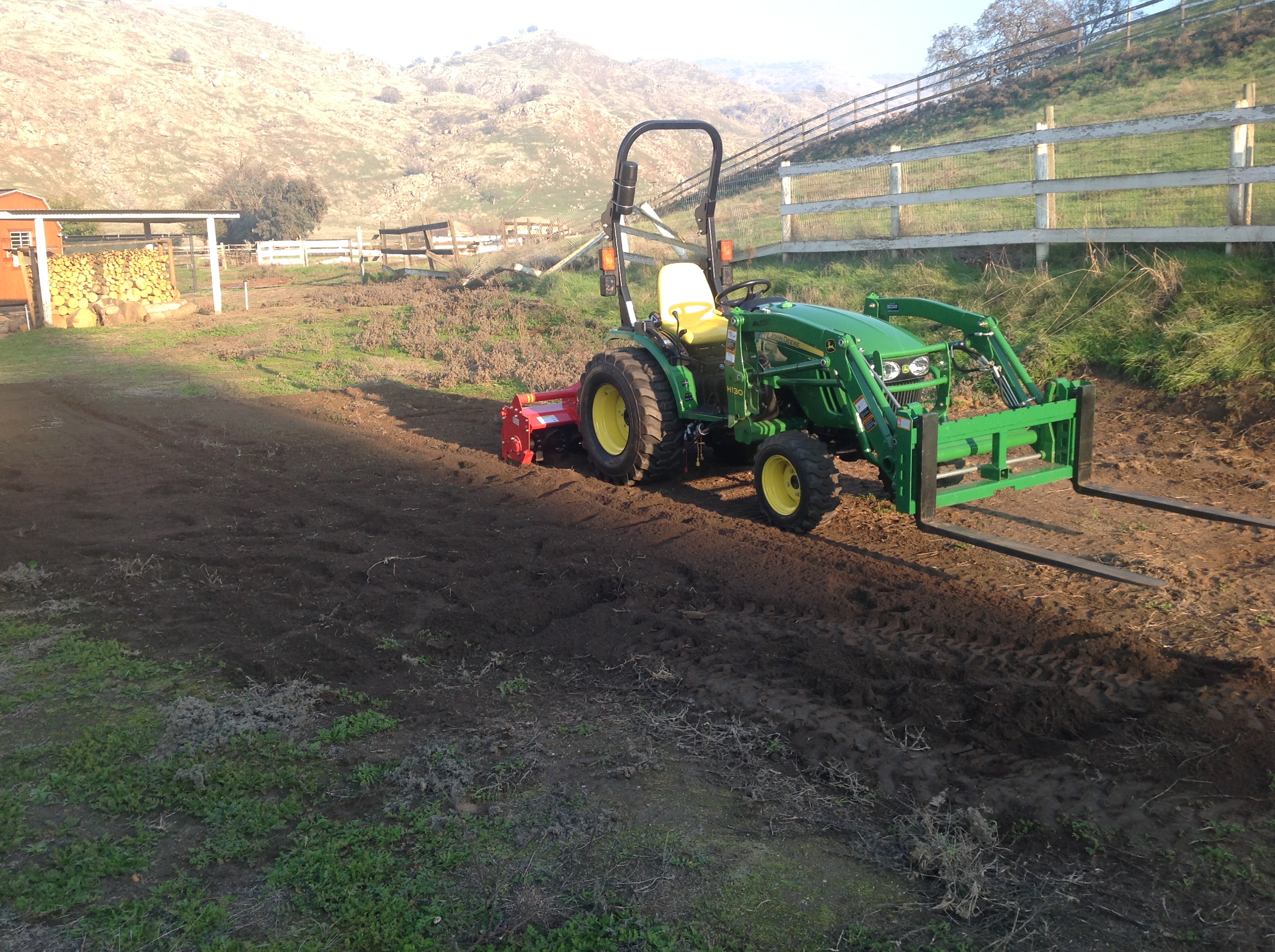

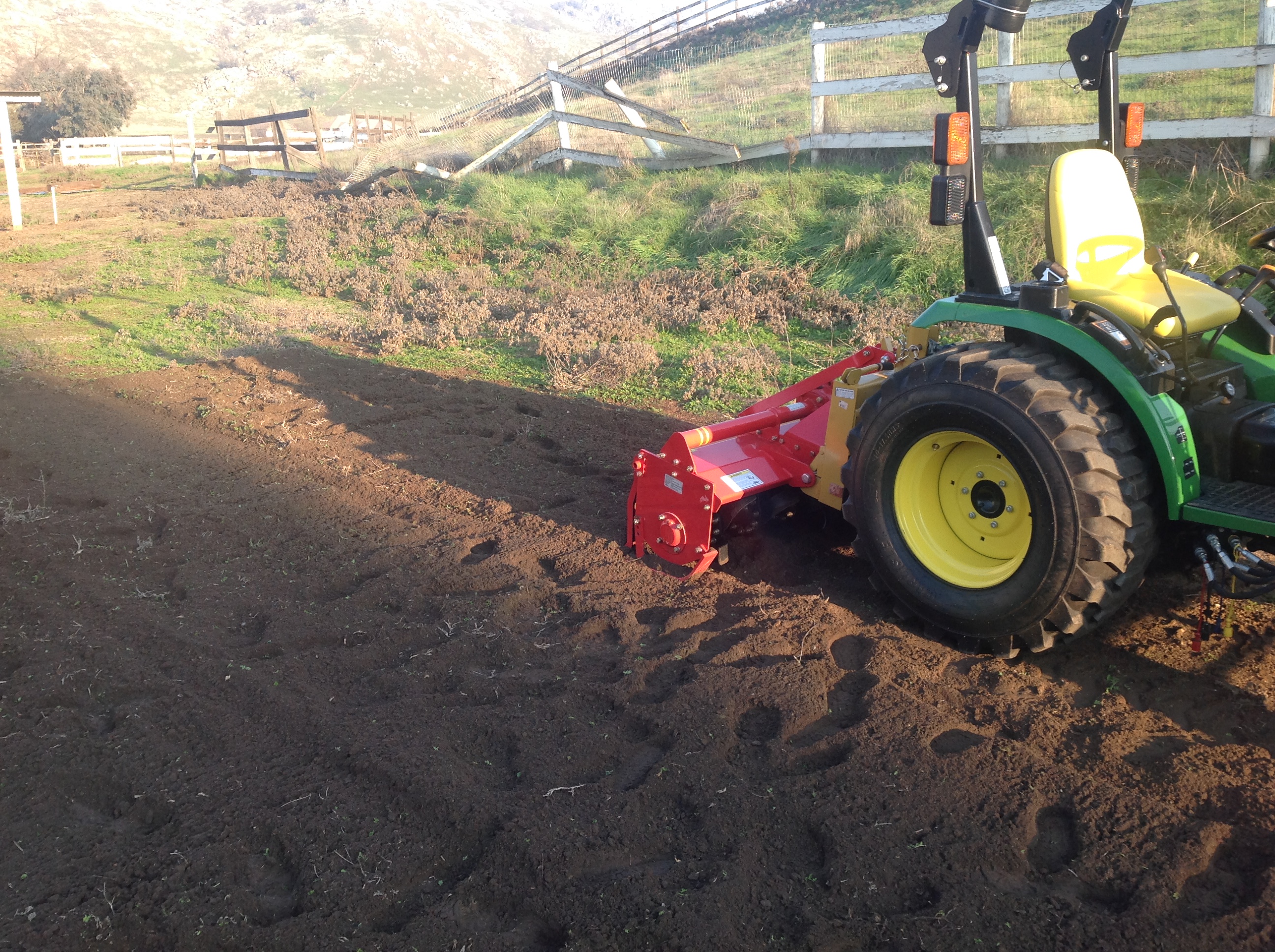

After buying a countyline quick hitch I finally got a chance to get everything hooked up and was able to use the tiller a little bit today, the dirt on my property is very soft so the tiller ran pretty smooth.
   / WARNING ! Ansung misrepresenting #89
I dont know - the rest of us are working on tire chains and plowing snow. I'm a little jealous:D of you staying warm.:D:laughing::thumbsup: I did notice in the last picture you have the skids on the highest setting. If I may suggest, put them on the lowest and use the 3pt for depth control. Then you will really know how it works,
Happy Tilling and Merry Christmas
#90
I'm just using it for weed control right now, really don't have time for a garden, just to busy. But I do plan on using it for a garden so thanks for the info on setting the depth. Why does your tiller have springs that hold the back plate down and mine does not.
Oh and by the way You have snow because Santa has a sleigh, Merry Christmas to you to.:grinch:
