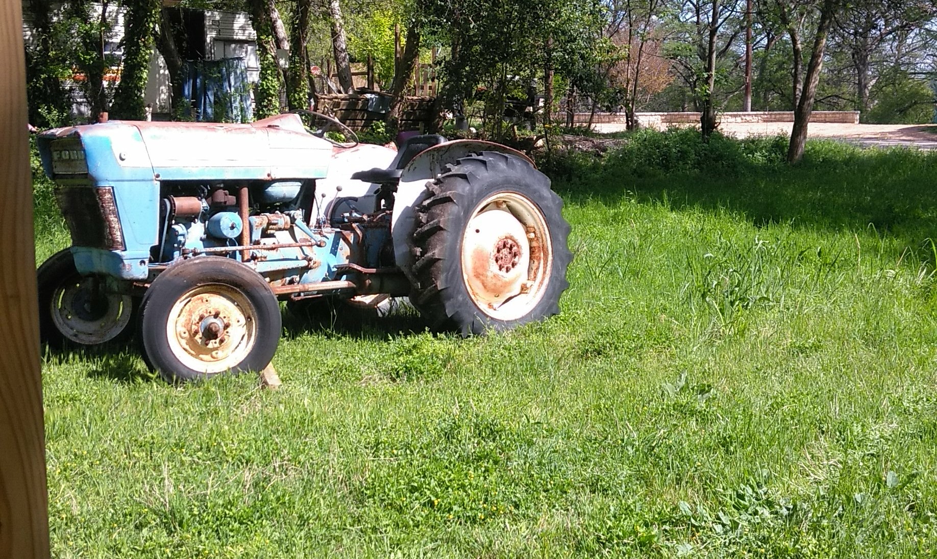

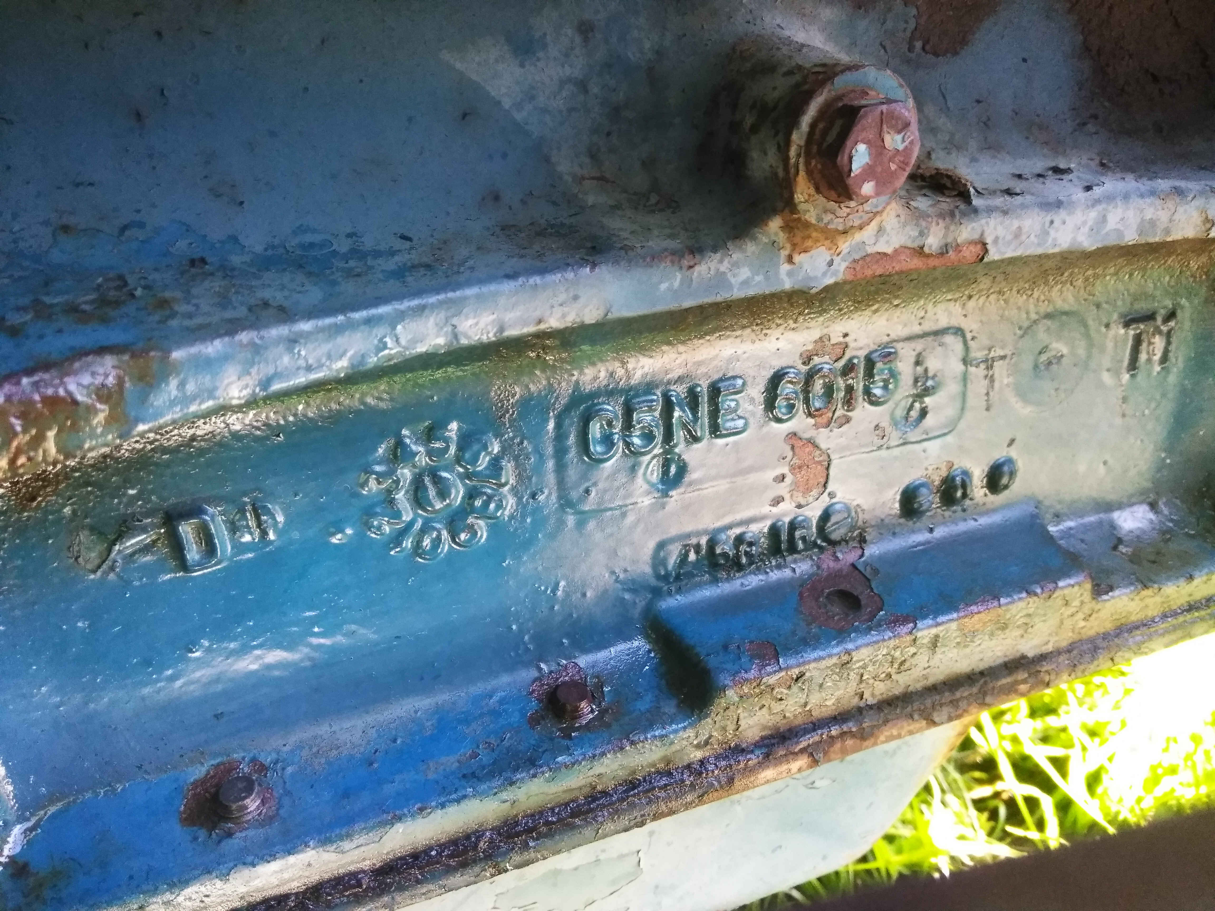

Hey yall I was given a free Ford 3000 (or so the stickers say) it has been sitting for 18yrs + or - a year or two seeing if anyone can give me a hand with making an id on it. I took pictures of all the numbers i could find on said tractor. let me know if more pics are needed will gladly take more tomorrow

The 3000 is a nice size to power ratio tractor.
From tractordata.com
What happened 18 +/- years ago that turned it into a lawn ornament?
/ Was Free
I am thinking it is a 2000 but not sure the area where the serial number that i found does not look anything like those listed in the pic from tractor data.
i was told the tractor was started and the person went to grab their morning coffee from the shop and when said person returned it had stopped running when checked there was no oil on the stick so possible locked it self up not sure if this tractor would have a sensor like some of the newer engines to shut down when low on oil however i am currently going to school to become a diesel mechanic and work at a shop with several and already have one willing to help me out with the rebuild.
/ Was Free #4
This may help. The third picture looks like the serial number described. If so it was made in the UK.
Ford 2 & 3 Tractors
