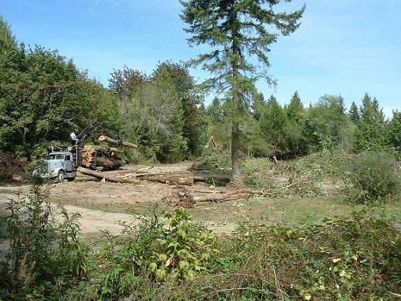

Yep, the loggers made quick work of the big treees, stumps, and burnt all my piled slash along with theirs. I really had a nice experience with the logger mostly because I knew what to expect and he didn't cheat me or trash my land. What he left I was able to smooth out with the boxblade. The 15 CY pile of junk in the middle is the muddy roots I raked out with the rippers. I never really got in there for a smoothing pass as winter arrived too soon.
The plan is to build ASAP and be in by Xmas. I have verbally hired a builder that builds the house only and am now getting quotes for the other stuff to finish out my construction loan. It's gonna be cool. The house will have a 3 car garage and 2400 SF compared to my 1350 + 2 car garage on .3 acres now. The addition of 2 little girls in the last few years has made my 1350 SF feel pretty small.
I met the power company guy on Friday and will get his quote this week. The 600' primary line at 7200 volts will hit a transformer about 170 feet of the house. Everything for about 10k$.
The wetland guy needs to come out and certify that there are no wetlands within 315 feet of the house or post the signs at the buffer if there are. Great time of year for that eh?
Then the only unknown is the remodel permit for my septic. I will reuse the old system already onsite but I need to pump about 700' therough the grass valley to the old septic tank on the next ridge which I dug up and it looks real good. So I need to price out grinder/ejector pumps.
The goofy county requires a site plan with 2 foot contours. That's great if you want to build on a 1/4 acre lot but 15 acres? That stinks. I'll be taking the level home from work I guess.
It's starting to get stressful now. I spent yesterday cleaning the tractor, even tire foam on the R4s.

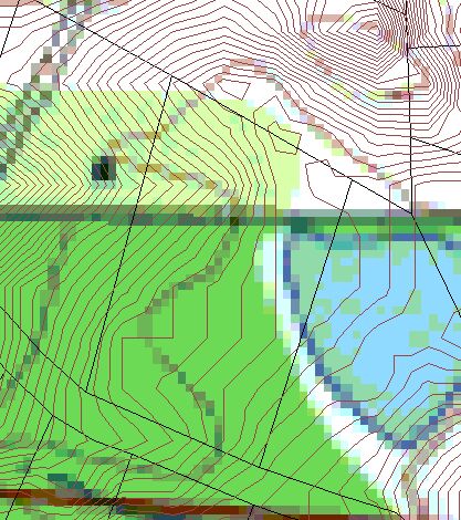

Just as an example of what I eluded to before, here's a screenshot from ArcView showing my lot. The (very pixelated) background is a scanned quad sheet with 20' contours. The 2' contours were generated from a downloaded DEM (digital elevation model) from USGS. As you can see, the old quad sheet only has one contour running thru my lot and practically no indication of the creek topography at my NE corner but, the generated 2'ers show what the ground actually looks like. Plenty good enough for building permit or landscape purposes and only about 10 min worth of time.

You bet that's good enough. I tried the USGS site but was less than impressed. Is the downloaded 2' contour map easily found and free? Drat, I'll look again, that would be great.

Sorry I led you so far astray. USGS does not have any 2' contour maps to download. I created my 2' contour map from a DEM (Digital Elevation Model) that I downloaded from USGS using GIS software called ArcView. A DEM, is only a cell-based dataset, like a raster image, where the "cell" measures 30m square (for 1:24000 mapping), on the ground (read:100' grid) and carries a value attached to each cell that is the elevation. From that raw dataset contours or aspect ratio, etc can be generated via software. It's been a couple of years since I needed to download any DEM's so I don't know if your area has been digitized by USGS yet as it was a work in progress when I last checked. Feel free to PM me if I can be of any further help in this matter.
