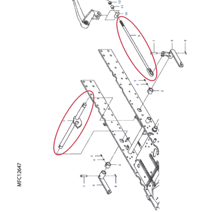

An Agco rep confirmed the deck height update was put into production a long time ago, he didnt specify when. But serial numbers higher than what are listed below have the update.
MFGC1705 MGC050GJH70502
MFGC1710 MGC100GJH81003
MFGC1715 MGC150GJH90501
MFGC1720 MGC200GJH00502
For older machines the new link rod part number is 7073002M91 and new lift shaft part number is 6259773M92

Tony, what's up! Yeh, that's a great vid man, thx again.
I just got off the phone with part dept at the closest MF dealer.
Ok guys, well lemme tell ya, if you wanna fix the deck drop, you could:
A) Do it Tony's way, or...
B) Get your parts from the dealer, which entails getting a new link rod ($22) and link shaft ($206)!
