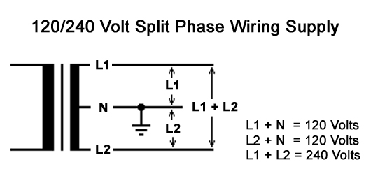

You are reading my post incorrectly. On the line coming into a house you have 2 Hot wires (L1 and L2 in the diagram below), a Neutral (N in the diagram below) and a Ground (represented as a downward pointing segmented arrow in the diagram below).
L1 to L2 is 240V
L1 OR L2 to N is 120V as the neutral splits the difference between the two sides of the 240V wires (hence the term "split phase", it splits the single phase in half).
Here is a diagram showing that from RVTech:
559586d1529675725-water-electric-5th-wheel-splitphase-jpg
Source: Electrical Tutorial - Chapter 3 - 3 Amp versus 5 Amp
Note that the picture above shows the feed up to the main breaker, after that the Ground and the Neutral are separated.

A 30 amp RV plug is 30 amps of 120V (from one L1 or L2 to N), it has a Hot, a Neutral and a Ground.
A 50 amp RV plug is 50 amps of 240V (from L1 to L2), it has 2 Hots (L1 & L2), a Neutral (N) and a Ground (G). Because it is a 4 wire plug, you also get 120V when you go from L1 to N.
As a result, you can get 100 amps of 120V out of a 50 amp 4 wire plug.
In line with what Groo said, with a 50A 4 wire 240V connection, if you put 30 amps on L1 and 20 on L2 (for a total of 50 amps), the Neutral (N) is only carrying 10 amps as the L1 and L2 balance each other out, when L1 is at +120V (compared to N), the L2 is at -120V (compared to N) and they swap places 60 time per second (in the US and most of Canada).
If you want to test this, test the plug with a multimeter as shown in the video that justinramani linked to: Multi-Meter Test 5 Amps - YouTube Start at about 2:00 for him showing 240V at a 50 amp receptacle.

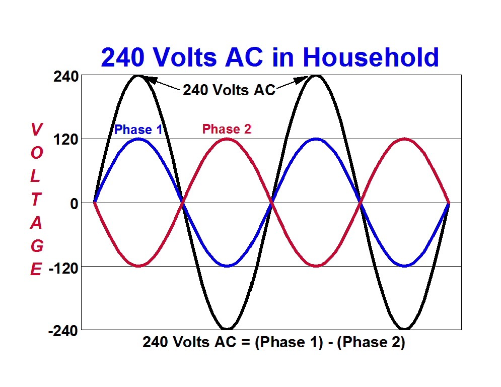

large.57581ad8d9a5d_240VACinResidentialPowerSupplies.png.f176ab25d2092125b3d05d648597b1f8.png
   / Water and electric to 5th wheel #39
its incorrect because I believe the 120/240 is a RMS measurement, so actual is probably more like 140/280??? as a wild guess.
the black line is just the blue - red. that represents what the motor or whatever will see when wired 240/
a better drawing might be just the blue, with area between the blue line and the zero filled, the the the red with the same, then another with the red and blue "lemons" filled to show the increased area/voltage produced.
   / Water and electric to 5th wheel #40
The difference between -120 volts and +120 volts is 240 volts. The black line represents one leg of a 480 volt supply.
