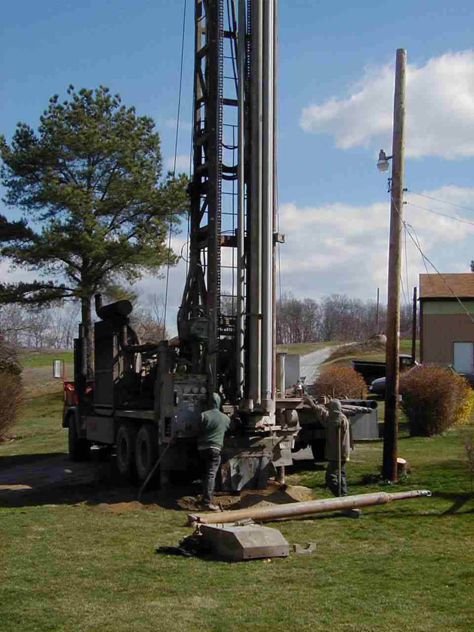

The new well we put in at the farm two years ago went 130 feet with 50 feet of solid casing and 80 feet beyond that of a silt screen casing. Around here they call this a screened well. Once they got throught the rock at 50 feet, they hit loose gravel around 70 feet. Pleanty of water though. So they ended up putting in the silt screen casing and backfill with peagravel. Then they grout the upper casing. The screening added $2300 to the price of the well, but after paying for a 450 foot dry hole, I didn't want to take a chance. That was during the drought we had and they pumped at 20 GPM with no problem.
Attached are pics.

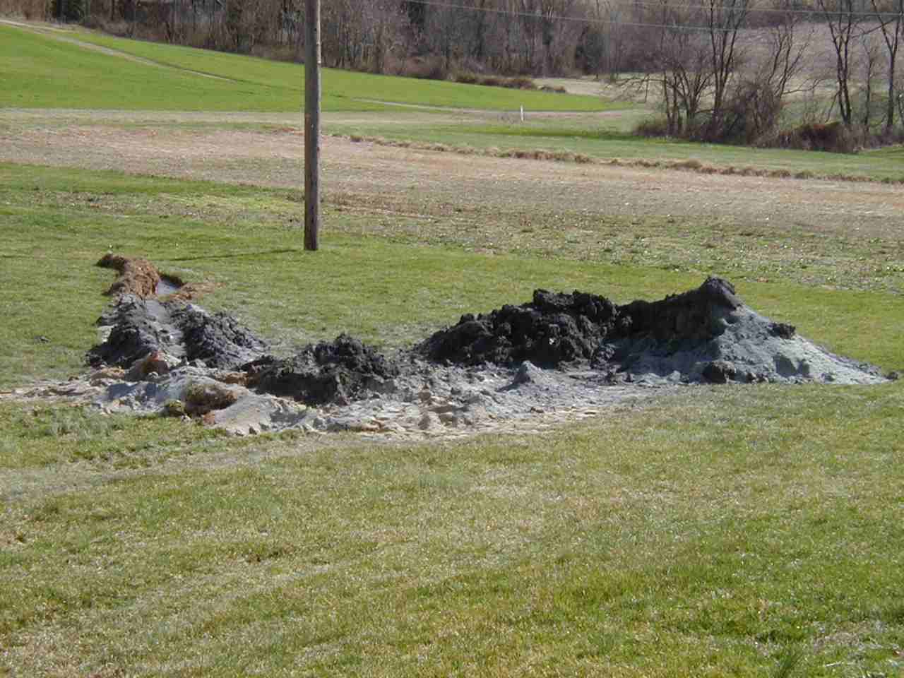

   / Water filter and lightening strike!!!! #17
pic of the site of the 450' dry hole. cost me $1950.00.

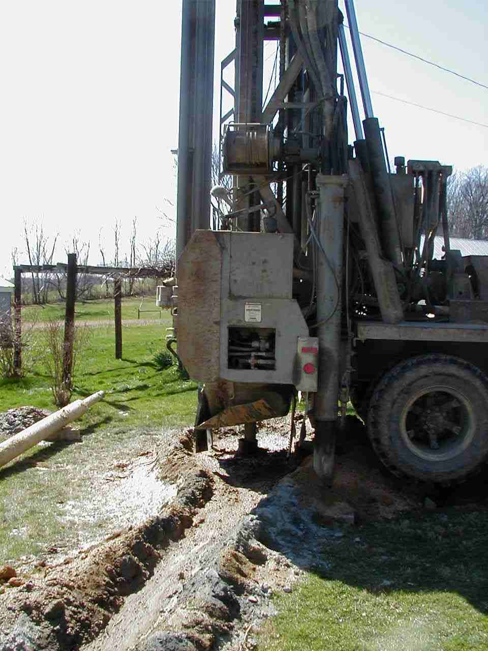

   / Water filter and lightening strike!!!! #18
Another view of the rig in operation. very loud!
