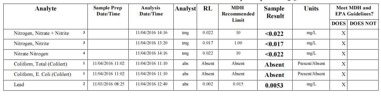

Sold my home and should be closing on my new property in a couple of weeks. Had a water test done but it does not say what the hardness of the water is.
Just wondering if this is a separate test or can it be determined from the supplied information?
Here is a snipe of the water test results;

That is a basic well test. They are looking for safety issues with your well water - bacterial or chemical contamination (nitrates generally related to runoff from farm fertilizer, for example - often a problem in farm country where the water table is close to the surface). You'll notice the last 2 columns talking about "EPA" requirements. Hardness testing is done separately. Our softener guy did it. Very honest decent guy. No question ours was seriously hard (not a surprise around here), but he said no iron, so that was good. Like others said, you may get a line of BS from some. If you can find someone you trust, then you should be good with them. Otherwise maybe just get your own test like S219 pointed you to.

What dstig1 said. There are basically two tests for water. Bacterial quality - yours indicates its acceptable and chemical quality - yours only had nitrates/nitrites run. Nitrates/nitrites is a test to see if agricultural fertilizer is in your water. Your water is acceptable for that also.
There is a whole flock of chemical tests that can be run - which are normally not done on a "standard" sample. Iron, calcium, fluoride, magnesium etc, etc. A "standard" chemical test can be quite expensive if it includes most chemical compounds that might be present in the water in your area.
