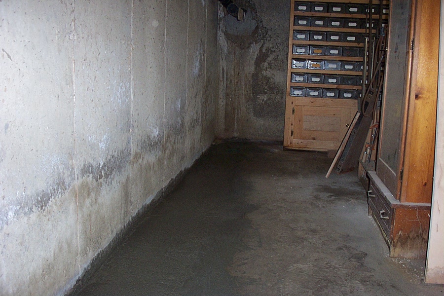

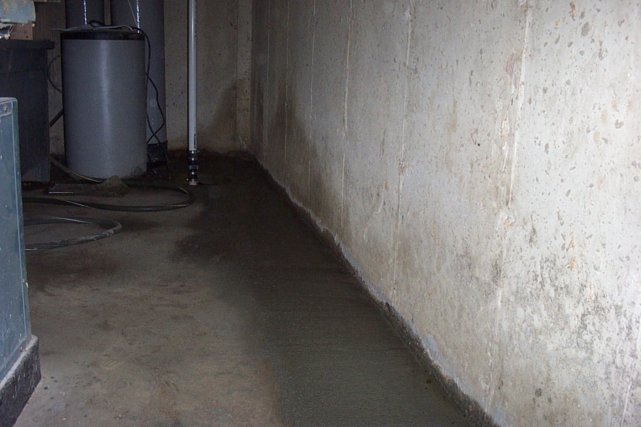

Scotty,
As far as the type of material for capping the trench, we just use the premix concrete, Home Depot and Lowe's both have what they call high strength or 5000 psi made by sakrete or quickcrete, we buy the 80 lb bags and mix 2 bags at a time in a contractor size wheelbarrow.
Like Eric mentioned, sometimes the stone can make it a pain to finish, especially the high strength stuff I'm recommending, but the trick is just make it a little wetter to the point where it will pour out of a pail, not just plop out in clumps (don't make soup though), then if your having trouble finishing it with the trowel don't be afraid to splash more water on it, makes it alot easier.
I use a large steel brick trowel on trench's up to 10-12 inches wide and a mag float on wider areas, agitate the mix aggressively as your leveling it out, this will help prevent shrinkage. Keep up the good work, your almost there!!! JB,

Mornin John,
Is there any special plastic I shold be using to cap the stone ? And I believe you stated earlier that I only need to make the replacement floor 2" thick, is that correct ?
Oh yes one more question, would you like to take a quess on how many 80 lb bags I need to cover a 31' trench 16" wide by 2" deep ? :)
BTW after all that rain yesterday, and we had a bunch, no puddles, ahhhh ..... :D
Thanks again !

Scotty,
It doesn't matter about the plastic, anything to keep the wet, freshly mixed concrete out. 2 inches is good for the cap, you can go a little thicker if you want since your footing is low enough, just don't place the concrete directly on the footing, you need a layer of stone to "bridge" the footing.
As far as how many bags, when I guessed, I came up with 15 bags. when I figured it on paper, using your dimensions, it comes to 10.7 bags. I never figure that closely cause for us it's better to have several extras on the truck than come up 1 short late in the day when we're trying to finish a job.

Good Afternoon Guys,
The " Pouring of the Concrete" is done, 10 bags =
:D :D :D :D :D :D :D :D :D :D !!!
Other than a little outside pvc plumbing and some cleanup we are done, Amen !!!
Its raining out and I have a DRY basement ! Very satisfying if I dont say so myself ! ;) :) Once again thanks for all the pointers, from the posters on this thread ! :)
