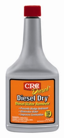

Hey...brand new BX25D here...no problems with it but filled the tank today and was thinking of other things and left the cap off for a few hours...yup, you guessed it...rain shower came along.
Anyone know what I can put in there to absorb the water? Not sure if dry gas would hurt diesel?
Tank was full and the shower wasn't a downpour or anything but it did rain for a while.

Went to my local hardware store and was surprised to find a few "drygas" products for diesel...bought some of this and a fuel conditioner for continued use year round.
Thanks for the suggestions! I'll report if any problems ongoing.
