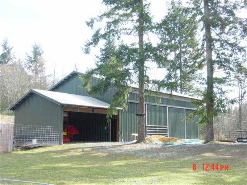

You have got a nice shop, well kept!:thumbsup::thumbsup::thumbsup:

Thanks for the comments on my shop, I wish I could convince my wife to keep the house as clean as I keep my shop! Please don't tell her I said that! :eek:
