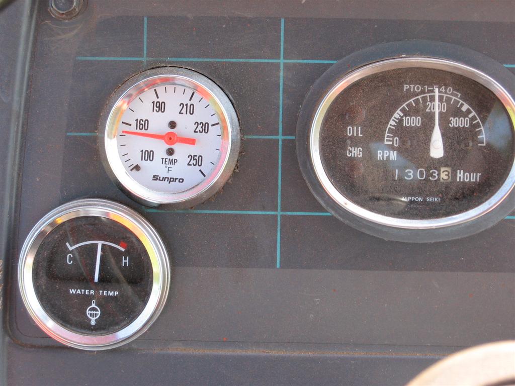

Yep, after to much money, a valve job (needed afer I pulled the head), and time (which is free). I'm done. End the end I think it was a bad "new" thermostat. The mech gauge is the proof.
Rob
