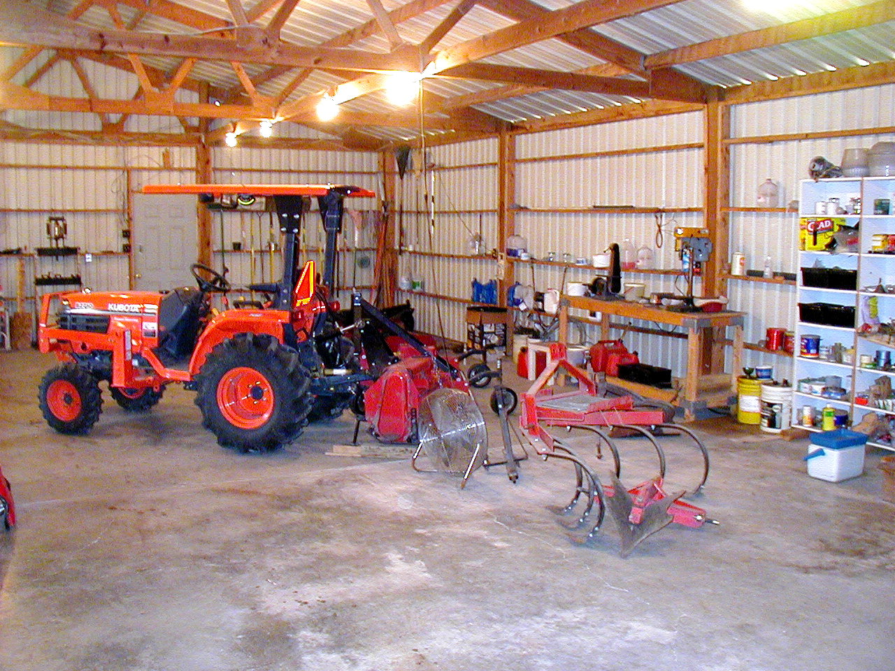

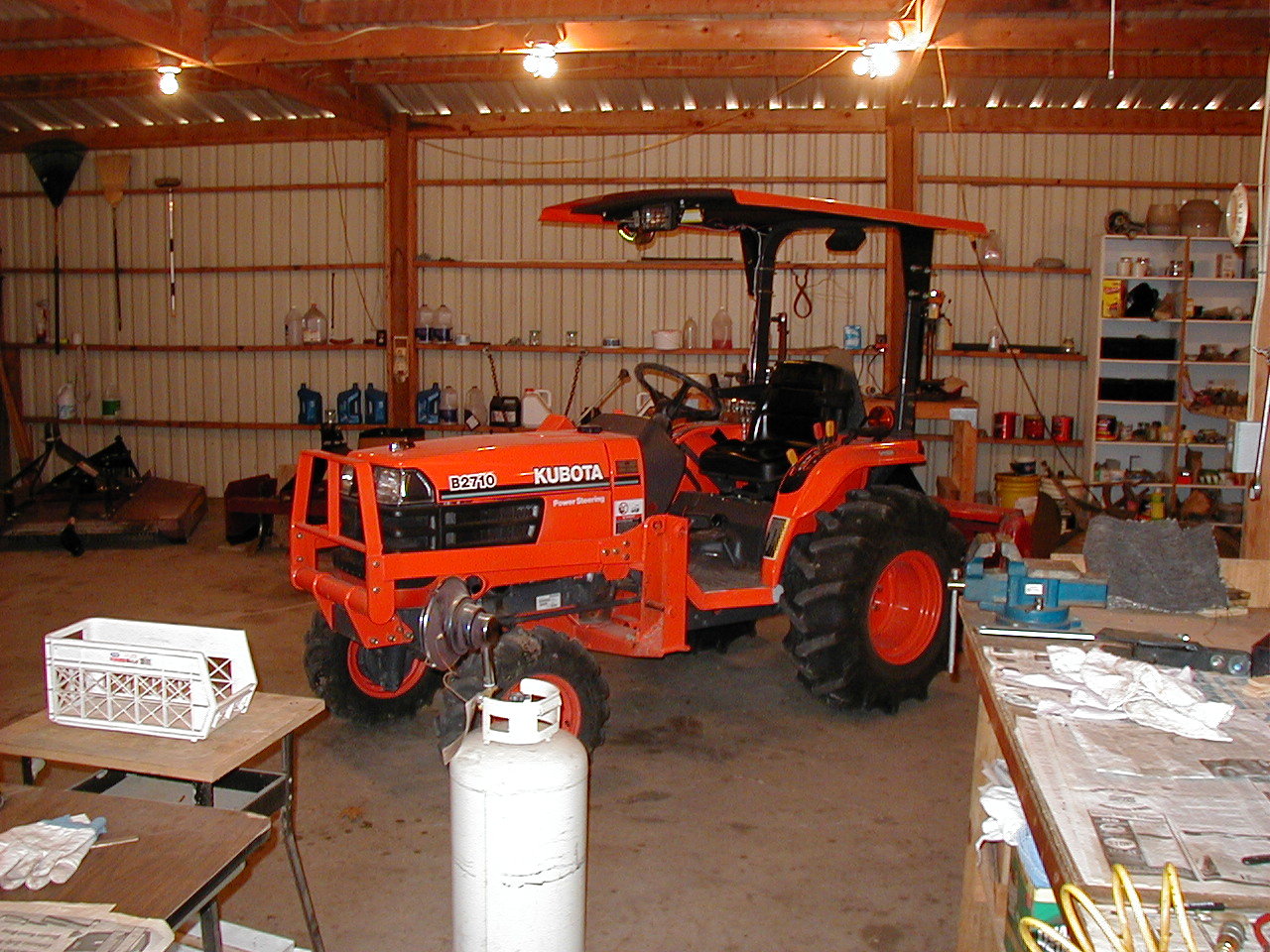

Personally, I put water and antifreeze in the rear tires of my B2710 and it was always parked inside the shop on a concrete floor and yet one morning I went out and found the tractor sitting in a puddle and thought at first I had a bad leak, but then finally found it was just the tires "sweating". It really startled me. I didn't make any pictures that day, but you can see where it was parked.
