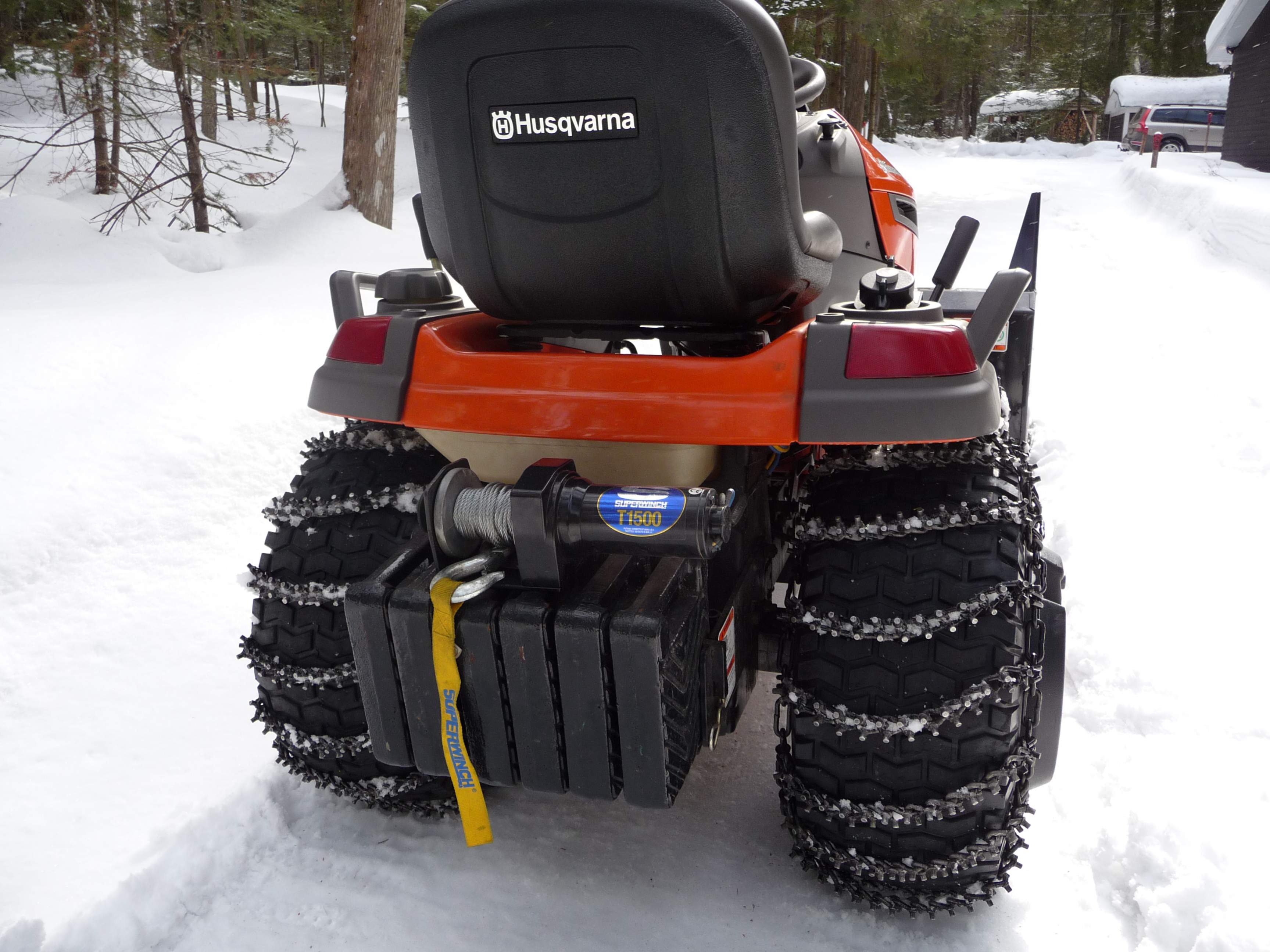

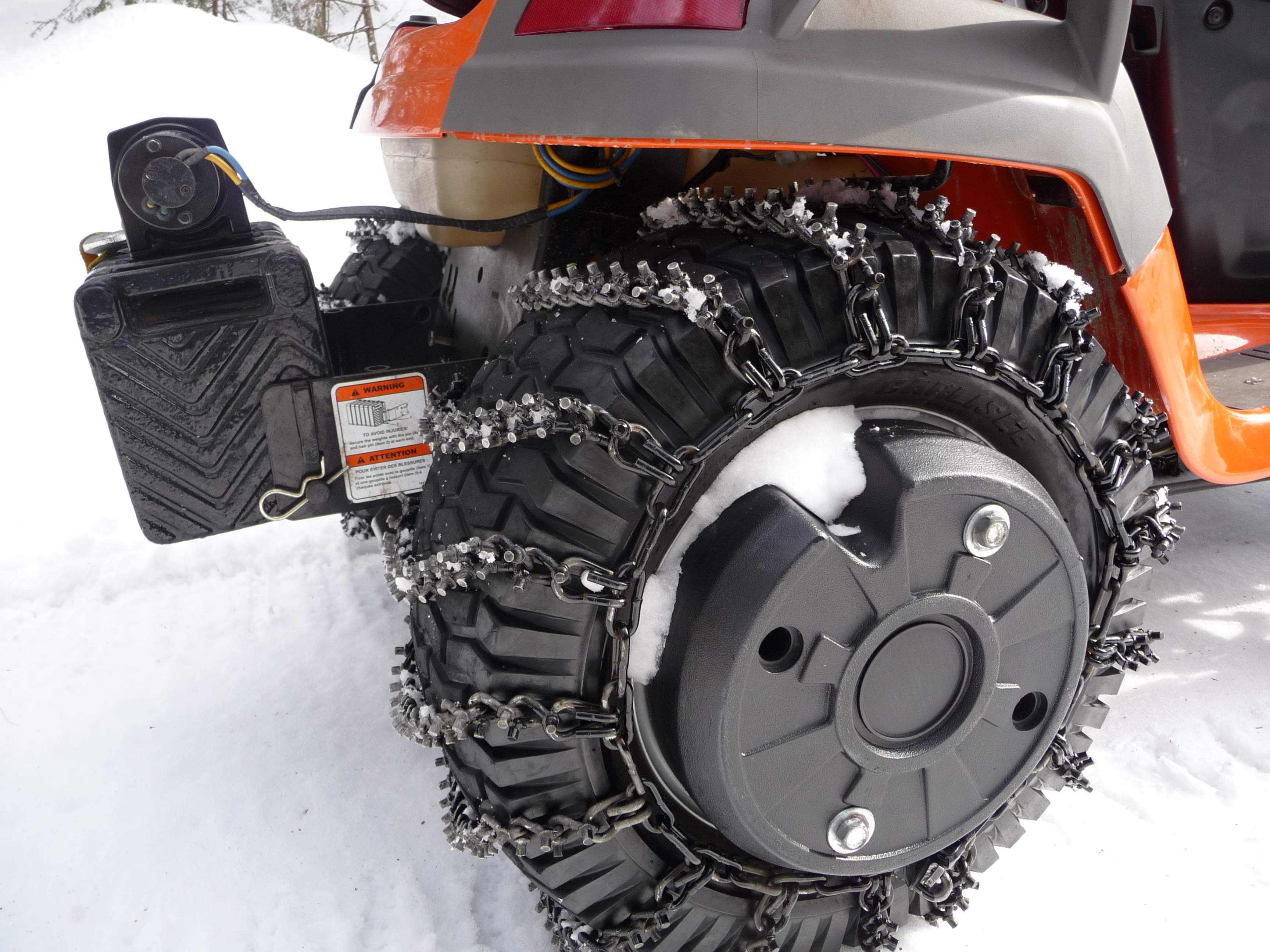

If I remember correctly it's close to 200lbs rear weight plus wheel weight. No more tipping during summer time and a lot of traction for snow removal. Plus the added benefit of peace of mind when you have a flat tire. A loaded tire that goes sour is by no mean fun to change :confused2: ...

My weights look the same as in your picture; mine are 50# each. Interestingly, Husqvarna no longer lists the 26 hp - apparently it's now rated for 24 hp. Same mower/tractor. Maybe the true hp is coming to light? And... I can find nowhere how much it actually weighs, without attachments. Anyone know? Just curious.
