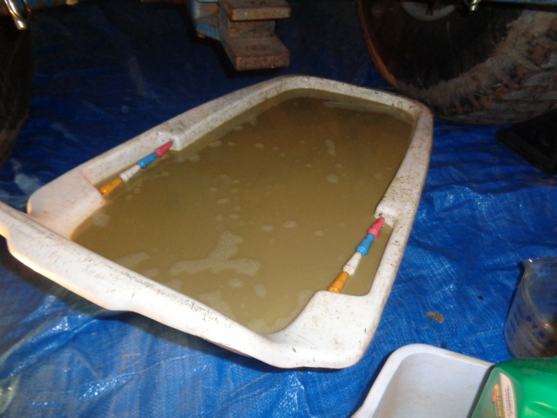

I have a New Holand TC33 Hydro ,I'm getting a LOT of water in the reservoir !!! has anyone else had this problem????
The machine sits outside, I even keep a tarp over the rear end /seat area , But still getting a lot of water , can't find any area that doesn't look sealed on the top side.
i did a FULL service 8 months ago and the oil looked like heavy milk when it was dained over the week end
Thanks for any help i can get!!
Chuck

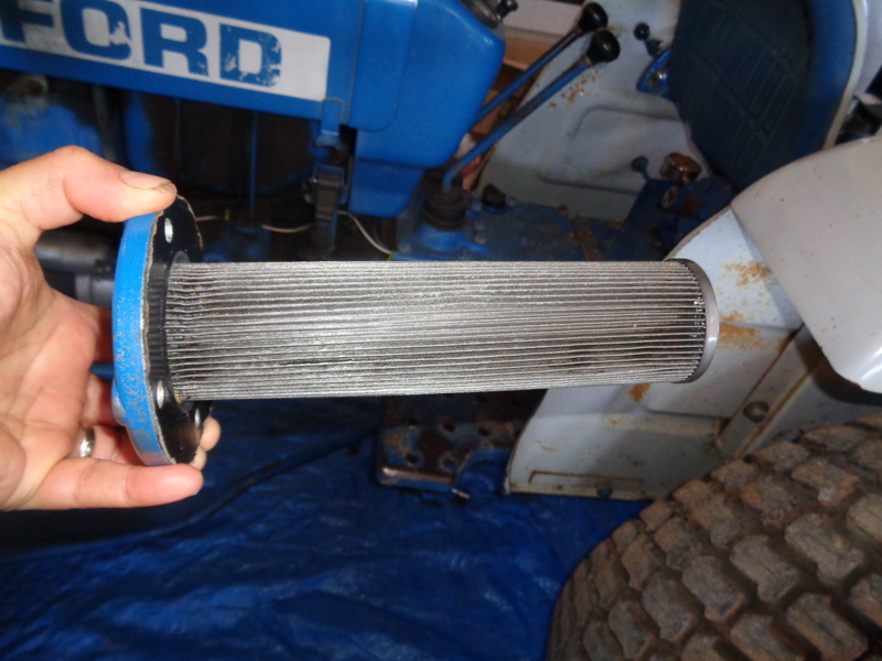

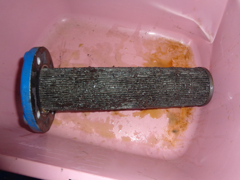

Chuck for comparison sake look at the pics attached. I have changed complete hyd fluid/transmission 10 years ago. 8 years the tractor was stored in a barn, last two years basically outdoor in my backyard while I was working on my new house. I had it covered it with a tarp for the last two years. Important point is also that my tractor is not heavily used tractor and things don't get hot and stay hot. I put about 300 hrs in 10 years. I had a bit of issue during the hunting season as the moisture partially froze the hyd fluid and 3 point did not work well. Any how, make the long story short, the oil looked bad but after changing about 6 gallons of hyd fluid the lift is working just it used to with no ill effect. I also think qulity of oil is a lot more important in your Hydro tractor. I do have a vent on top of the diffy with to keep it hyd reservoir and transmission @ atmospheric pressure.
