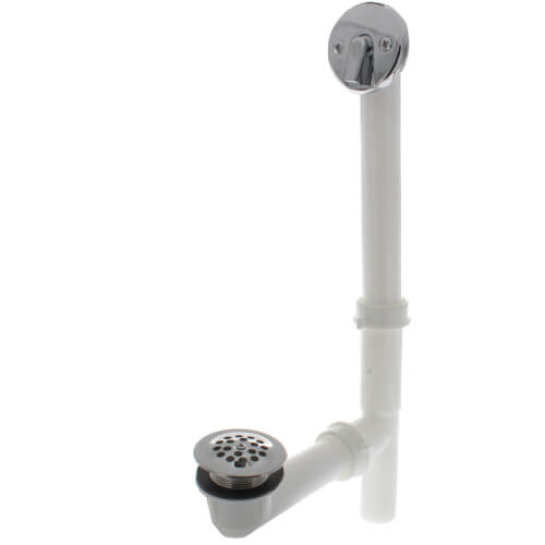

Apologies for (digitally) misspelling plumber jargon. Here's a conventional "trip-waste" for tub and and how the heat recovery setup works. Cost of the part can run hundreds .. plus in$tall if you don't DIY. Type of water heater doesn't matter. :thumbsup: on putting a coil of PEX in attic or crawl if a coil is 'stacked'/wound openly over a drain pan.
