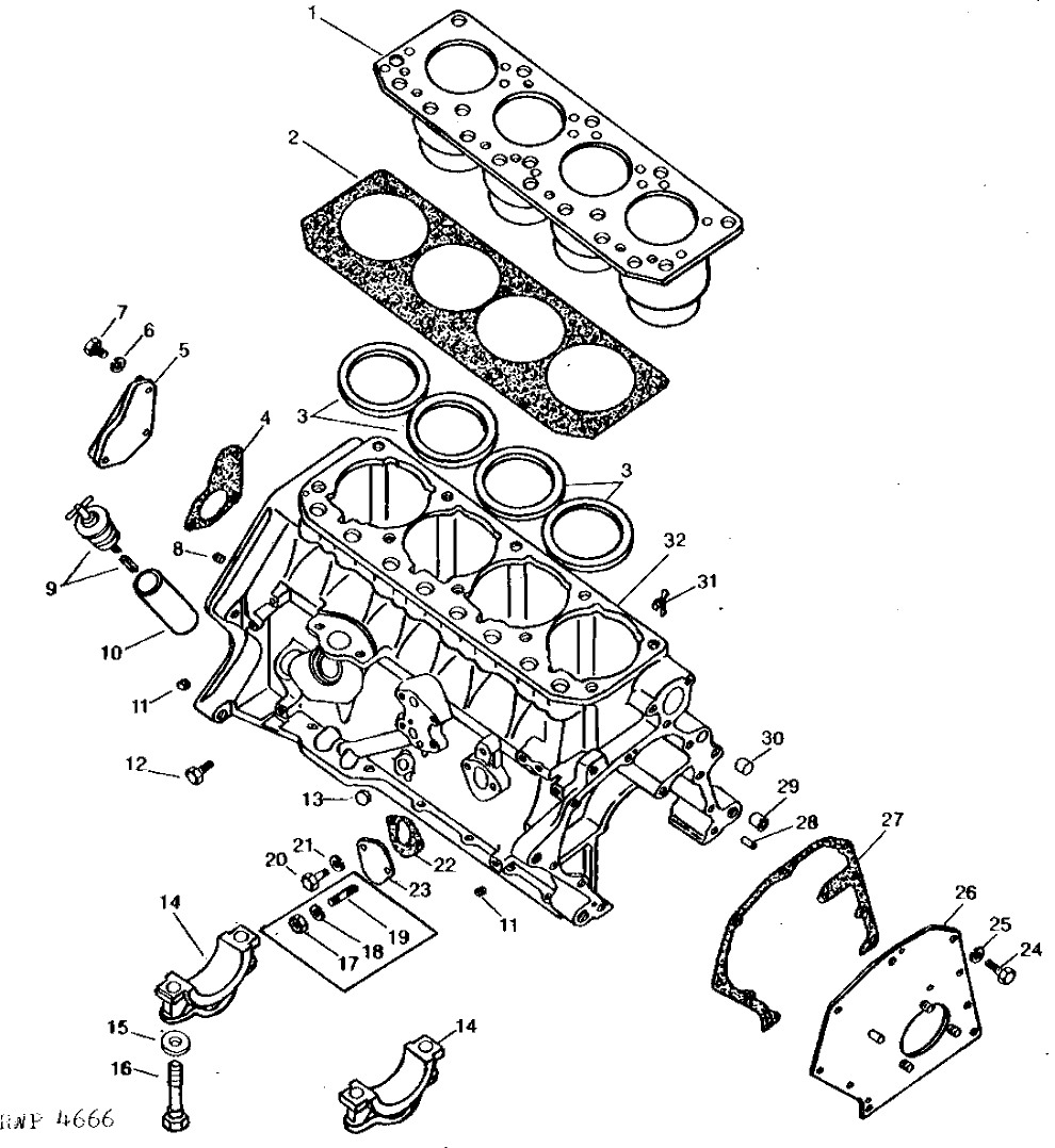

Sorry but I'm not a mechanic I don't understand what you're referring too, sleeve deck or both deck gasket and top gasket. Can you please tell someone that's not a mechanic what you are referring too......lol, Thank you for the information
Sleeve deck is parts key 1 & deck gasket is parts key 2

The Sleeve Deck and the Gasket can I replace those two items, or doesn't the Sleeve Deck just pull out and the new one set back into place. Does the head need to be machined down or does the engine block need to be machined (I made a living until I retired as a Electrical/Electronic person in Nuclear Power so I've been around very good machinist and I paid close attention) what I'm trying to say I know certain areas need to be resurfaced or resleeved, plus this is on a 1963 Diesel John Deere model 2010.
Not to insult you or your tractor. The 1010's diesel engine and the 2010's diesel engine plus the 2010 chassis are problematic and best stayed away from. Unless you have deep pockets and like a challenge.
It's going to require less time and money to cut your losses and find something better.
