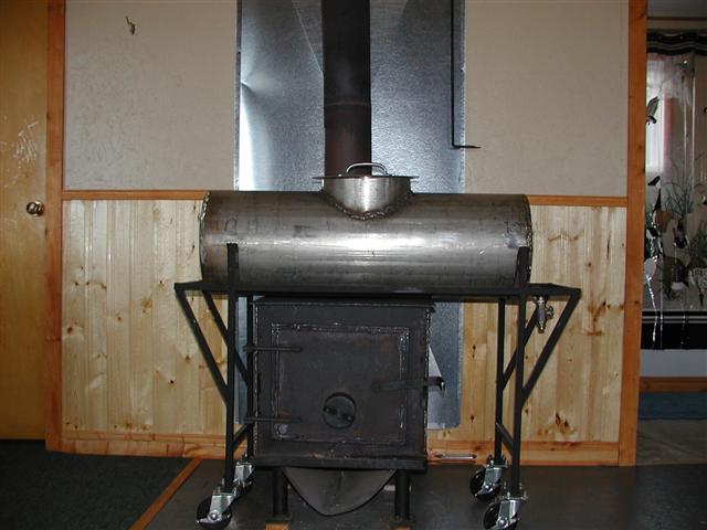

Not sure what you mean by a oil hydronic system but i have a thing made up for heating water with a wood stove is portable and hold about 15- 16 gallons.water in this you won't put your hand down in when heated up., is all stainless steel with valve on the side lays about 1/2" above the top of the stove.

I use it for washing and doing dishes when i am up to the cabin.
